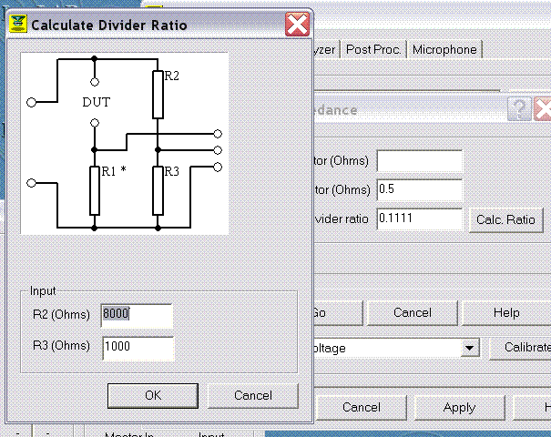

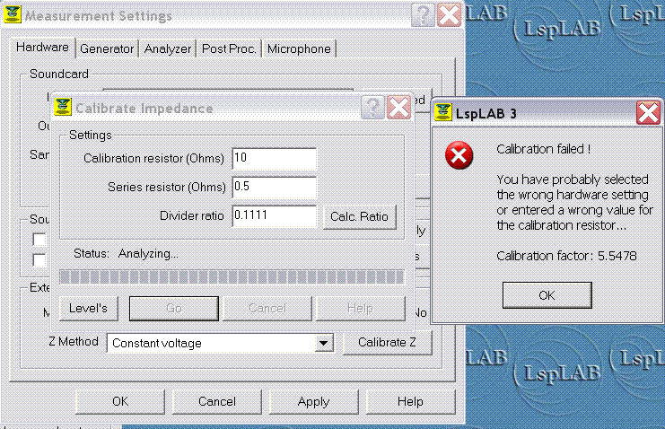

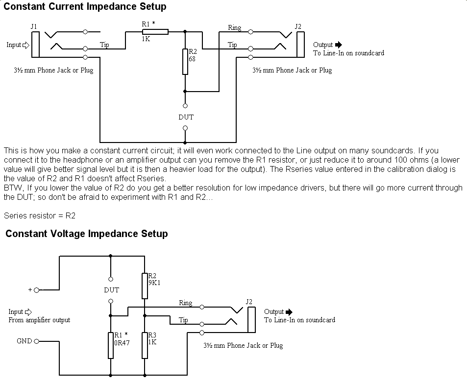

A Audist Member Joined 2004 2008-02-29 9:55 pm #1 2008-02-29 9:55 pm #1 Hello, I want to test my loudspeakers impedance. I use with LspLAB 3.01 software. I build the impedance wiring electric circuit and for the calibrate I use with resistor of 10 ohm in the “DUT”. Is not work!!! What I make not right? Thank you very much! Attachments 1111.gif 46.3 KB · Views: 181 A Audist Member Joined 2004 2008-02-29 9:56 pm #2 2008-02-29 9:56 pm #2 ... Attachments 2222.gif 25.2 KB · Views: 177 A Audist Member Joined 2004 2008-02-29 9:58 pm #3 2008-02-29 9:58 pm #3 .... Attachments 4444.gif 16.7 KB · Views: 153 A Audist Member Joined 2004 2008-02-29 9:59 pm #4 2008-02-29 9:59 pm #4 ..... Attachments 333.gif 25.6 KB · Views: 157 D djarchow Member Joined 2007 2008-03-01 3:43 am #5 2008-03-01 3:43 am #5 Are you sure you have it wired correctly? If so I would email Johny Grenender the developer of LspLab and ask him. info@wavecapture.com Status Not open for further replies. Share: Facebook X (Twitter) LinkedIn Reddit Pinterest Tumblr WhatsApp Email Link
