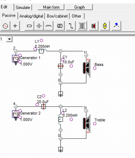

I don't understand Lspcad integration of Ts parameters into the crossover scheme.
How do I save driver parameters and integrate them in the example below?
Thanks!

Click on Simulate, then on driver and you can add FRD/ZMA.

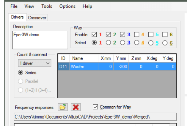

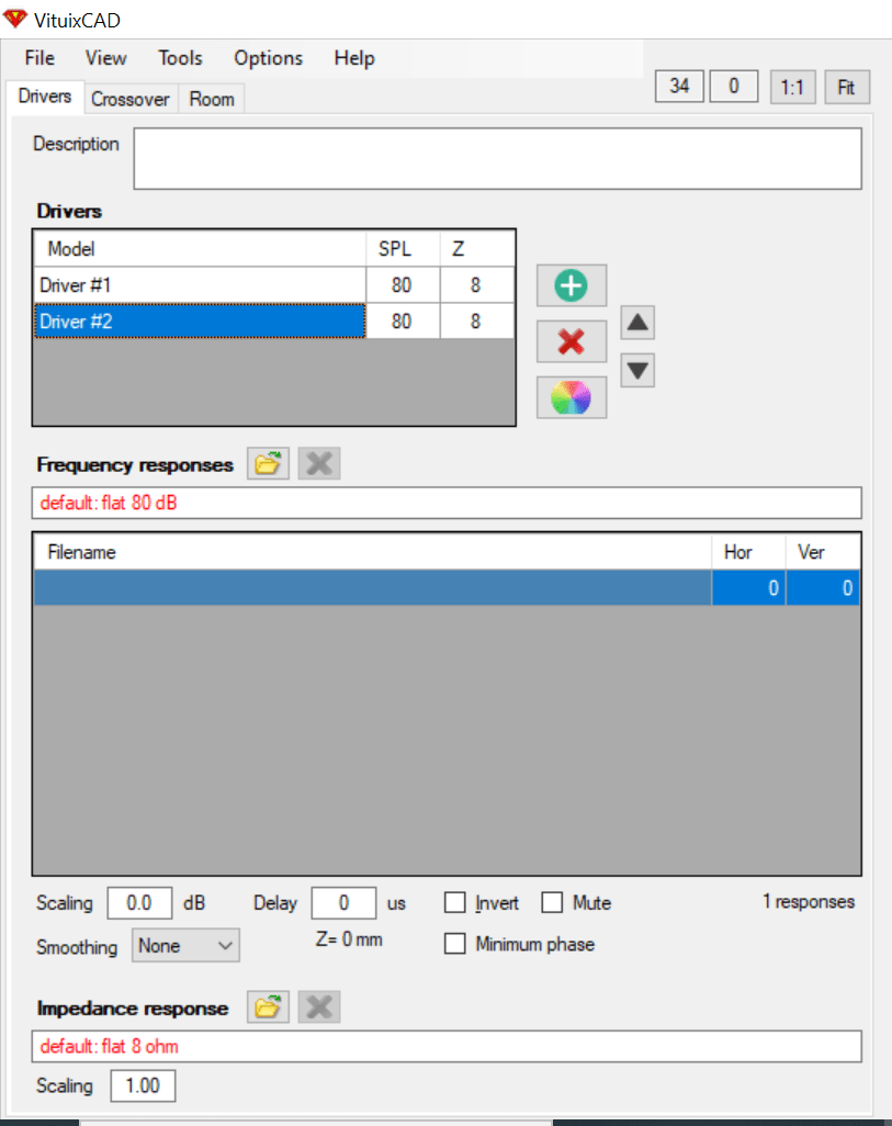

As for now I have this screen without the way tab. how to change that? Many thanks!
What I have:
What I'm after
Your 2nd picture is from V1.0, which was radically different.
V2.0 has no pre-set ways, you can set up the crossover any way you like, in the Crossover tab in your first screenshot.
