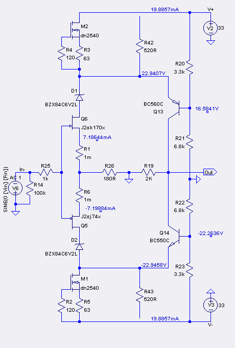

I have done some simulations and it looks like the circuit of post #66 can be scaled up to 40V P-P AC output. A CCS load using a DN2540 allows higher output swing without increasing the rail voltages and reduces H2 and H3 by about 3:2 at all frequencies and power levels. I have not built and measured this yet, but parts will be ordered. The zeners were added to reduce the max voltage and power dissipated in the JFETs, but might not be needed. Below is the circuit that I simulated:

Zeners are not needed - without them the Vds is 23V and it doesn't vary a lot. Almost all of the voltage swing happens at R19. JFETs will dissipate about 170mW each and that's OK, but 300mW for each BC5x0c might be on the edge.
Check the Vbe of Q13 - it's almost 6.5V instead of 700mV.
Try to raise the value of R26 and listen the difference (and R19 proportionally, to preserve the gain ratio) - you have the buffer at F4's input anyway...
Oops, the voltage measurement for Q13's base was at the wrong node. LTSpice renumbers unnamed nodes whenever something is changed. I need to explicitly name all nodes with voltage measurements.
I agree that the zeners are probably not needed. Without them I see a maximum voltage of 24.8V with 40V P-P output.
I also agree that I am pushing the limits on the power dissipation on the BC5x0C transistors. There are small heatsinks for TO-90 packages that might help. As you suggest, increasing R26 and R19 makes it possible to reduce the cascode current below 20ma, thus reducing the BC5x0C power dissipation.
The simulation distortion numbers look very good.

When I double the values of R26 and R19, to 4k and 360R, the distortion (from LTSpice) at high frequencies increases significantly. After further study, the 2sj74 in the F4 input buffer has fairly high Ciss and Crss capacitances of around 90pf and 30pf at Vds=-20V, and the 2sk170 has about 1/3 those capacitances. Looking at the JFET AC gate currents there is an obvious distortion component which is likely due to the bootstrapping of the JFET drains from the F4 output. Thus, it appears desirable that the folded cascode output impedance be as low as practical.

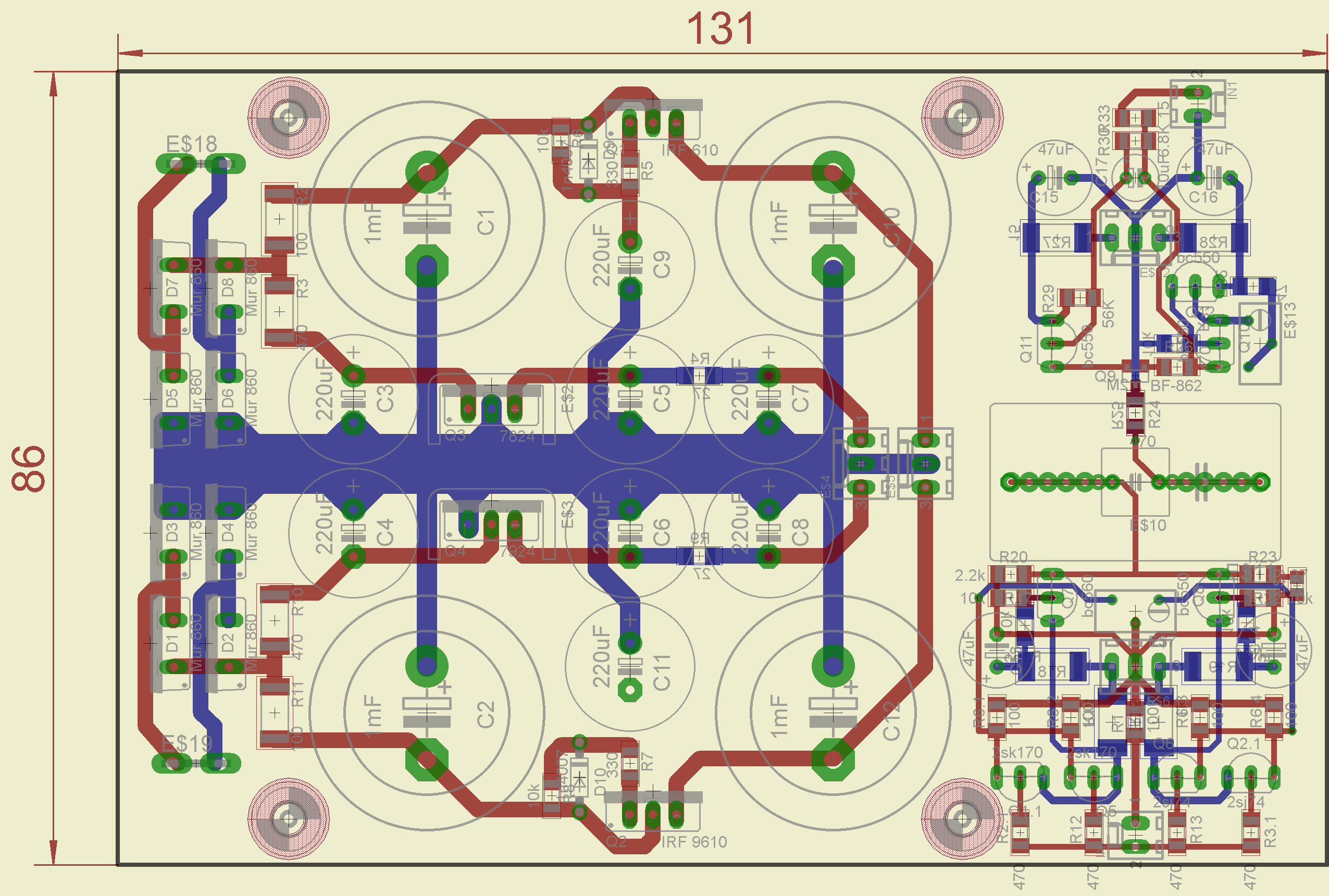

I am having some boards of the SMD version made if anyone is interested. It will include the PSU section on the same board and will be a dual mono setup. Here is the board file. Stereo pair should run about $30
