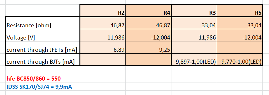

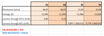

I've just build one channel of pre from #492.
I used SMD version of BJTs: BC850C/BC860C with hfe about 550 and trimmer 20 ohm between JFET sources.
I have an offset issue. I have turned the 20 ohm potentiometr P1 maximal to the left and received +0,7 V DC and can't decrease the offset more. I've measured P1 resistance on SJ74 source have 1,5 OHm and 19ohm on SK170 source.
The additional values I've measured:
Please advice what to do to minimize the offset.
Thanks and regards,
Hi Bern,
schematic in post 492 has no trimmer pot. You don't want it too. You got it matched all around. If you are sure that all your parts and connections are good, try to slightly vary the value of current mirror emitter resistors on one side (use 27R + 10R pot instead of 33 R) and see what you get... ;)
Hi Bern,
Thank you juma,
I have reviewed my circuit and found a mistake...
I connected the Q8 transistor incorrectly. After resoldering Q8 and change R3/R5 from 33 to 27 ohm everything seems to work correctly. I set 20ohm trimmer to 11,79/10,88 ohm and have offest below 0,1mV. With R3/R5=27 ohm I have current through BJTs 12,68 and 12,70mA (before LEDs) and current through JFETs 7,53 and 7,46mA. I look forward to completing the second channel and real music testing:)

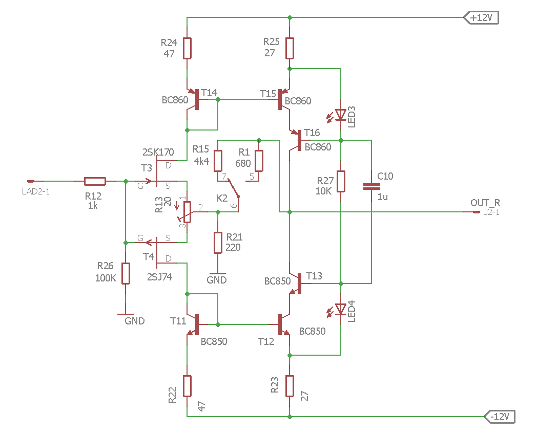

I'm going to build a second PRE based on #485.
This time I would like to apply two sources switch and at the same time a gain switch so in this way each source will have its own gain. I've made prototype.
I used two DPDT relays: one for source switching the second for a gain switch.
The R1, R15 resistors change the gain (see attached schematics).
When i switching sources/gains I am experiencing loud crackling noises from the speakers (even with minimum volume).
Is there any way to get rid of these unpleasant pops?

...Is there any way to get rid of these unpleasant pops?
...It is not easy to find 'make before break' relay...]
If you can't obtain one of the switches juma posted links for, there are a couple of alternatives that spring to mind:
1, My preferred choice would be to change the gain by having two different values for R21, if you use a break before make switch, the gain will drop to unity briefly when switching.
2, Leave R15 permanently wired in circuit and switch R1 in parallel to change the gain.
3, Use method 2 for option 1
