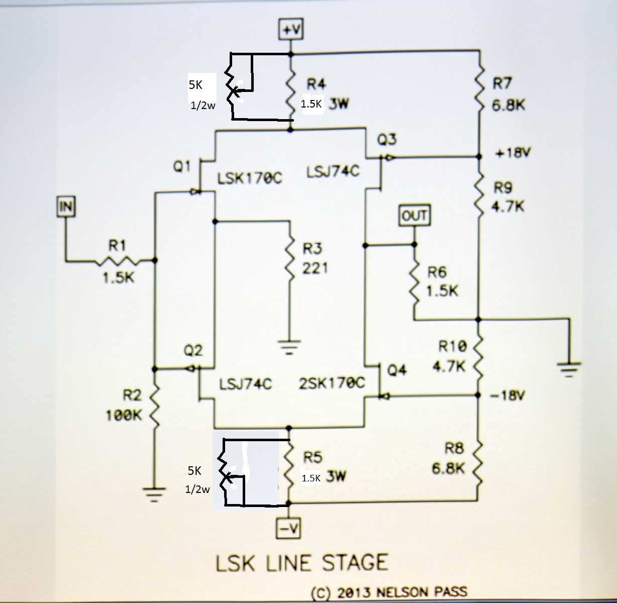

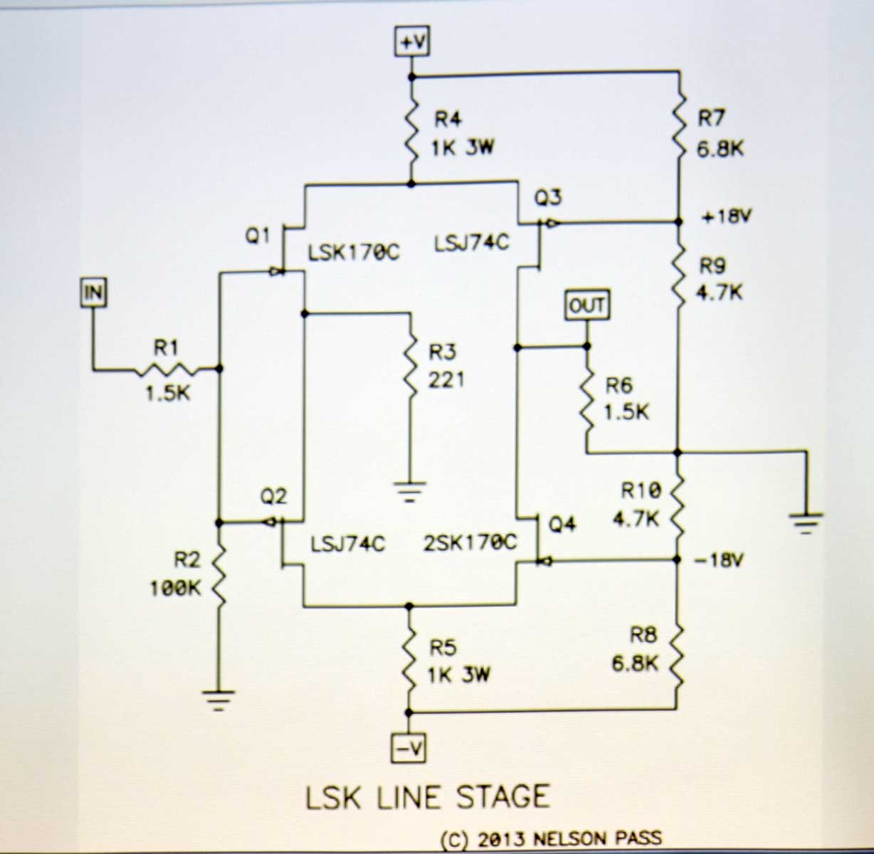

LSK Line Stage Original Schematic BAF 2013
This is a push pull design if there ever was one...
patrick, there is a paper from Nelson pass that explains the single ended concept - it's a great read. I'll dig up the link a little later and post it if I have time. Or else just google and it will pop up.
Of course if by single ended, we meant unbalanced (input/output) then that might explain the confusion.
