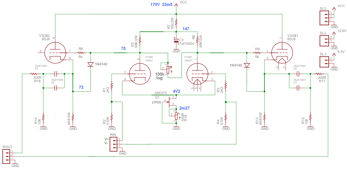

I’m collecting parts and designing how to structure organize thing inside the box. Does anyone have experience with this schematic in general? What I can’t find and figure out rate of volume control potentiometer. Is it 50k or not?
Preamplifier is based on schematic in attach.

I looked into something similar but in a single-ended topology; I ended up choosing the E80CC for the gain stage for their much better linearity. NOS E80CC from Tungsram are still available at less than exorbitant cost.
