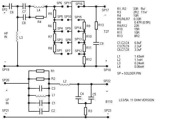

Now the crossover I can build using diy curcuit board, capacitors, resistors but there is parts on curcuit diagram I am not familiar with can someone tell me the parts I put in 'SP' areas i'm assuming its transformers which I am not very familiar with.
Can someone tell me the exact thing to type on ebay to find it.
I understand the SP areas that say HF in, LF in, B100, T27 (obviously).

Circuit diagram attached.

The SP's are only in the tweeter section, if its a transformer exactly what is its function?
Can I by pass this part by connecting the SP's together?
I'm assuming they are transformers because a google image search of LS3/5A crossovers show transformers on them.

"SP= SOLDER PIN"
You're looking at a tweeter attenuation L-pad.
Transformers, you say? They wouldn't be inductors L1, L2, L3 etc.? You're not going to go hurt yourself now are you...?

Recieved email from Falcon Acoustics early today he said 11 ohm version does not have transforners just usual inductors as labeled on the diagram.
I asked him what exactly do I do with the SP - solder pins but no response yet. Its not transformers like i thought and if I leave them empty the positive side from amplifier will not connect to tweeter positive side so no sound as can see in the diagram.
I am now assuming SP's connect with one another.....

Falcon acoustics have informed me it is a resistor ladder i am considering by passing the whole lot and miss out the resistors in that section. The 15 ohm version of LS3/5A do not have this bit.
In fact I just got my self a brilliant idea.
I got the 15 ohm LS3/5A crossover diagram it is plain and simple will just build that one.
