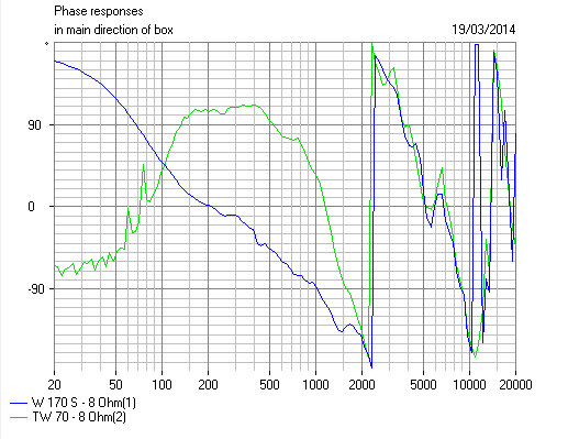

Have you modelled it in some way? Software | Visaton
Use the W 170 S - 8 Ohm | Visaton and the G 20 SC - 8 Ohm | Visaton.
Should be close enough to see what works.

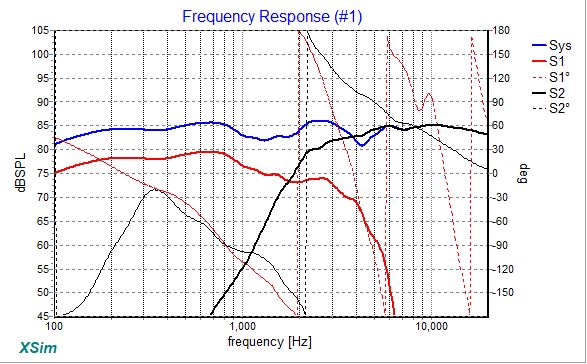

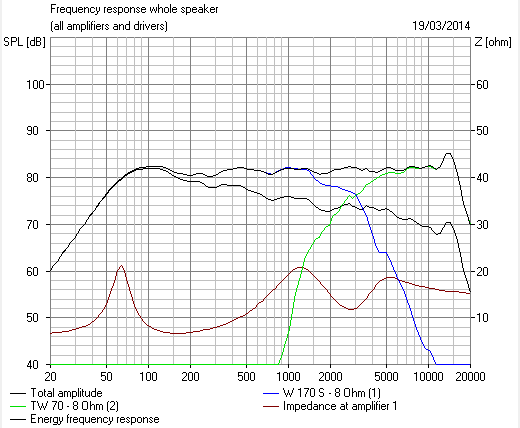

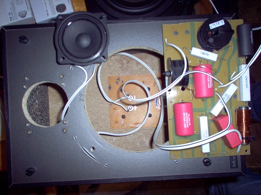

I dug up a bit of notching on a 6" bass:
406870d1395233885-upgrading-mordaunt-short-ms15-bookshelves-ms15_new_crossover-png
The bass LCR at 6kHz is the main event. The 33R/100nF tank does little and could be skipped. That's good rolloff IMO.
406866d1395233885-upgrading-mordaunt-short-ms15-bookshelves-ms15_adapted_fr-png
Excellent lined-up phase, but 90 degree phase works too with an MTM. 90 degree phase has a nice flat power output.
406867d1395233885-upgrading-mordaunt-short-ms15-bookshelves-ms15_adapted_phase-png
406868d1395233885-upgrading-mordaunt-short-ms15-bookshelves-ms15_crossover-jpg
406869d1395233885-upgrading-mordaunt-short-ms15-bookshelves-ms15_final-jpg

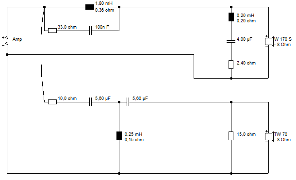

For a 4 ohm MTM you halve coils and resistors and double capacitors in the bass circuit and run the tweeter 6 dB louder..

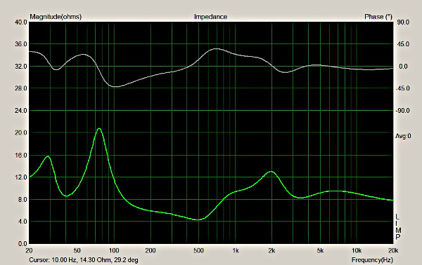

As I happen to have real measurement of the Peerless 830883 (and a Seas 27TBFC/G tweeter) for both FR and impedance, I simulated what happens with your crossover, and the result is not so nice. Also phase of the two drivers at crossover point doesn't match.
Ralf

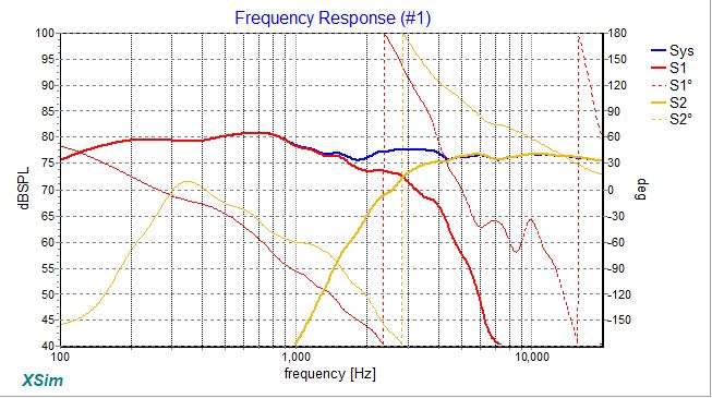

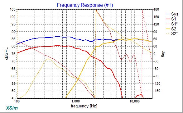

This is how the frequency repsonse looks like now:
Please tell us more about your system, do you have a miniDSP that would allow
you to try different amounts of baffle step?
It looks from the curves as if you need 3 -6 dB of baffle step.
The woofer slope at the crossover point looks strange as if starting at 1st order then
transisitioning to 2nd or maybe 3rd - too lazy to count the dB s. What was the intent
for your crossover, traditional 3rd order or ...?
LSspeaker, you have done a terrific piece of work here IMO.
Looks well done to me.
Issue might be a certain shout at 800Hz:

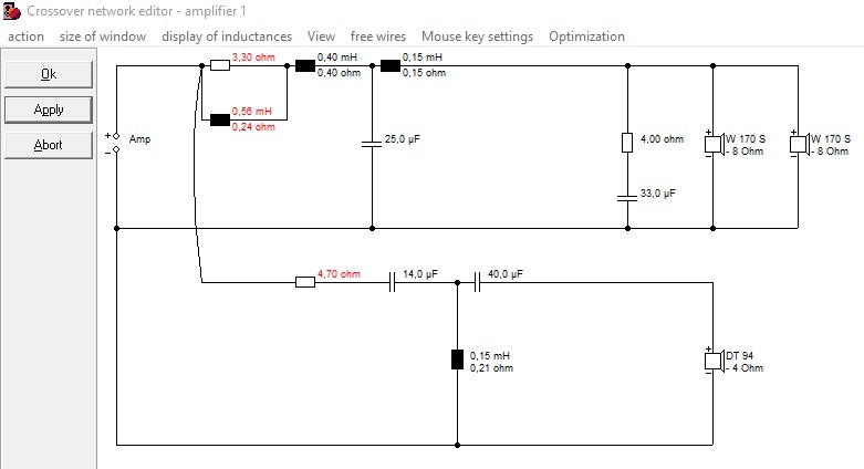

This is the drawing of the new plans for the crossover (changes being the correct zobels and bafflestep):
I now realized I made it a bit hard the way the speakers are set-up for a first speaker-project. I'll see where I get and if it doesn't statisfy I can always just make a simple 2-way out of it.
@system 7:
I don't see a problem for the woofers being connected parrallel, please explain yourself 🙂

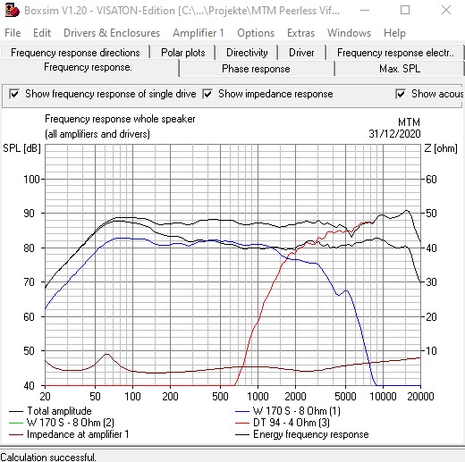

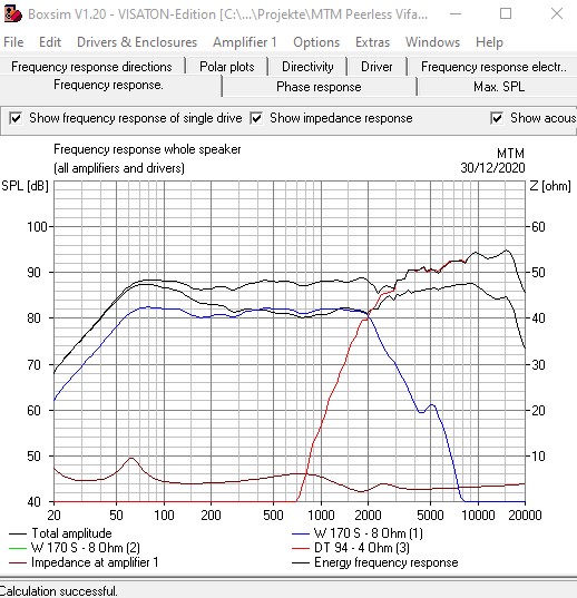

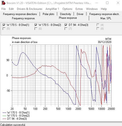

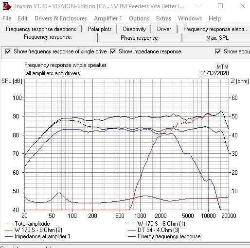

I ran this one up the flagpole with some vaguely similar drivers.
Disregard the tweeter frequency response. I was more interested in using a 4 ohm tweeter to see how it worked out electrically.
I also used a bigger Zobel on the woofers. The bafflestep seems to work.
Preliminary findings are the impedance is too low on the tweeter. That should be fixable. But the whole thing seems to work extremely well on the woofers. It seems to be 90 degree phase which is no bad thing on an MTM. BW3 was Joe d'Appolito's original MTM idea.
We'll get there. 🙂

Thanks for the simulation!
I'm not sure wether the low impedance of the tweeter is a real problem.
I not technical enough too understand the reason of this "too low" impedance, nor know how this can be fixed without changing too much.
Regards

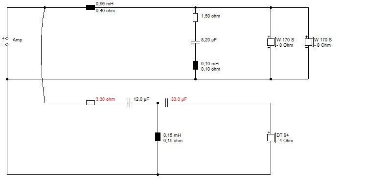

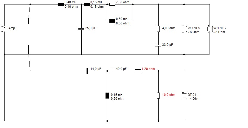

I Did a bit more simming this afternoon. The impedance is improveable without much effort but I wouldn't call this the final article. Messed up phase a bit though. It went more phase aligned.
I also did a 6kHz notch style which seemed to tick the right boxes. The 33uF is fairly optional.
The actual balance is a matter of choice. We have ended up quite monitor flat here. That can be fatiguing in a bare room.

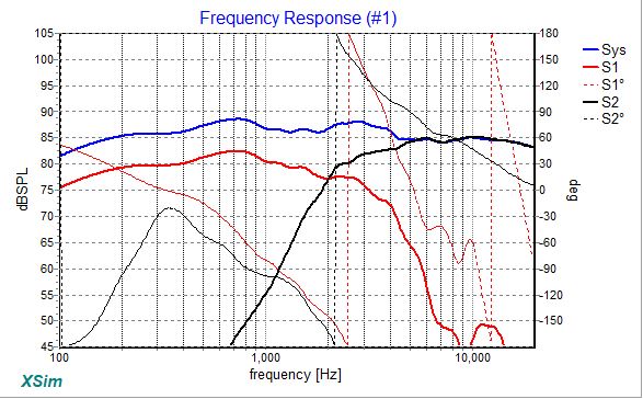

Steve,
sorry to say it again, but offering detailed simulations based on wrong data is pretty useless. I used your choice of components on my data for the Peerless 830883, the baffle I used is clearly not the same but the data should be still usable. Your first crossover applied to my real data gives this (look only at the woofer FR):
attachment.php
Minimum impedance of 3.65 Ohm at around 200 Hz.
The second crossover is not better, with a minimum impedance of 3.5 Ohm between 200 and 300 Hz:
attachment.php
I think that the following FR looks a bit better, even if it is not completely correct. I used my data for a Seas 27TBFCG tweeter (different driver), and moreover the effect of my baffle on the tweeter is different than the effect of the OP baffle in a MTM design. Minimum impedance of 3.1 Ohm between 300 and 400 Hz. Again look mainly at the woofer curve:
attachment.php
IMHO what has to be done is a complete redesign of the current crossover, but first the OP needs to correctly measure the drivers on the baffle. Without real data we are essentially shooting in the dark.
Ralf

Actually, Ralf, I was kinda hoping you'd sort this one out rather than me! 😀
My idea was essentially this:
906604d1609426937-ls2019-time-mtm-notch-circuit-jpg
The 6kHz notch is essentially written in stone for a simple circuit. The only bass variable is the 0.56mH coil size.
