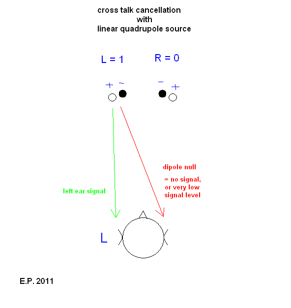

This is my understanding how linear quadrupole source works for imaging.
Note signals are wired in opposite sides, left speaker receives R signal and vice versa.
In the pic is assumed left channel has a signal and right channel is mute. Left channel signal is transferred only to the left ear while right ear does not receive any signal. The system essentially forms a cross talk cancellation.
Radugazon, is this the way you had in mind? 🙂
- Elias

For a practical matter I should add that the dipole cancellation on the ipsilateral ear does not need to be infinite 😀 A few dB difference in the interaural signal amplitude should be enough to shift the image to the side. This is because the interaural delay difference is very short due to the frontal location of the sources, so there is no need for compensation of time-intensity trading.
- Elias
I don't remember his HF channels are wired in opposite side, or I missed it?
And I guess this works only if the dipole pattern is close to perfect (a very fat 8), and the null is precisely aiming the correct position. But how about off-center listening?

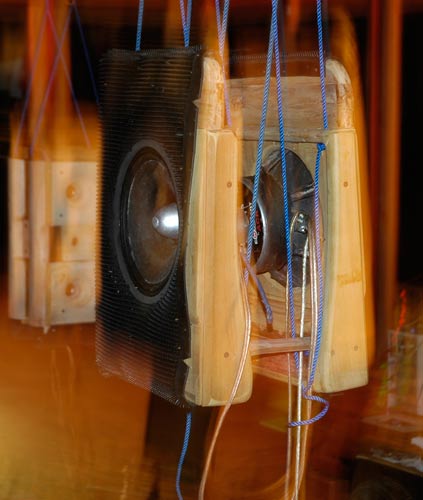

Hello...
I gave a try to Elias's idea, not followed by a measurement session but by immediate listening comparisons (as always, with a DCX it's remote and a cordless mouse). All at my usual 5 meters listening distance and speakers 3 meters from their back wall.
First impression : widening and airiness of the sound stage, more presence of the voices (by presence, I mean "sculptural effect", not the classic low mid bump). More sparkle too. 😀
Critical listening : s..t ! a violin that is panned on the left is now on the right, as some vocals, it was too beautiful to be true 🙁
Thinking of it, this doesn't mean that the idea is fundamentally wrong. Here, my "tweeters" are very close from each other (7 cm) and as the wave guide part is firing outside, it pushes more energy in the room that the dome inner side.
So, the experimentation is not the exact translation of Elias's thoughts.

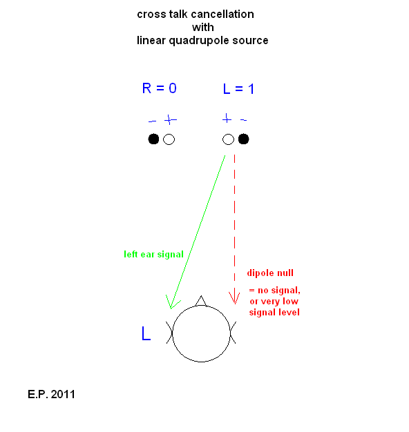

The dipole null is aimed to contralateral ear. And both halves of the linear quadrupole source are tilted a bit. Tilting can happen automatically due to asymmetry of the design.
Again left stereo signal is transferred only to the left ear while right ear receives no signal. Cross talk cancellation happens.
- Elias

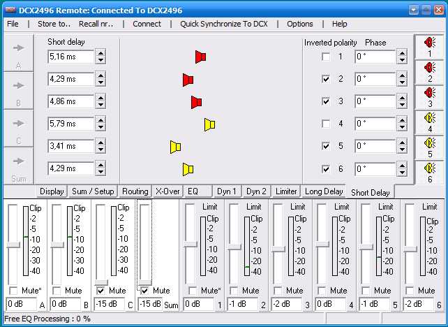

To stay on the same subject of strange ideas, it's already a long time that I compare the classical settings to the nightmare illustrated by the screen capture below 😱.
Maybe you can think that my kids have been playing with the DCX !!!
Not at all, I have no explanation behind but it works. Ordinary "widening stereo" uses a global delay on one channel, producing echoes if too much delay, and automatically creating cancellations and reinforcements. It's funny five minutes and boring later.
For this particular kind of settings, I listen and measure (days long process) for obtaining the desired effect without messing up too much the FR (at least incidents that are easy to EQ) and keeping a monolithic step response for the whole system.
I use records that I've heard on the MBL 101 (memory is trusty for sound stage) and some others from research laboratories "I'm now on the left inside of the dummy head...bla bla...".
So, the optimization can be done quite accurately by moving the sliders, localization is almost under control. The only problem is the number of combinations with 6 sliders. Then have to equalise and retest again and again, till something ok.
Of course, this interferes with the speakers placement, with unexpected effects:
  • mids units close to each other (60 cm), sound stage is definitively too wide
  • mids spaced as 170 cm, sound stage is "realistically" narrowed
I guess this has to do with the delay of the important side reflections (around 16ms, and they hit diffusers) and nothing to do with the localization of the source itself.
Listening to this on normal music, what can I say? It's more beautiful...but different from the pinpointed ideal. The source is not "exactly here", it's more "around here". Ok, it's personal but I feel this light fuzziness more natural. The sound stage is not much wider, but the feeling of involvement spaciousness and airiness (as before with Elias setting) is out of comparison.
Not so bad, but this is the best: the system being EQ the same, something is changing in the voices, the piano...a kind of clarity, of vibration that makes them more detached from the back ground and looking more alive. Really bluffing.
This trick works well on almost any kind of music. Symphonies or little formations are Ok for classic. It adds very little to early jazz stereo, maybe because the R/L separation was exaggerated, but it removes nothing. It works as hell on modern music but I have a few records where it produces a narrowing of the sound stage (probably they produced it with a widening that is canceled by my settings).
As a conclusion, I have been working a lot on time alignment, using all the possible ways (except substractive and FIR), but never got 10% of this. The ambiophonic CTC as emulated by the Audio Mastering suite
is not ok with this system, producing reverb, echoes and reducing the highs.

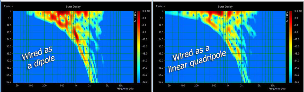

About interactions with the room, I did an experience using my favorites victims as the picture below : magnet to magnet, once wired in phase opp as a dipole (compound dipole but dipole, there's a deep null and a symmetric front/back radiation) and later as a linear quadri, wired in phase (speakers are too close to have the full omni radiation but there is no null).
Of course, band pass filtered and EQ to have the same FR at 30 ms, except for the dipole dip at 300 Hz that can't be filled.
What happens ? The official wisdom says that dipole interferes less with the room than any omni source. I would agree, but here it's just the opposite. Can be seen on wavelets 😉 or CSD, but this image of burst decay is more photogenic.
BTW, if I had to choose a sound more than a chart, the dipole has much more slam but wouldn't be the other one more detailed?

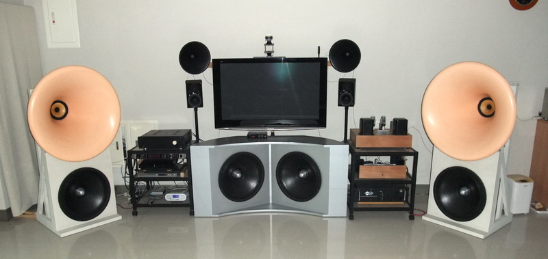

As to my own trial, I made 2 changes to the last version.
One was inserting a mid-tweeter in the range of 1.6k~7kHz or so. This section is made of 90-degree conical WG and spaced 1.3m. (on two sides of my TV) I made this for filling the huge gap between tweeter and mid.
The second was to make the tweeters (or, now supertweeters) even closer to each other. I don't have enough drivers to keep the 'quas-omni' arrangement, so they were ordinary front firing setup. But this setting is bad, with too much combing. Several days later, I made this super tweeter a single mono source, also mentioned here roughly: http://www.diyaudio.com/forums/multi-way/10962-stereolith-loudspeakers-question-14.html#post2467970
I also mimic the 45degree uptilted arrangement of Stereolith. I think it's cheating somewhat, to make the HF dispersion wide - it stays in some degree of off-axis across a pretty wide listening area. (Like walking around a big sundial and looking at it, it's always relatively tilted and the slope changes very little across a wide veiwing angle...)
OK, how does it sound? Short impression was good. I walked around the room, the tonal balance stayed very stable. As to imaging, it's a mixed bag. Or I should say it's very recording-dependent. More listening and tests are needed.

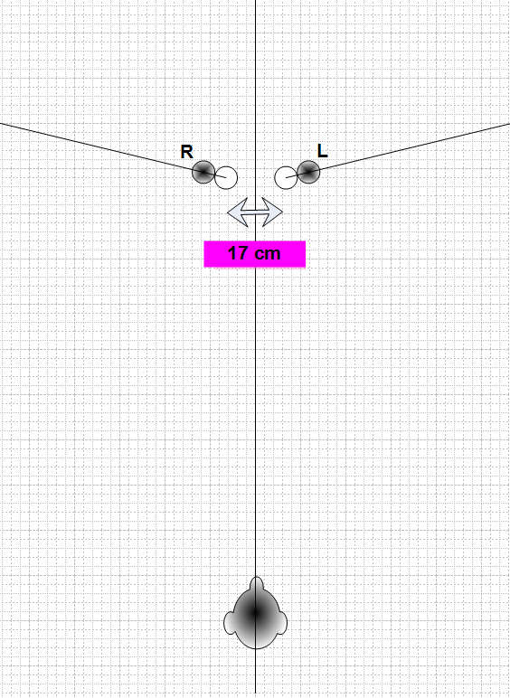

I have personally no idea about XCT, but can we say that smearing or diminishing the ILD clues is a good idea in central HF system? Are the ITD clues reinforced then? Are them finally more important ?
Wow, this is exactly the theory proposed by the Stereolith creator.
Just in case, I have been spacing my tweeters of 17 cm, the size of my head.

Just a little reminder, the mono portion of my trial (up to now) is only above 7~8kHz;
Under that, and down to about 2kHz, a stereo pair are separated by 1.3m;
Under 2kHz, sources are separated by more than 3m.
(all 1st order filters, so a lot of overlap, though)
So, what I got must be very different from yours. I remember your [mid-tweeter/tweeter MTM module] works above 1kHz or so -- that's a half of audible spectrum !! And the conditions of radiation pattern and space are very different, too.
Have been listening more and more, I ran into a dilemma🙁
Close positioned or now mono tweeter has a strong point of spaciousness, especially in the depth. Images seem always appear behind the speakers. The presentation is more of 'you are there', instead of 'they are here' -- a 'tradition' of high efficiency horn system (what I had before).
Images in the soundstage are well defined, individual instruments or vocals have their right positions or even shapes and sizes. And I got a feeling that sources seem to have 'haloes' or they're slightly glowing -- there's soft and tender 'atmasphere' around each of them and among them. In addition, such wonder can be maintained in a very large listening area. In extreme off center listening positions -- at the side of the speaker, imaging collapses (of course) while tonal balance stay very stable.
I'm not sure how the images can be projected and focused beyond the tweeters (no special signal process here, only ordinary 1st order filters). Those sounds coming with very high frequecy overtones (attacks of percussions, strings...) are indeed formed far outside of the tweeters when call for, but with a condition...
---- the sound must have its own 'body' in relatively lower frequencies (the fundamentals).
When the sound is purely HF, then comes the problem. Jazz piano trio is one of my favorite forms of music. The drum set is often arranged at one side of the stage (-- almost always on the right in one of my favorit trio, Keith Jarret Trio). I can 'see' the piano, bass, drums at thier correct positions, but when the cymbals are hit, almost always, they appear around the center -- detached from the whole drum set. 🙁
Sometimes, a large ride cymbal is softly hit (or hit by a stick with felt ball), there's larger proportion of lower fundamental. This note would come back to its correct position with the whole drum set. Such effect is annoying, be it CD or DVD.
Sigh~ What a pity !
By the way, I made the supertweeter in vertical face to face 'quasi-omni'. And I've tried arranging the midtweeter horns to side or up firing (like the ears of Shrek). Shrek type radiation makes a very spacious sound field, but is not helping the 'positioning' problem of the HF images. And it's too much 'atmosphere' with too less 'body'.
I've also tried "R-L" and "R-L" signal on the midtweeters by series connecting. The sound seems clearer, but could not solve that problem, either.
So, it's not perfect yet. The journey goes on.

Over delaying the Hf for creating a precedence effect is not working, but there's something else to do...
go to the ISVR dl page and dl tracks 1,2,3. These tracks are not intended for normal systems, dunno what kind of matricing they have, but they are very revealing and easy to interpret.
Maybe the 2 will show "all in the center" instead of "left". Why ?
Long time I have been self debating with this, because the few settings correct on it where obviously better imaging. I know now that this test needs a lot of energy in the mid low for giving the lateralization, ITD clues, but this can affect the tonal balance.
I discovered later that retarding R (from 0.5 to 1.8 ms, following the filter used) re-establishes the lateralization without affecting that much the balance.
By experience, these settings sound wider, on normal tracks, without the HF stuck in the middle.
So, we are speaking of tweeters since a while, but mids and low have a big importance in the HF restitution. Try abusive overlapping with EQ, try all the possible toeings, and maybe delaying mechanically one of the mids...just to see, because it's not sure that the global result will be satisfying on real music.
