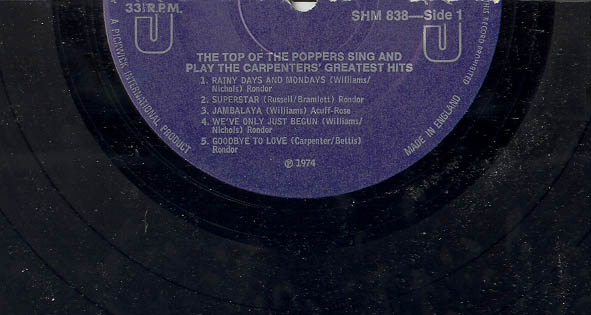

"The Top of the Poppers Sing and Play the Carpenters' Greatest Hits" has been sacrificed to science. This may, in a small way, have increased the cultural quotient of the UK...
The thinnest part of the LP was 0.931mm thick at a radius of 146mm, the thickest 1.450mm at 52mm radius; this corresponds to an angle of 0.158 degrees. (Just as well it was measured, rather than relying on my memory!)

Those are some pretty small numbers, I have a feeling that the unit to unit variance would be be pretty high percentage wise.
