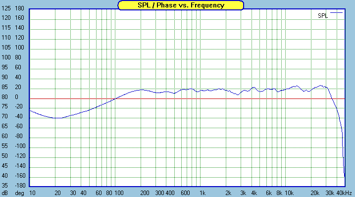

Here is Zaph's measured response:

Here are the results plotted with Speaker Workshop.
This speaker, if built, would have absolutely no midbass or bass, and would have screeching high midrange and treble. So what happened?
The ER18RNX in this case has a rising response; to flatten this out requires more inductance than the textbook formula provides. Using the textbook inductor, the response of the ER18RNX stays at reference level until nearly 5kHz, where it drops off very sharply. There is a bobble in the phase response in this area as well, due to the ER18RNX having a cone mode with a peak at 5kHz. This causes the ER18RNX and the 27TDFC to be quite mismatched in phase and results in a suck out around 5kHz.
The larger than textbook inductor also provides Baffle Step Compensation (BSC) by beginning the electrical rolloff at a lower frequency, effectively boosting the bass and midbass. This is a trick that works well with woofers that have rising response, and is something that a textbook design would have difficulty implementing without much trial and error.
The 27TDFC in Zaph's design has been tuned to compensate for the woofers rising response and doubles to tilt the listening axis upwards to align it with the tweeter. The crossover rolls the tweeter off at a much higher acoustic slope by combining the natural rolloff of the tweeter with the electrical filter rolloff. The resulting inductor value is no where near what the textbook filter would recommend. It is nuances like these that make crossover designing both a science and an art.
I think you will find that textbook filters work best when the crossover frequency is more than an octave (double or half the frequency) away from the usable flat response of the drivers. Even then, it is still going to be hit or miss, with quite frankly more misses than hits.
