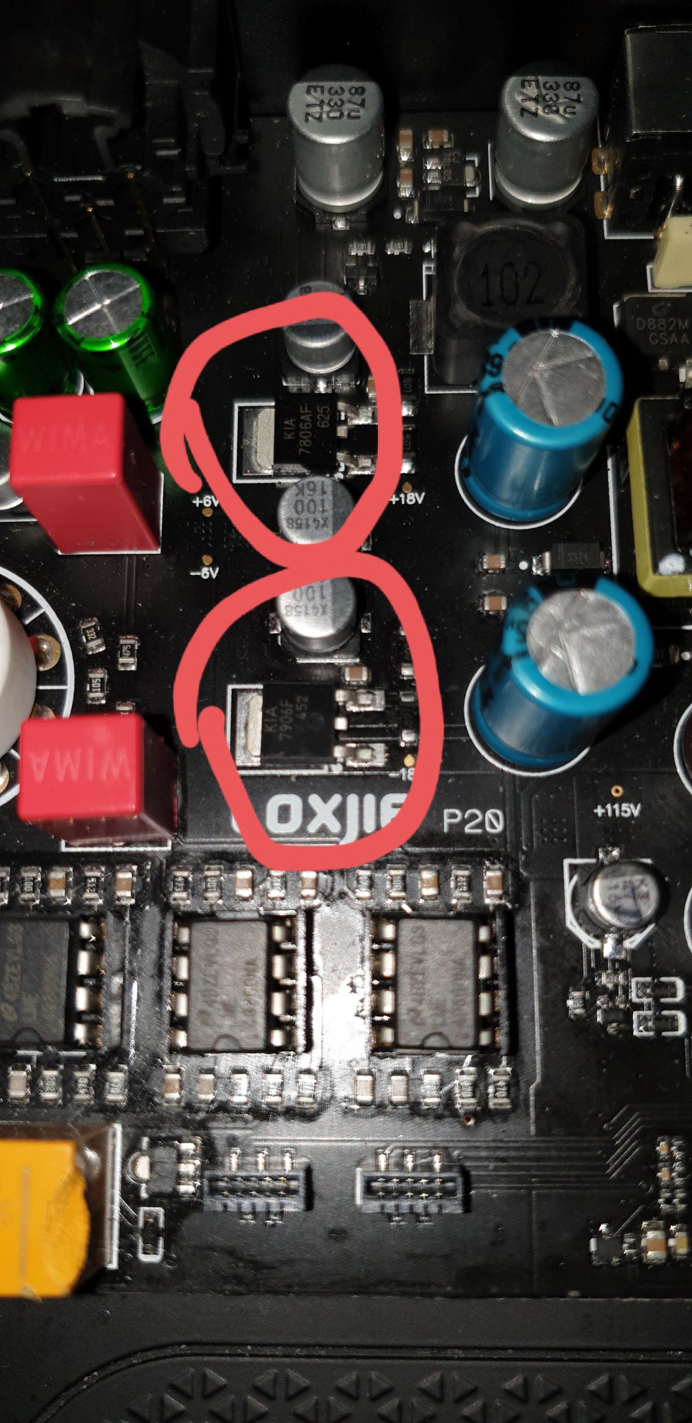

I found two regulators inside but its input pins are at +18/-18V they are only giving 7V output and I'm guessing its for powering tubes, I couldn't trace where exactly the 18V coming from to the supply pins for op amps, I think this Chinese amps design is pretty weird.
I didn't check the output current yet for V5/V6 but I'm assuming the 2V difference wouldn't kill the op amps, The V5i design was influenced by Muses02 op amp and its ABSOLUTE MAX OPERATING VOLTAGE is +-18V and V5i a hybrid op amps so its should able to handle the extra voltage?
I wish Burson Audio was clear about their op amps on their datasheet like sparkos but they are selling their op amps without clean technical explanation which is why people think that their op amps can be used anywhere.

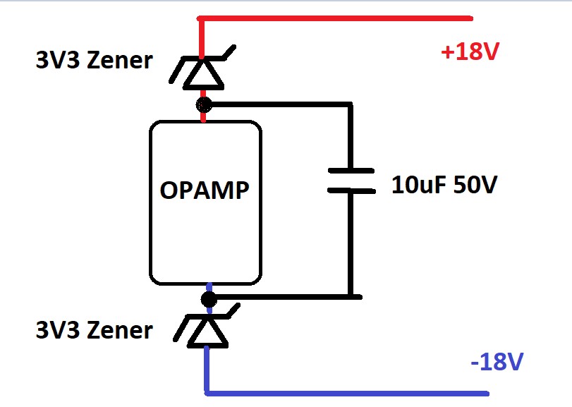

Well first of all lets put some numbers in...
If the opamp draws say 40 milliamps then if you run it on -/+18 volt you have 1.44 watts dissipation. At -/+16 volt you have 1.28 watts. Its hardly a big increase on what is a fairly large board.
Adding two Zener diodes like this reduces each rail by the value of the Zener, so here you get approx -/+14.7 volt rails. Dissipation would be 1.176 watt in the above example.
The Zeners can be small 0.4 or 0.5 watt types.
Don't forget to add a suitable cap for decoupling as shown.

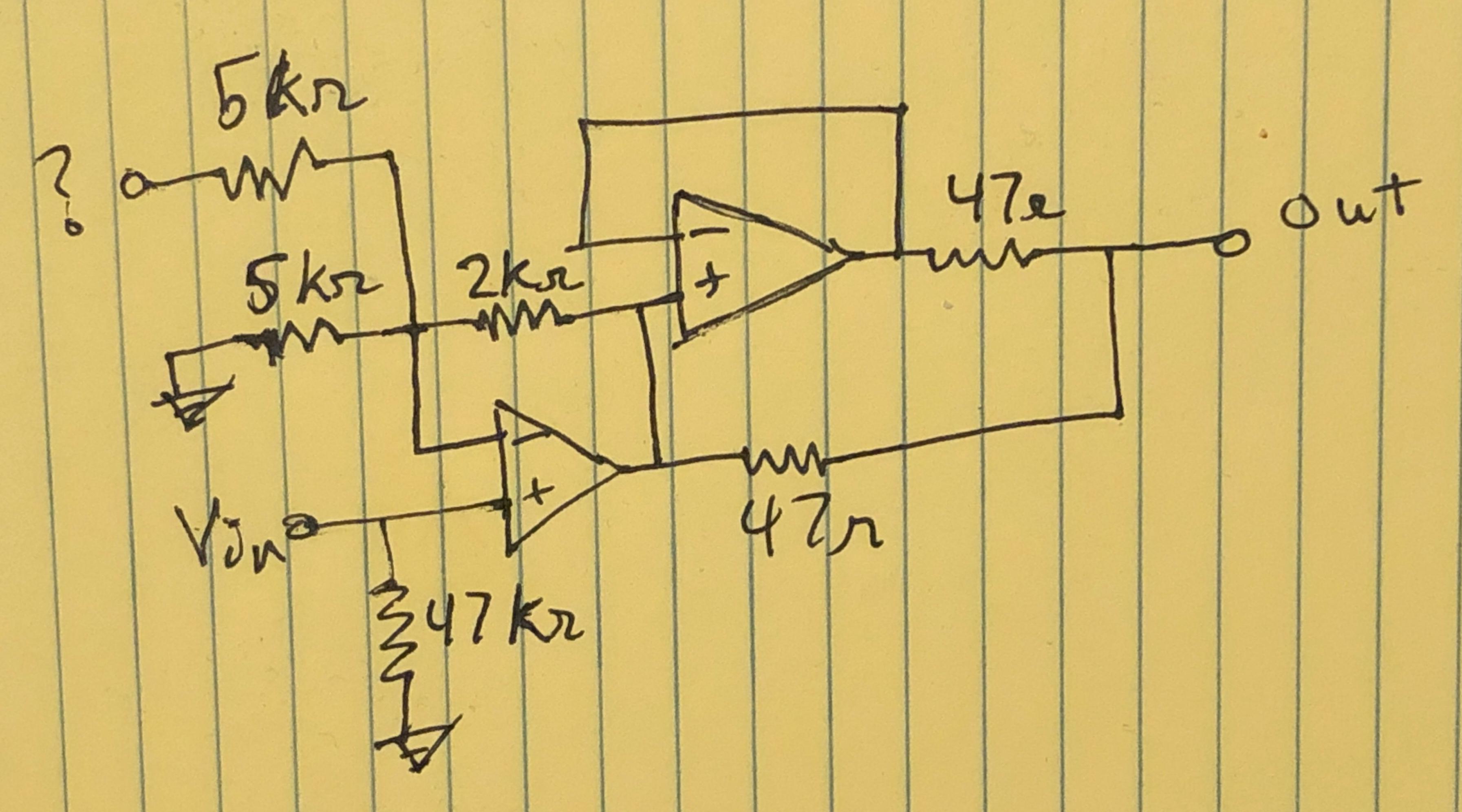

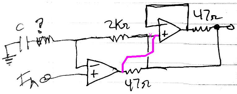

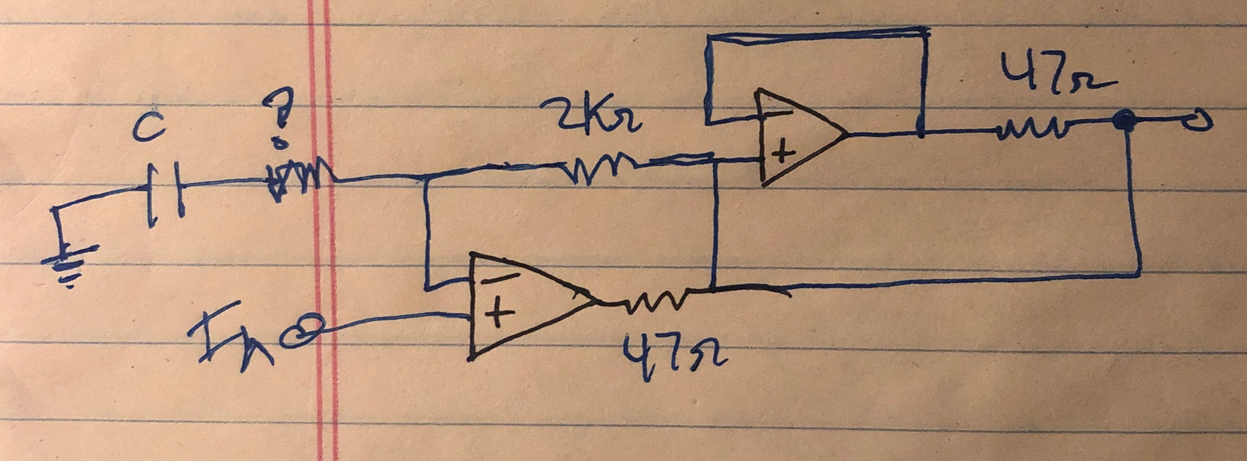

Here is what I’ve come up with so far for the output stage, after some probing.
Not positive about the cap, but would work as a high pass filter. Wasn’t able to get a good reading on the ? resistor because of capacitive coupling. Anyone want to defend this circuit?
The way I see it … I know the input , output and the power supplies. I can remove this opamps and put in my own amplifier design. Probably using the OPA1612.

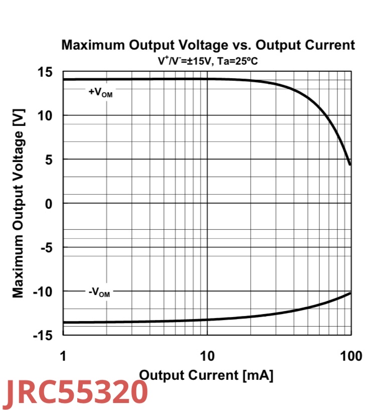

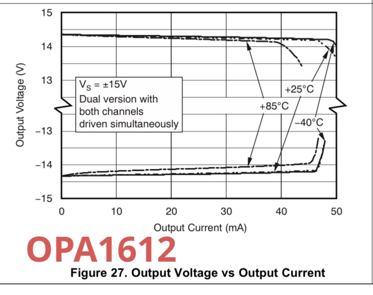

The JRC op amp has big voltage droop with current above 10ma. That’s one reason I prefer the OPA1612. Under load the circuit posted above would multiply the droop issue … with the input of the second op amp buffer being fed by output of the gain op amp which drives the output as well.

I strongly suggest your circuit is more like this than your drawing.
I would call 10% drop "not big", even small. 1dB. The JRC55320 at 10% drop (14V to 12.6V) is flowing 45mA. And 12.6V at 45mA is 280mW at 280 Ohms, VERY LOUD. OTOH, at 100mA we have 5V which supports 250mW in 250 Ohms, not a small sound. Doubled-up we may have 5V 200mA for 500mW in 25 Ohms, and slightly less in 32 Ohms. (The 47 Ohm resistors will modify this especially for low-Z cases.)
Are you actually having trouble getting loud-and-clear? Or just fretting?

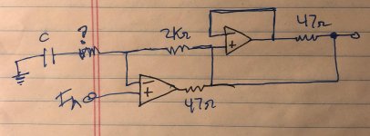

Yes, you’re correct about the wiring, thanks. I was wondering why the circuit looked different than an application note I saw. I did some more probing tonight and filled in more of the missing pieces.
I’m guessing the question mark is for global feedback to the amp input? Haven’t found where that goes to yet. Any thoughts?

Okay, well I think the next step is to hook this up to a scope and see what the gain is … open and closed loop. Still not sure about that other 5k resistor, and what it is connected to. I have some time this weekend to play around with it.

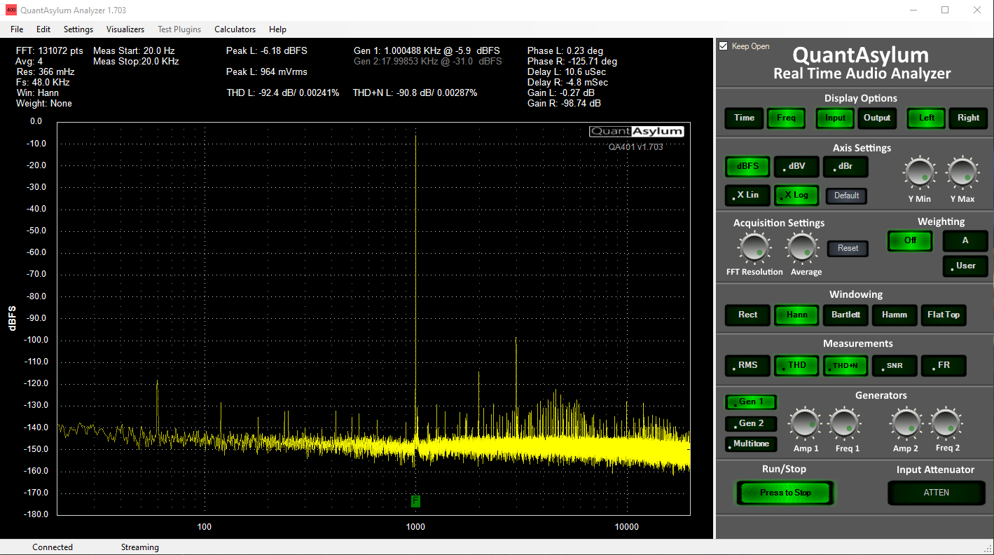

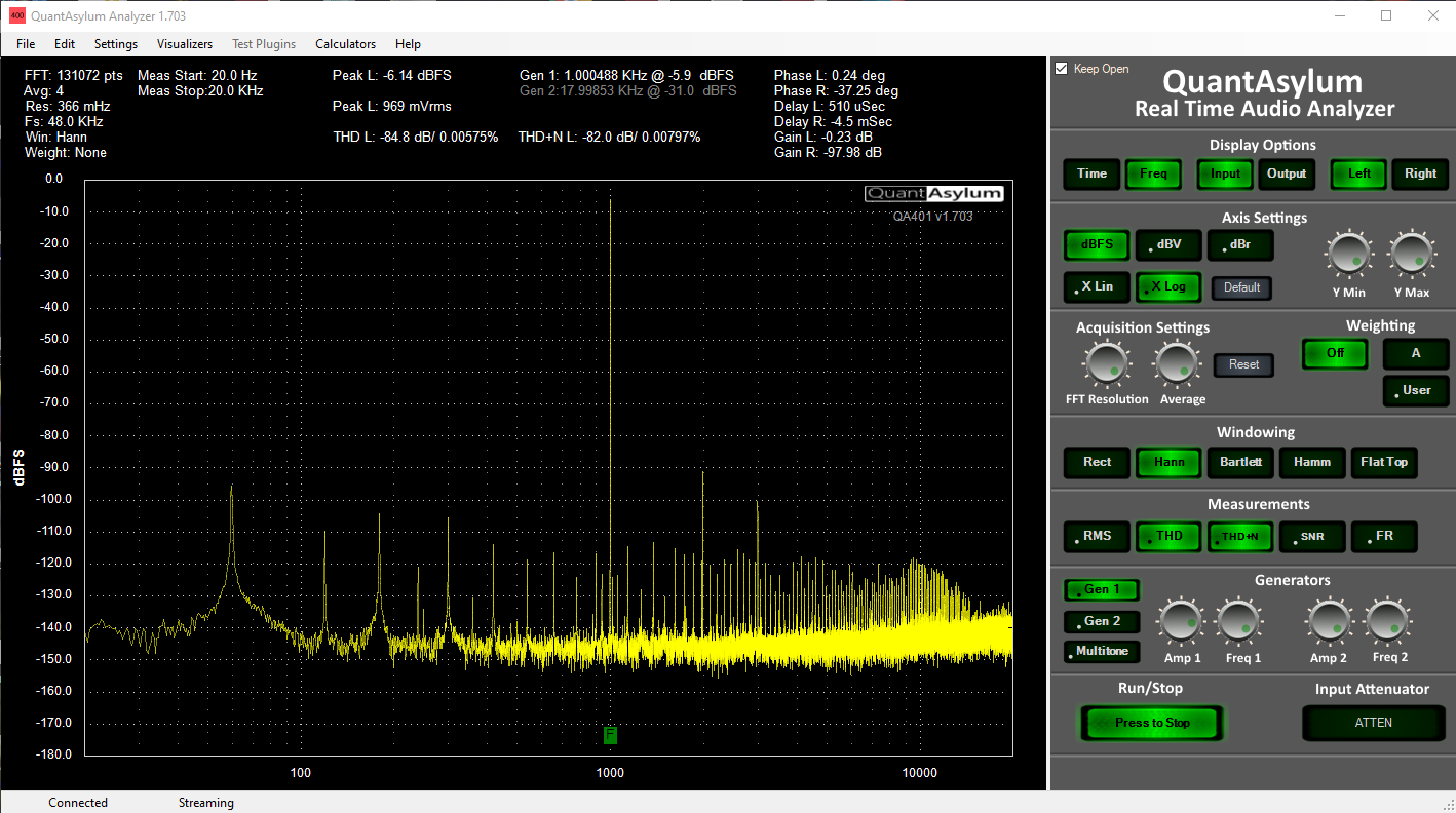

I also took distortion measurements at ~ 1 volt output from the P20 balanced out. I used single ended inputs. See attachments.
It measured about as specified. The right channel looks a bit better in distortion and noise. I'm thinking a difference in tube specs is likely the reason. I also tried putting a 220 ohm resistance load at the output. It made no difference in distortion.
I also measured the gain of the amp. It was 6 Vout/Vin , so pretty sure that other 5kohm resistor with the ? in front is a feedback resistor. The opamp circuit is set up in a non-inverting topology with a gain of 1.5 for the output voltage from the Tubes. It can also be thought of as summing the feedback voltage and ground (0 volts) at the inverting input, which is just 1/2 the feedback voltage. That's my best guess, but it's clear that the Tubes are providing voltage gain, from what I can see.
Probably didn't explain that well ... but makes sense to me 🙂 , the amp input connected to the ? in the circuit diagram would reduce voltage gain of the tubes.
