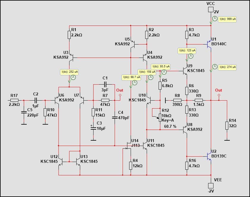

LowVolt Battery Opamp Very low power suitable for Headphones
At +/-2 to +/-3 Volt it takes less than 1mA from supply at idle.
It is rail to rail output!
Feeding 32 Ohm it has low distortion THD 0.00043%.
Reactions: adason and stv
I have updated schematic in first post.
This amplifier is good.
It draws very little current from 4x1.5V batteries.
You should actually build this 🙂
The sound should be very clean with low distortion.
