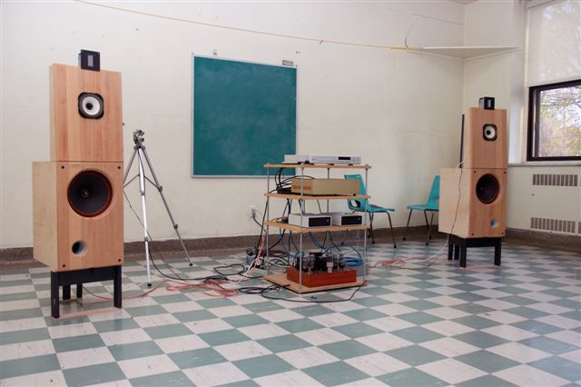

I'm a member of the AMA. Did you get a chance to come to the last meet where I was showing my Lowther Open-Baffles?
I doubt you will be able to find any single-driver OB that will give you the double-bass with reasonnable realism. Mine were inpired by the BassZilla. For open baffles, you might also look at the AcousticPlan Veena (from Germany). Nice design.
Btw
BTW, the lowthers on the pic are C45s. The tweeter on top was only added to show off the DEQX 3-way processor (to see how it can work in less than optimum conditions (distance between drivers, dissimilar amplifiers, large reverberant room, etc...).
The woofers are old EV Pro12B in simple BR cabs tuned to 35hz.

My setup is bi-amped. The open baffles (with C45) are 94 db. You can drive those with event 1.5 watts (since the amp does not have to produce the lower frequencies). I currently use a PP 4B4G but could just as well use a 2a3 triode.
For the bass bins, I use a gainclone (about 30 watts) and it works fine. Dick Olsher has similar designs with series crossovers (with 1 12 inch Pro driver by eminence) and claims to get 40hz to 20K at about 94 db efficiency.
The Acousticplans also have amplified bass (in open baffle). When you bi-amp, you don't need much power on the lowthers and you also don't need very efficient woofers for the lows. The EVs that I am using now (EV PRO12B) are only about 89db.
