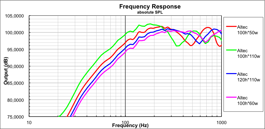

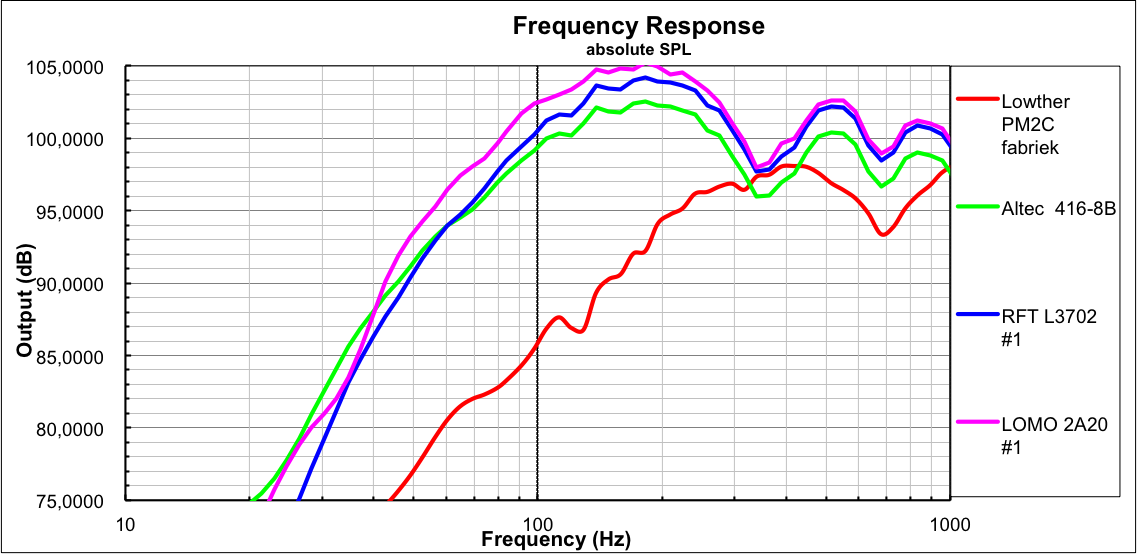

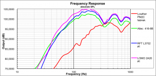

The simulation:
Baffle Height (mm) 1000
Baffle Width (mm) 1100
Hight above floor (mm) 300
Dist. rear Wall (mm) 1000
Dist. side Wall (mm) 1300
As you can see the RFT and LOMO and even Altec are too sensitive for a simple match on paper; this looks like it might require bi-amping; but, what Jon did was cross over very low and then . . the mismatch disappears. Interesting concept.

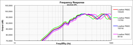

I simulated various heath/width combo's. Unit at 30 cm from floor.
I plan to go for 60 cm wide for the bass section, with 30 cm solid side flanks, making the acoustic path effectively 1m05-1m10. High: 1 meter should be enough - the GREEN line. Higher up the board there is no need for the flanks or wings; like Jon does.
