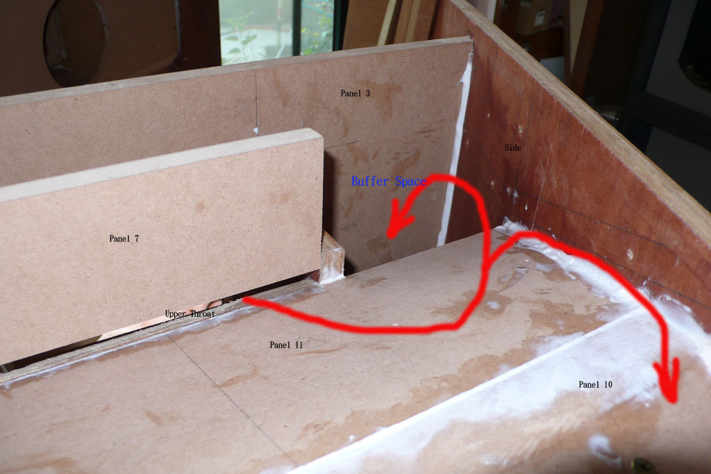

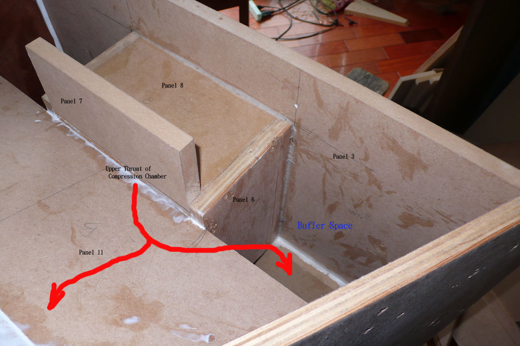

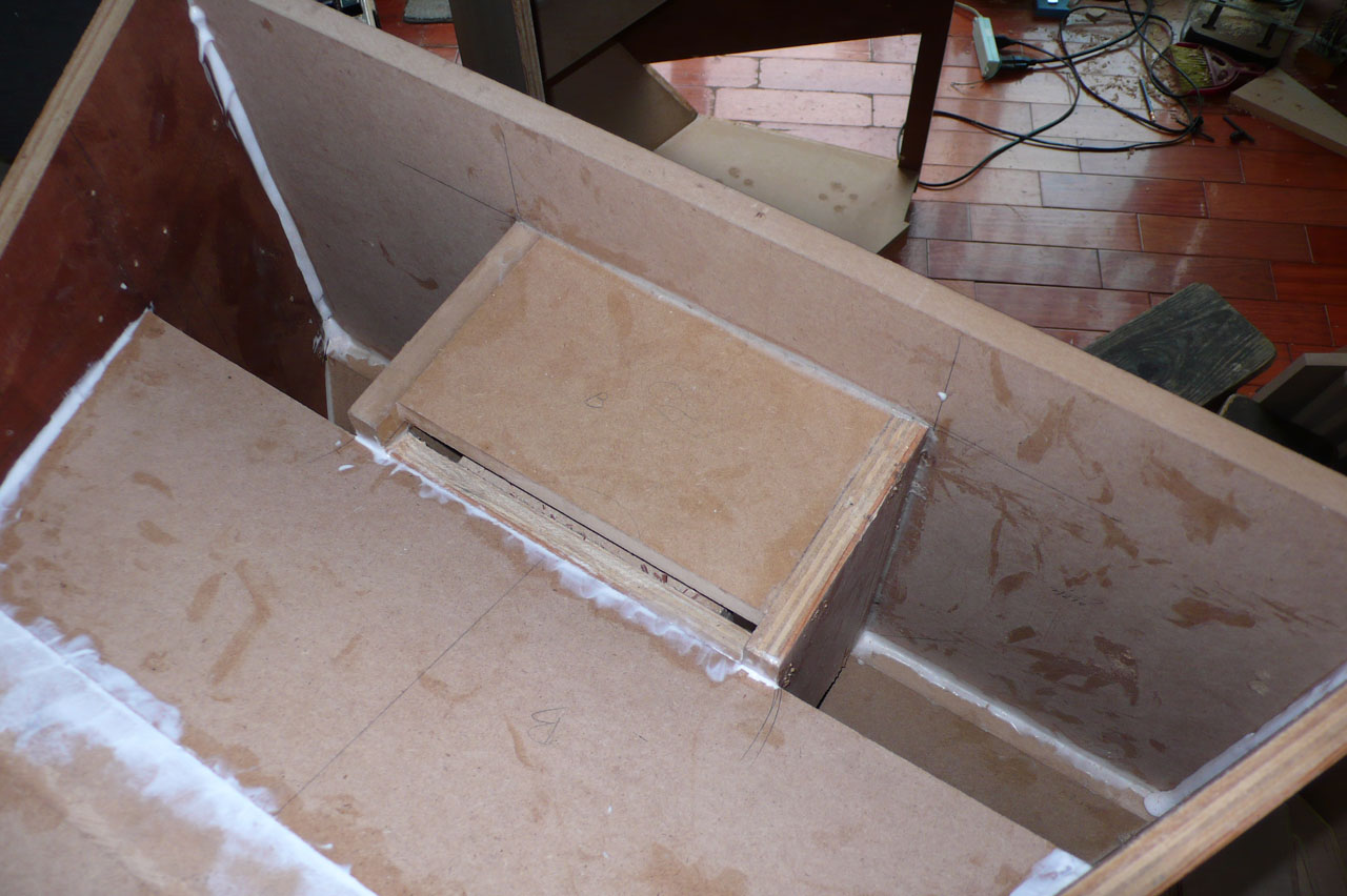

When the build progress so far neared to the ending, I found there are more questions than answer.
The compression chamber has second upper throat which called Bicor devised by Lowther. The lower throat matches a pair of divided panels to gradually expand the horn contour; however, the upper throat doesn’t connect to any dividing panel. Even there is a big empty space around the compression chamber connected to the upper throat. Since the area of the upper throat is about 1/3 of the horn throat, physically 1/3 of the sound wave from compression chamber will escape to that buffer space. I wrote an email to Lowther Company asking whether it is a need to add two panels to block that buffer space, and should I add some damping materials into that buffer space. Kindly Lowther quickly replied that there is no need to add any panel and damping material, and “bicor systems should always have a large chamber area before restricting the outlet”.

Peter,
i saw a lowther plan from the sixties
using softfibre,
dont underestimate the inner reflexions
in the press chamber.
I agree.
A Lowther plan from the sixties? Maybe it is Acousta?
I can hear some HF resonance coming out from horn mouth of my Acousta 115.
Lowther suggests "blockboard" for Acousta, I use plywood instead.
The compression chamber of Acousta 115 is so wide but short in depth, an apparent geometry of resonance.
It is a great idea to adhere a thin softfiber layer in the compression chamber of Acousta 115.
Opus one has no such problem. The inner space of compression chamber is almost occupied by the very big magnet of PM4A.
The sound of Opus is very clear. I can't hear resonance from its horn mouth.

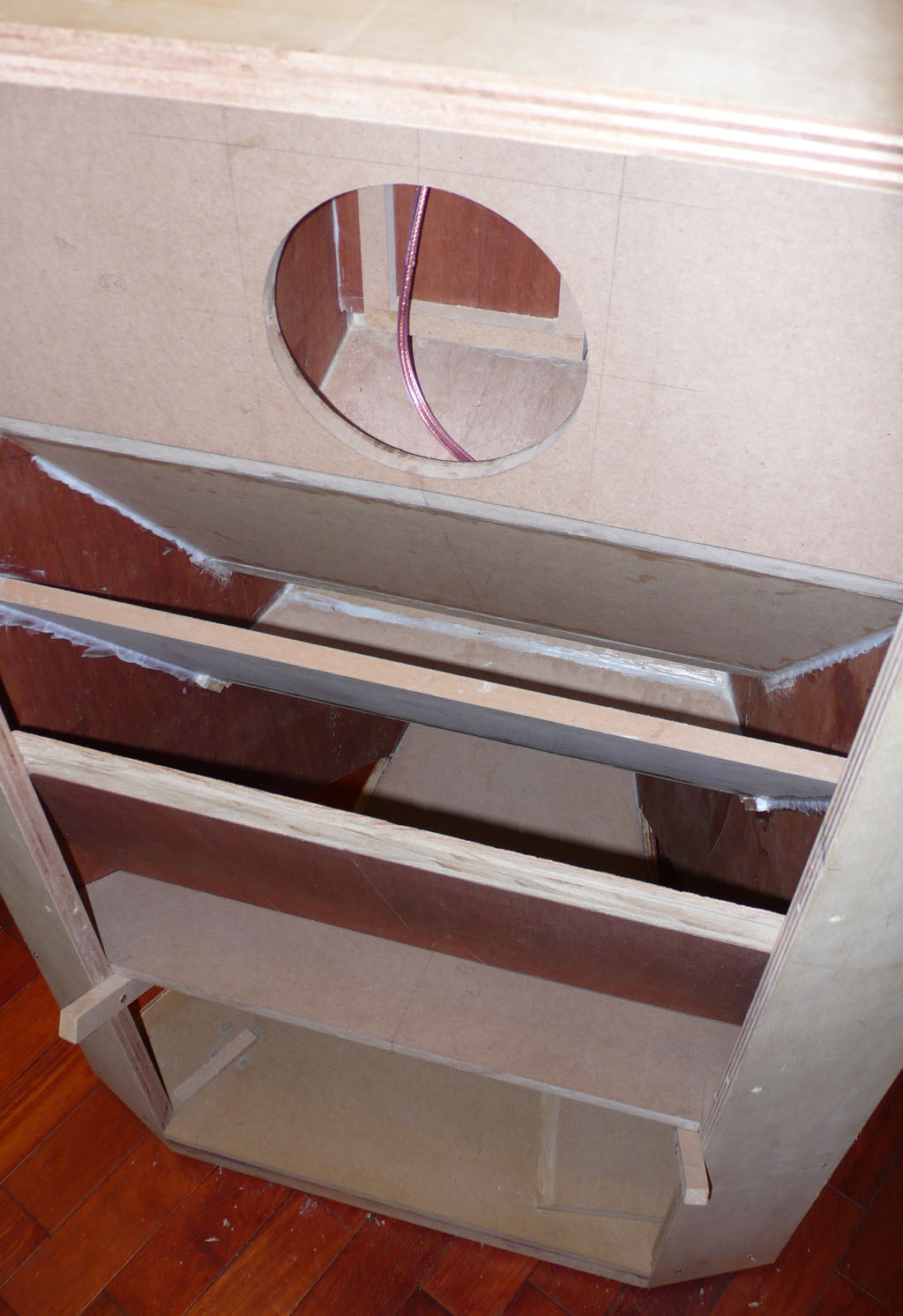

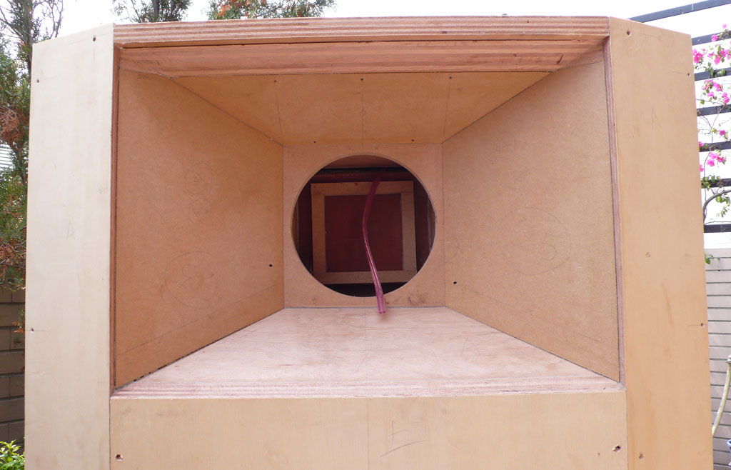

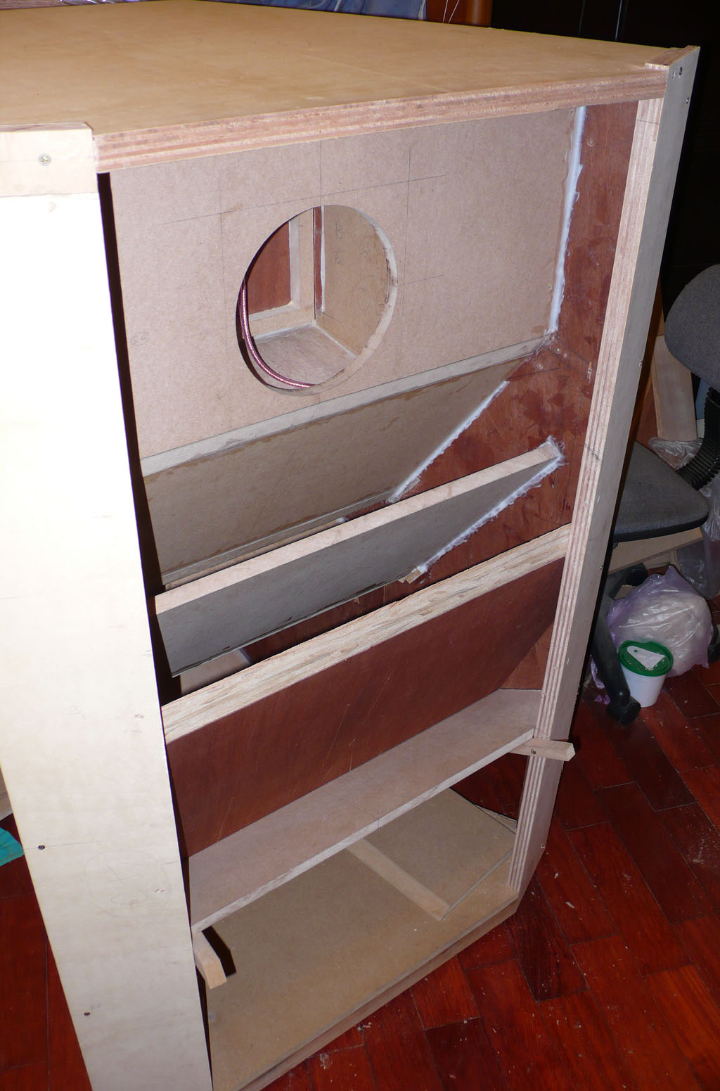

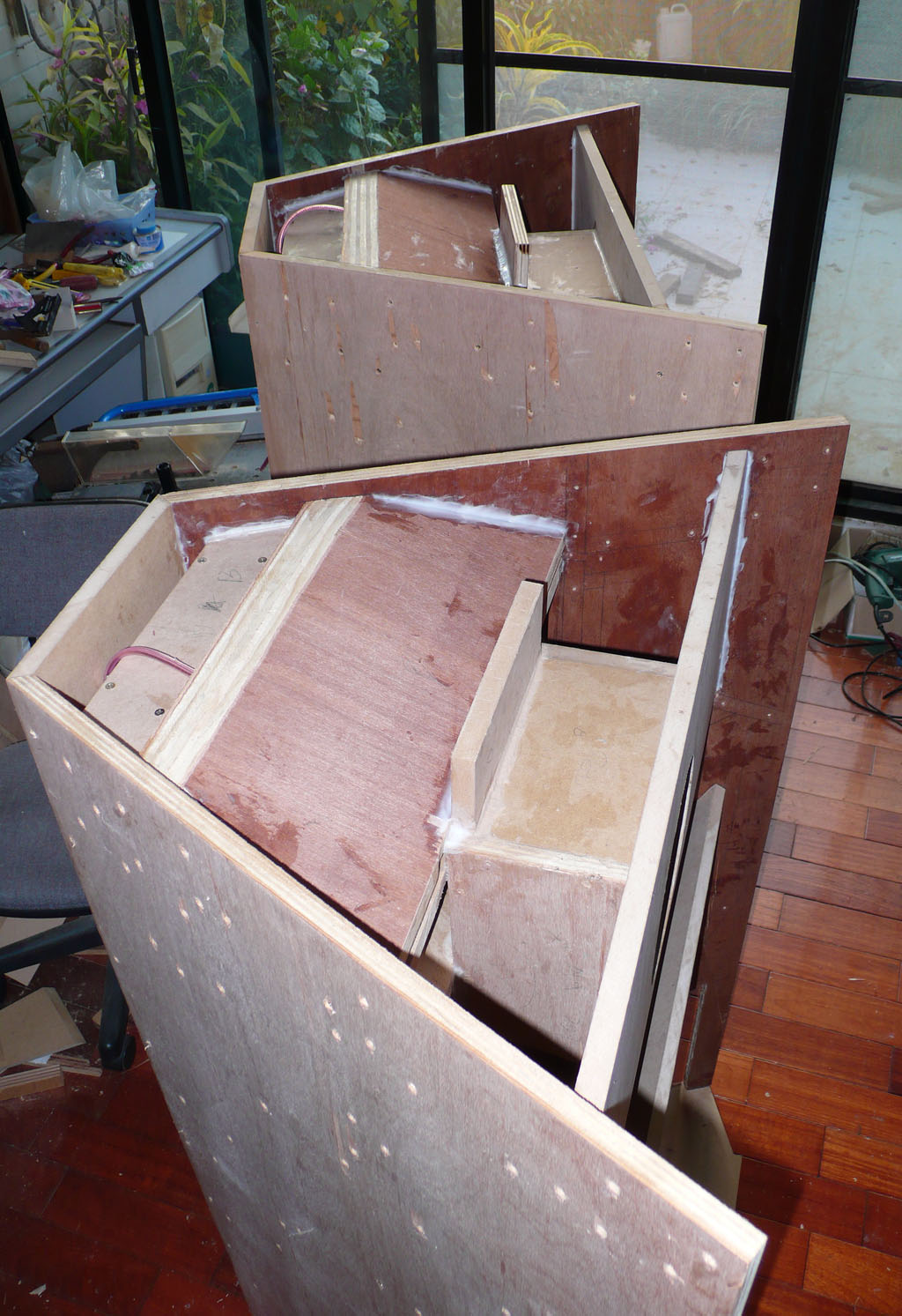

The next step is to assembly the horn mouth panels and its inner bent panel. Those panels are very big and complicated and have to mate with many panels, including of: two side panels, two front-side long panels and a front panel. The front panel 25mm, between two long front panels(not shown), also mates with lower panel of front horn. In this stage, I spent a lot time to correct errors by a scraper, and carefully pre-assembly all above panels by screws and wood sticks. The lower front horn panel and inner bent panel (not shown) need to be glued first, then all other panels are glued together in the same time quickly. I was very careful to arrange the assembly order. I don’t want finding some panel unable to put into the enclosure latter. 😡
Thanks guys for all your responses. This is really a very complicated and difficult project. However, after I listened to its sound, it is absolutely worthy of all hard working. 🙂

Lowther Opus One model B

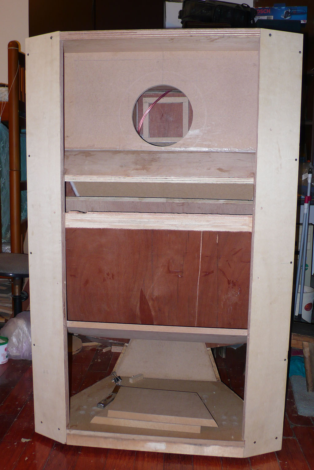

The design drawing of side panels of front horn has some errors. You can’t place them in position without correction. I wish that I could post the corrected drawing here without violating Lowther’s copyright.
I think that I don’t need all grille cloth frames on front horn, mouth and side vents. I decide to eliminate all related rebate to make the enclosure look simpler. The upper panel of the front horn and the top panel for installing grille cloth frame are modified to match smoothly as shown.
The first photo is the original design as your reference.(the upper panel of front horn is not shown)

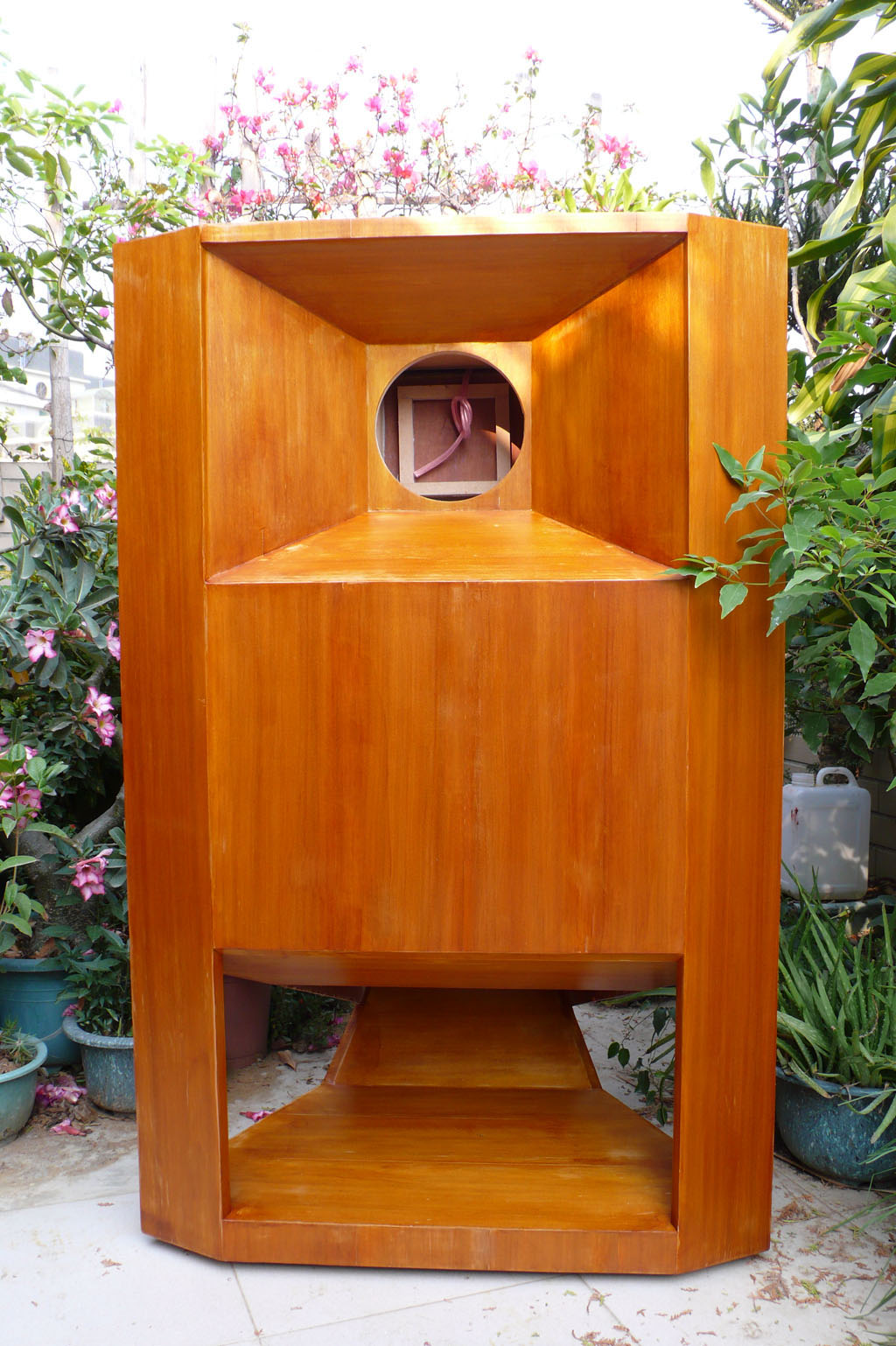

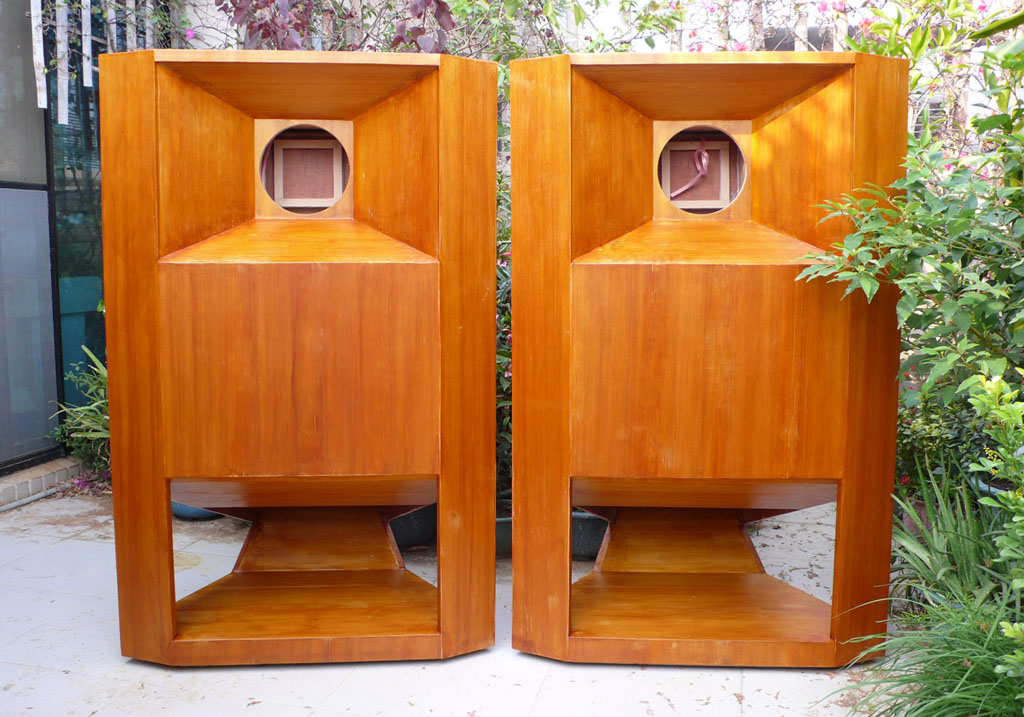

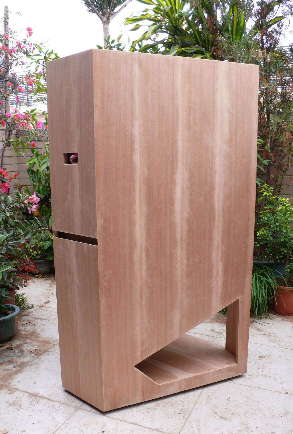

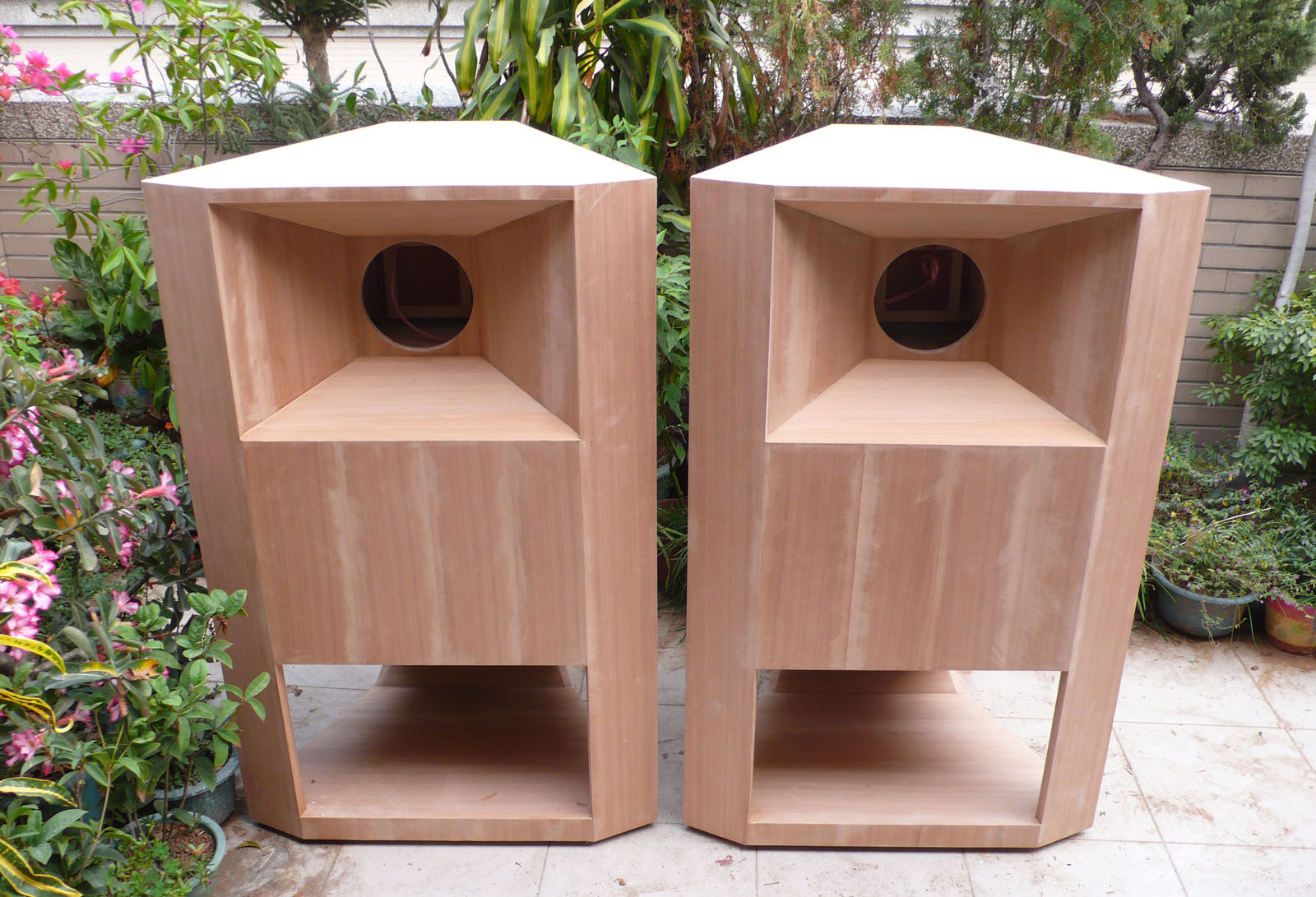

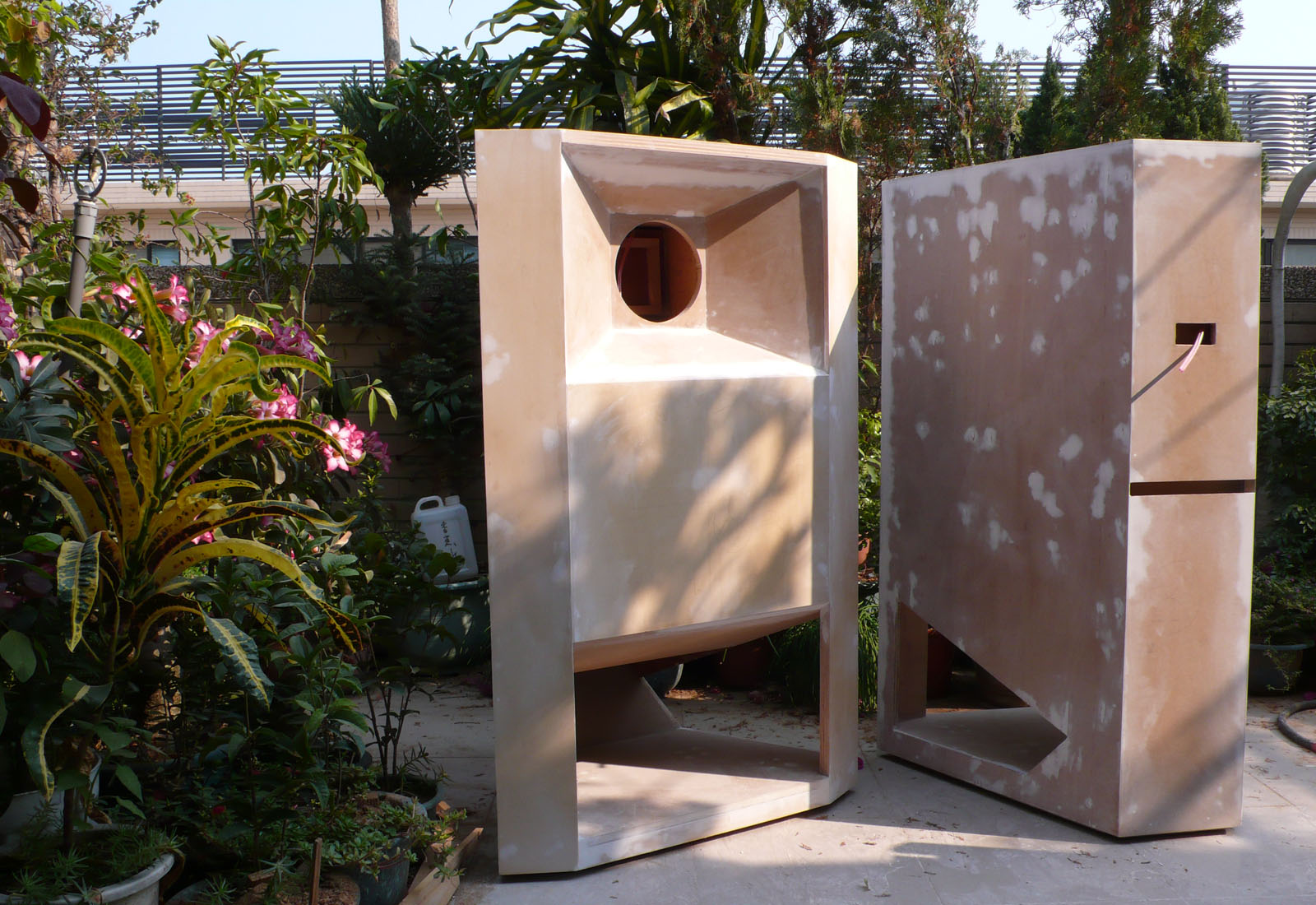

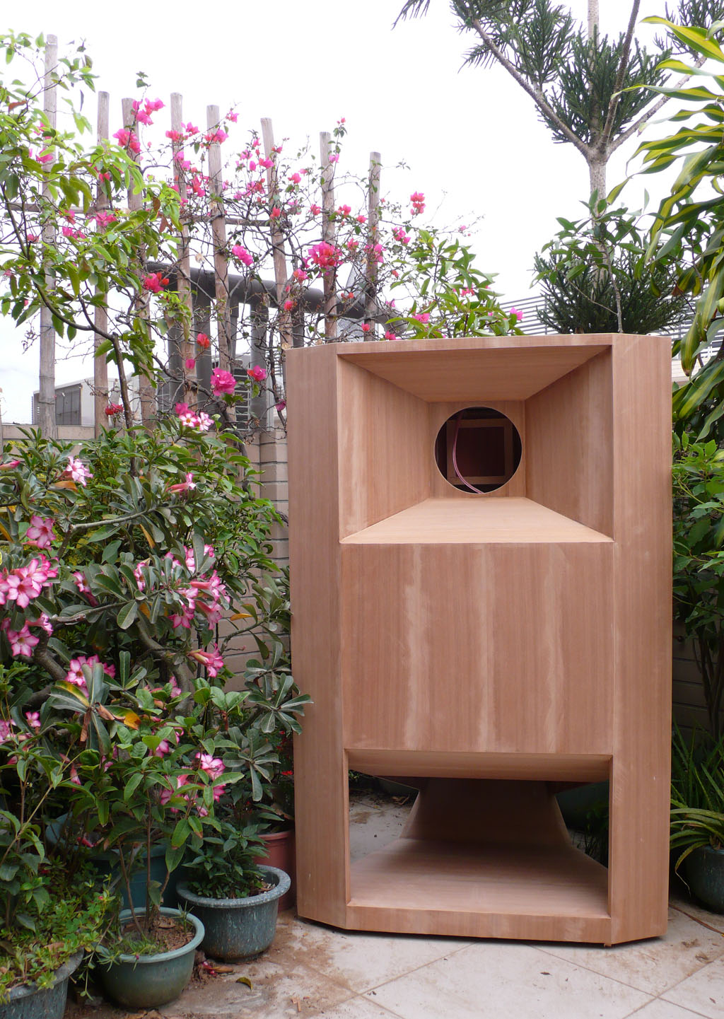

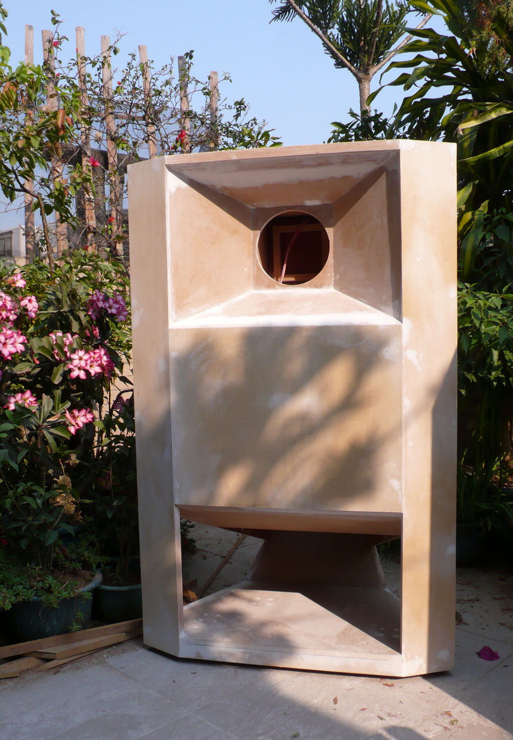

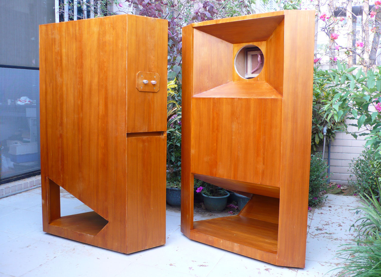

The last three steps are makeover, veneer, and painting.

Congratulations Peter,
They look great.
I do not know how long you have had them playing but do you think that the end result or all of that hard labour and effort were worth it?
Are they that much better than the other Lowther horns you had before?
Again, congratulations, they look excellent.
Andrew

Dear Tom,
Thanks your congratulations. Since you are so interested in this project; if you have two strong corners in your stereo room, I strongly suggest you make them by yourself. You should buy a 10” Bench saw first. The operating manual will tell you how to saw woods accurately. I am not a woods professional. I asked all questions to many local woodshop.
Their sound is wonderful. Their performance is absolutely worthy to build. Don’t buy or order them from shop. They are laborious to build, of course very expensive. That is why I unveil all the difficulties and secretes of this project here. I think this is not the most difficult project, and you can build them by only your two hands.
