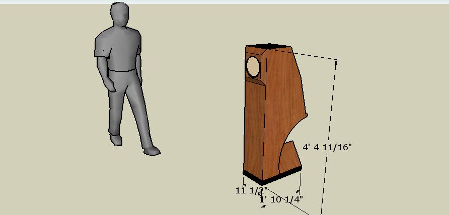

That looks cool. What would be the wall/corner loading requirements?ronc said:Something on this order.
Ron
Its actualy designed ( or that design direction) for wall loading. Its little more than a modified Austin principal with a larger mouth and side wave implementation.I am going to include a shaped low diffraction baffle as with the larger width cab the baffle can blend into the cab sides and top. The calculated dip at XO is 4 Db.
Use , with some slight juggling of CC volume, can be for the EX higher strength motor or the 206 or even the 206 super. Its basic design use is for FR lower Qts, 8" drivers.
