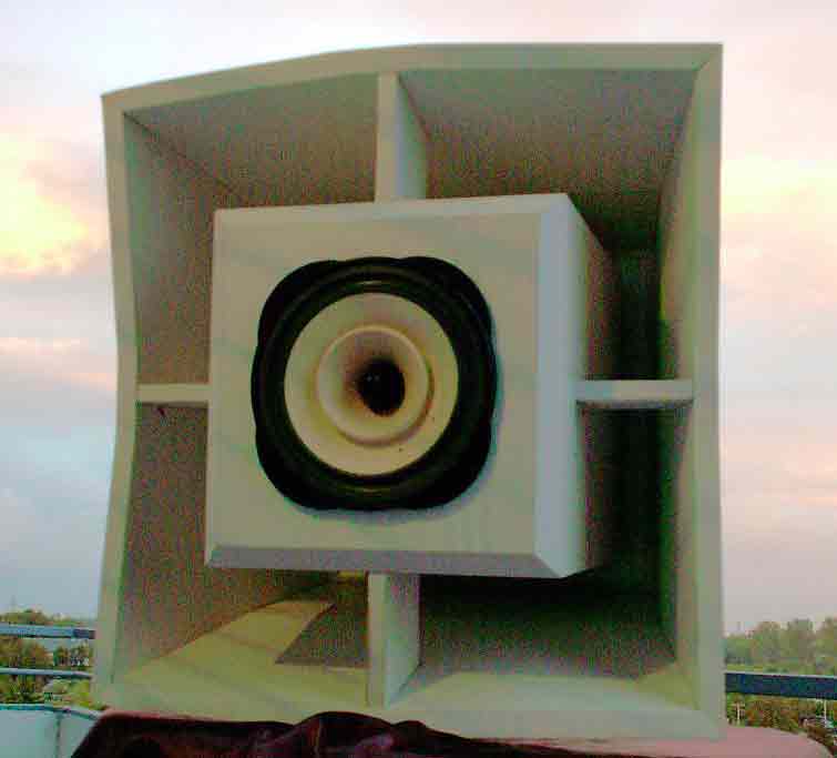

Lowther meas.
on my side are a lot of Lowther measurements
of Lowther and AN8", B200, Fe206E,
Manger, Jordan JX92
My listening experience over 26 years with
Lowther shows,
today to expensive for the sound,
less max. SPL than Navi-Membrans,
and a bad 10 kHz peak listenable,
and shown on the measurements.
search the blue "measurements" links.
Fagott, Tuba,Basstuba, Saxophon,
Trumpet, Schalmei, Horn-SAT
http://www.hm-moreart.de/30.htm
