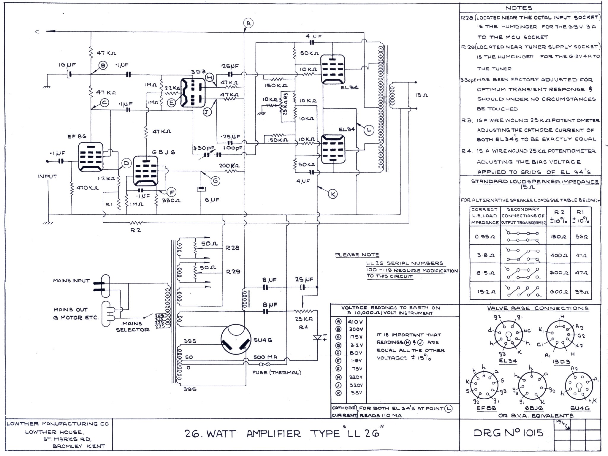

I would like to build a copy of the Lowther LL-26 amplifier. Circuit attached.
I have a few questions, if I may. Firstly, I'm in The Philippines and finding parts can be difficult however Ali Express is a gateway to all sorts of things made in China which seem quite cheap. I have been looking at EL34 push pull output transformers and all the ones I see are stated as having 4-3 laminations. I take this to mean that the primary is split into 4 sections, and interleaved with the secondary which is split into three. My old Williamson book (I had a pair many years ago) suggested split bobbins and I think a 5-4 split.
I know there are many other aspects to transformer design but my question could a 4-3 split achieve reasonable sound quality or would this transformer be a non-starter for that reason?
Some of the valves/tubes used in that circuit are a little hard to come by now. But, a 6AS7 double triode looks close in specification to a 13D3. Its transconductance is higher at 1500 umhos vs. 1200 for the 13D3. Its plate resistance is 10K vs the 13D3's 12K. Would these differences be significant in its use as a phase splitter? The 6BJ6 is hard to find here too but the older 6K7 is very similar in electrical terms so I am assuming that it would work as a constant current source.

The problem with duplicating a high-feedback amplifier is that the circuit was tuned to the original output transformers. Without them the circuit may be unstable or otherwise unsatisfactory.

There shouldn't be any trouble in substituting slightly different valves in the phase splitter and its CCS. As pointed out, an amplifier's compensation networks are tailored to the particular output transformer, but it's not difficult to optimise values by observing a 10kHz square wave on an oscilloscope and tweaking values for cleanest square wave with minimal overshoot. Obviously, if you don't have access to square wave and oscilloscope, life is a little harder, but there's not as much difference between output transformers as you might think. In short, go for it!

It uses off-the-shelf transformers that you should be able to source. A very nice little amp. Of course, with Lowthers you could always build a single-ended amp with no feedback, which makes things simpler. But the LL26 is a challenge because of the adjustable compensation network which has to be tuned with a scope.

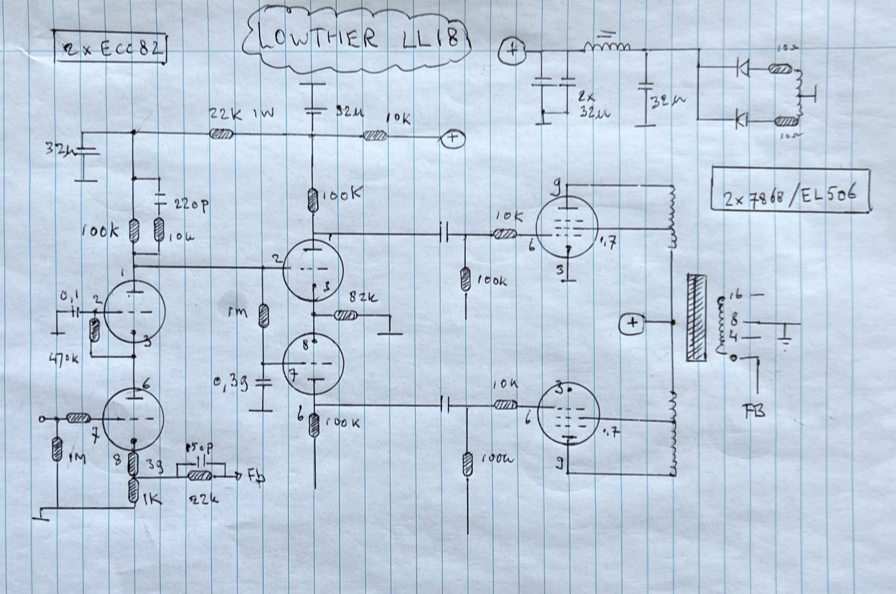

JDef: The 6AS7 (mu=2) is not a subsitute for the 13d3. You can use an ECC82 (mu=17) there or an ECC 40 (which has a mu close to that of the 13D3);
An other possibility might be to use the schematic of the LL18 (which I have). A cascode ECC82 is directly coupled with a Schmidt fase splitter and the following EL34's are hooked up the same way as in the LL26. Lowther uses the same outputs as the Leak (ultralineair). You can find the schematic on the net. Actually I don't like to steer you in a different direction but the ECC82's are easier to find (if you don't already have those) and it's still Lowther what we are talking about here.

I only have a hand drawn copy. As it's incomplete (the power supply voltages are missing). Tomorrow I will take the amp from the shelf and power it up to see what the voltages are. If you mail me your address through direct mail I'll draw a better copy and send it to you.
