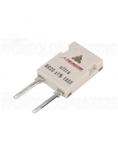

You are right, one can use higher quality parts for the parallel notch filter, air coils with even less resistance, MOX or Mundorf MResist resistors or even more expansive capacitors. I would agree replacing the budget ceramic resistor with e.g. a Mundorf MResist classic for a few extra Euros might be more adequate just to be safe. Anyway I am still very happy with the result and a direct A/B comparison doesn’t show any negative side effect of the simple filter. As usual it is a price vs. performance question, maybe the eventually existing extra inductance of the ceramic resistor is not so critical in this use case since high frequency will bypass via the capacitor. Meanwhile also Lowther offers a so called "Phase & Frequency Response Compensation Board" in two quality levels, haven't tried this out so far.
