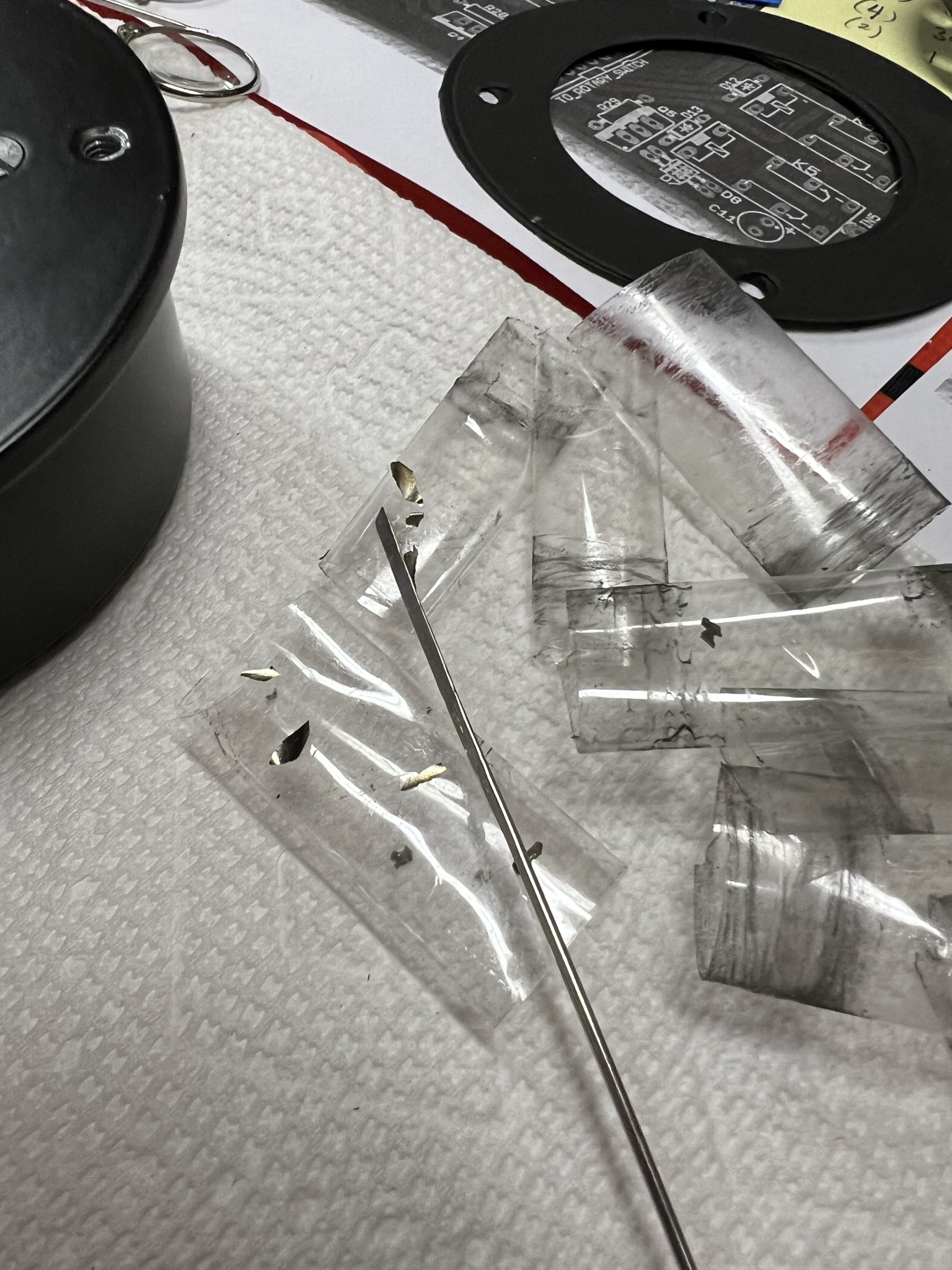

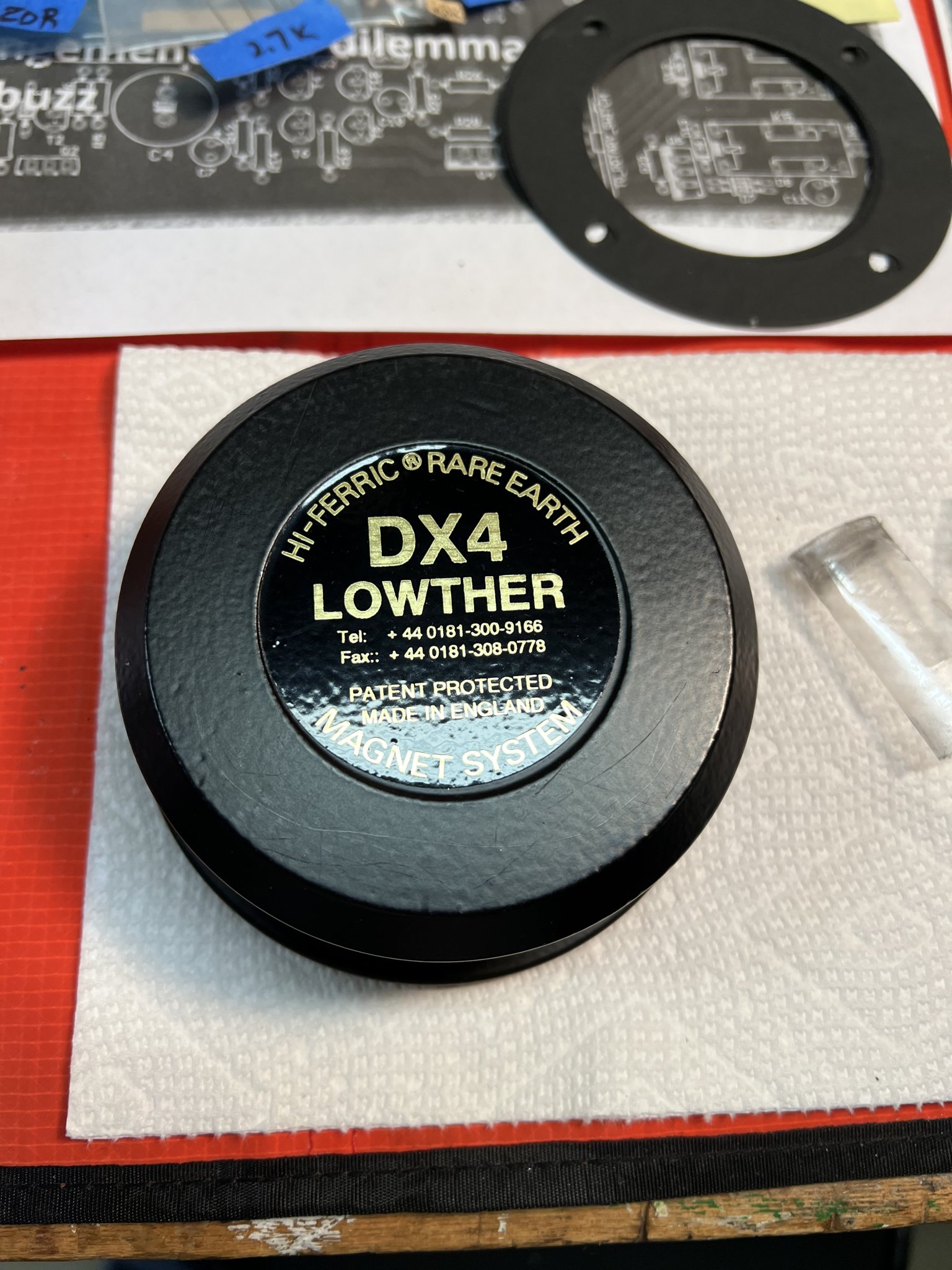

I figured I’d post here for some feedback since this is DX4 related.
I’ve not made much progress on a Lowther field coil project I started gathering bits for since I relocated to a new house last Fall…surprise!
My impatience got the better of me when I came across a used pair of DX4 for sale cheaply.
They were fairly local and advertised as one driver needing a voice coil realigned. I thought I’d give them a try in the mean time since I only ever used DX3 drivers before and had read the DX4 was a step up.
Well, I got my hands on them and there seems to be more issues than a mis-aligned voice coil…surprise again!!
I couldn’t get rubbing to go away in the voicecoil of the one driver no matter how much I fussed with it.

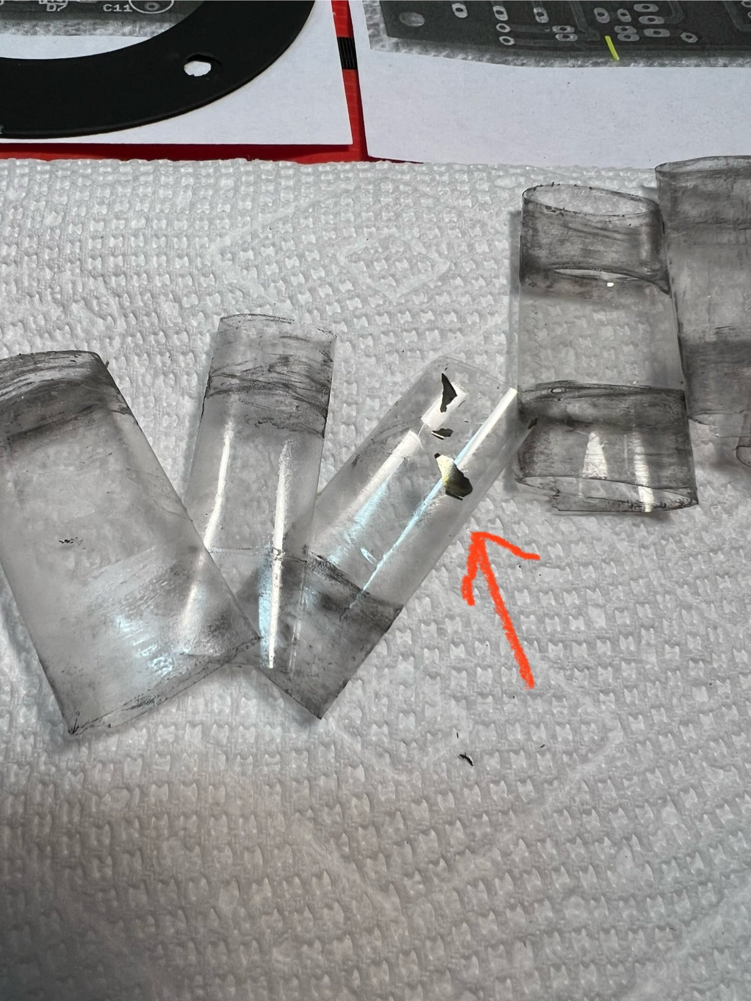

After I examined it more closely with a loop it became clear that there was debris in the magnet gap.

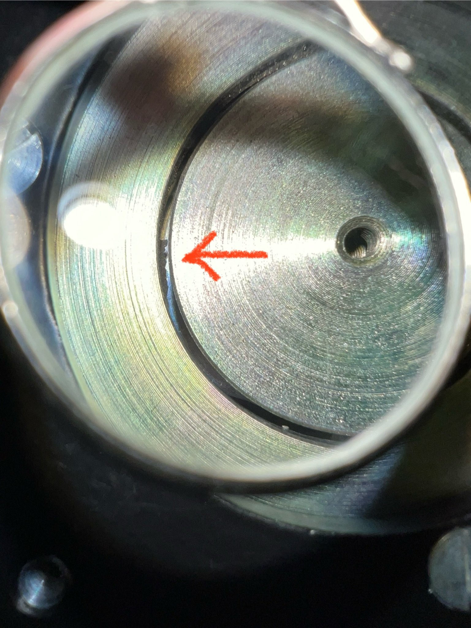

Upon removal of the magnet to clean the gap I discovered things were a bit worse.
It appears that the yellow cadmium style plating that is on the magnet extends into the gap…and it is delaminating there.
I have already pulled out a few large flakes of it along with a bunch of fine grey grit and dust (see pics).
I let the seller know the situation and they have offered the option of returning them for a refund or keeping them for parts to tinker with.
I’m not sure if it’s possible to clear the gap on the magnet…or if the full depth of the gap actually needs to be clear?
The only other idea I had was to try taking the magnets off of a pair of PM6A drivers I have that need surrounds and transferring them to the DX4 frames/cones which at least appear to be in decent useable condition.
Neither pair of speakers were very expensive…especially since the seller offered to give me money back if I want the DX4 for parts.
Is it possible to swap the magnets like this between the DX4 and PM6A and then re-align the coils? Both drivers appear to have the same 4 bolt pattern.
The PM6A were not originally a pair anyway. They don’t match closely like the DX4 when I measure their impedance either.
If this would work, I could at least have one good useable pair of drivers.
I am wondering whether I will have an issue with the paper shims that go between the basket and magnet assembly. It seems like they are necessary to get the voice coil to the correct depth in the magnet gap. I can’t find any detailed information or instructions regarding them.
In the end, I could just use the frames from the PM6A to mount new cones with surrounds that I bought from ghemml and build them into the field coils I want when I have my workshop set up and can continue with the electro magnet machining.
Any feedback or experience and enlightenment on the situation is appreciated.

I don't know enough to be of help but if the other unit still worked acceptably, you might try mono or up-firing omni (too late to try that on the disassembled unit?). For me, one PM2A required rotation and one PM6A got its unprotected inverted-surround cut and rubbed after white-glue repair.

couldn't thorough work with sand paper help cleaning the gap and finishing with a vacuum cleaner?
Thanks for the responses.
I’d like the results of my efforts to be a stereo pair of drivers.
I have read Lowther’s “Maintenance” document for dealing with rubbing voice coils.
They provide advice for removing debris from the gap with folded sticky tape and the like.
Using sandpaper would probably result in a lot more metal debris in the gap to remove.
No guidance for the situation I’m describing with plating delaminating is offered in the Lowther document.
I made myself a tool out of some stainless steel welding rod by hammering it’s end out on a vise/anvil into a blade thin enough to be able to insert down into the gap and try to remove pieces of the plating that are loose or protruding into the path of the voice coil former by scraping them off and towards the top of the gap where I can grab them with tape.
It’s slow tedious work and I’m not convinced it’s possible to really get it all out simply because of the shelf that is formed by the top plate near the top of the gap.
I have tried blowing out the gap with compressed air at 120PSI from my shop compressor. Dust came out on the first attempt.
However further examination with a loop revealed that the larger metallic particles cling to the sides of the gap and just sort of slide around when blasted with air. A vacuum just wouldn’t have the power to remove them.

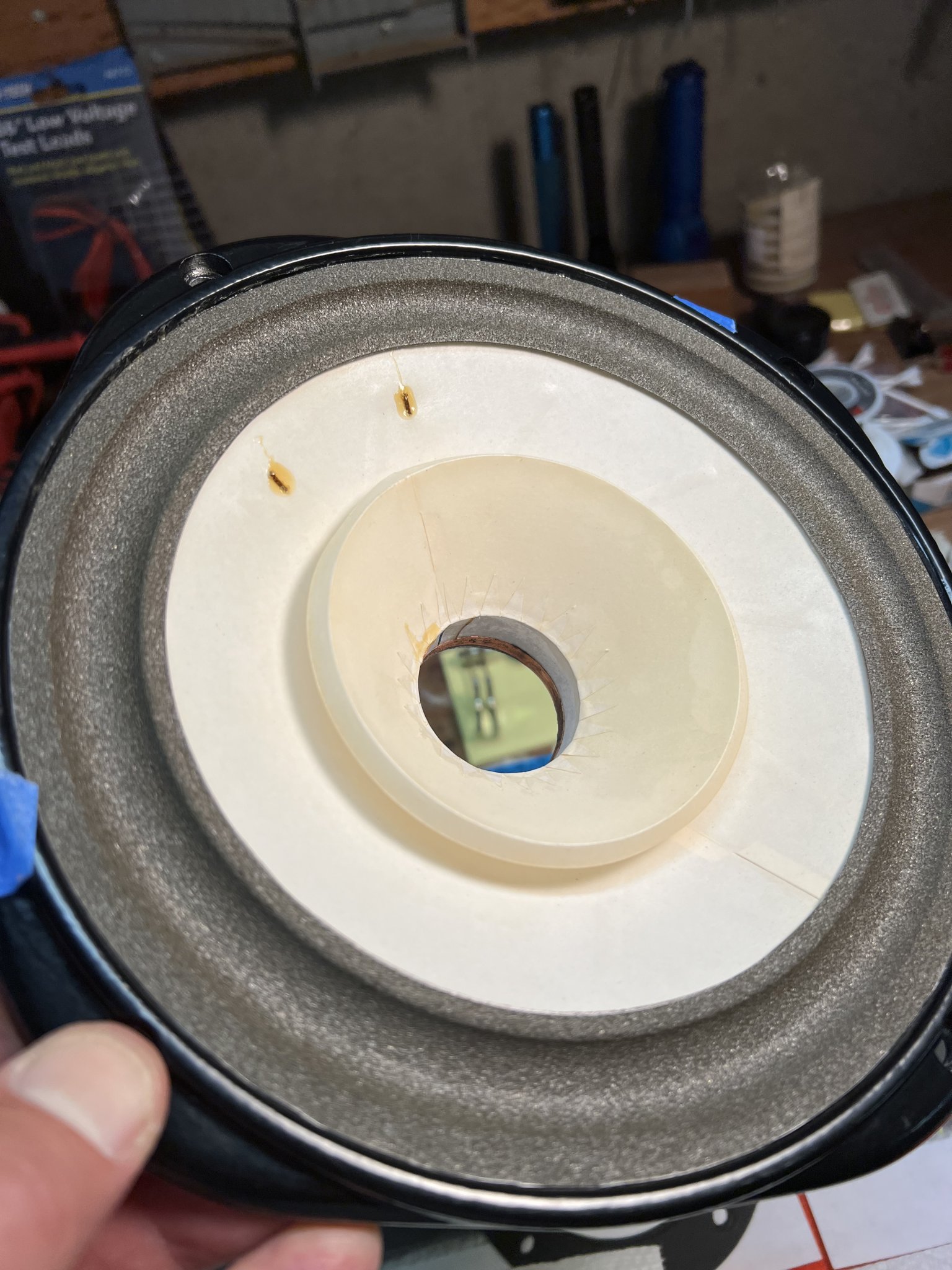

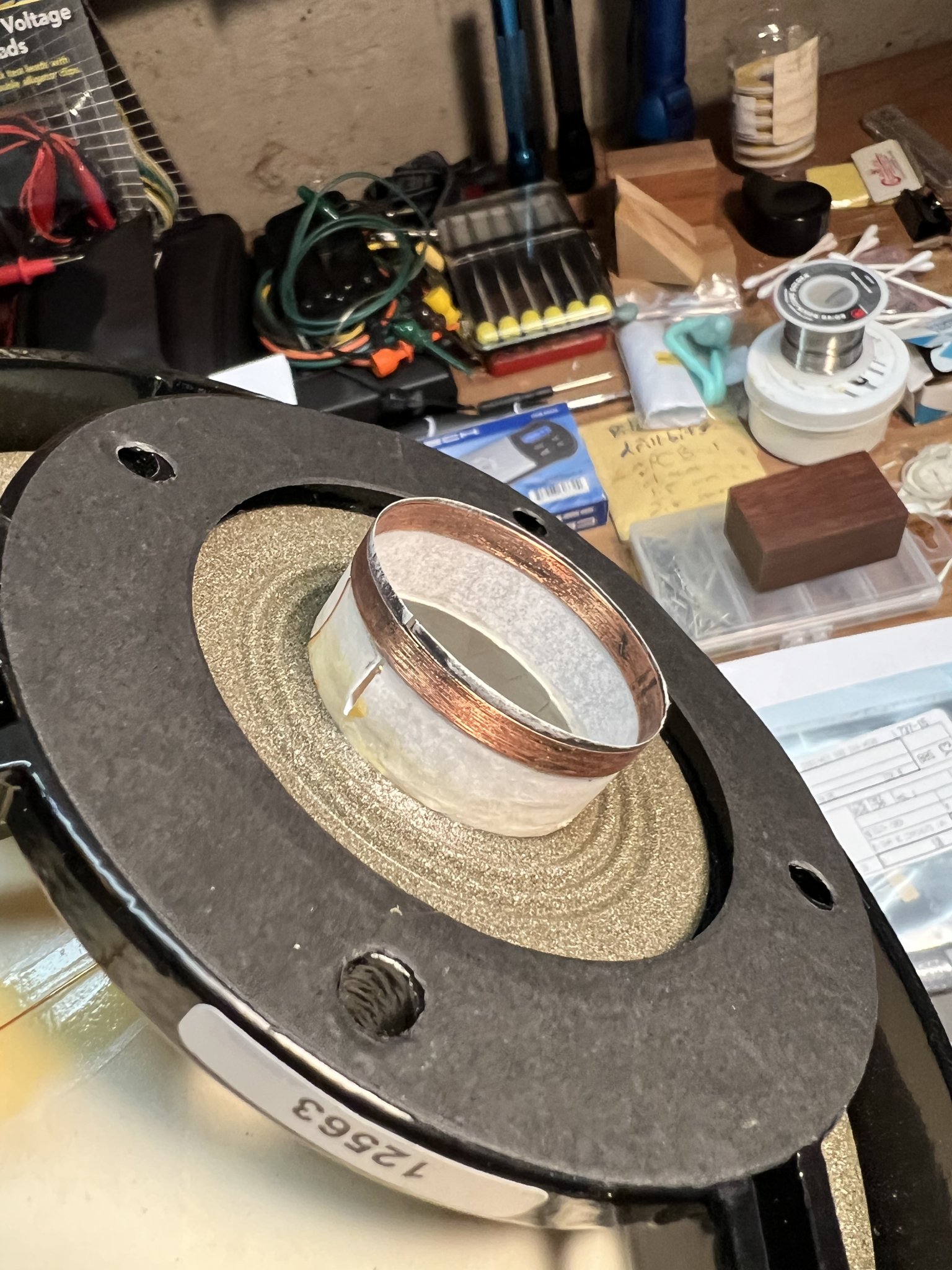

Well I spent another afternoon scraping and cleaning out the magnet gap as best I could with my little stainless tool, tape and compressed air until my compressor broke again 😒
Then I tweaked the voice coil former a bit by hand because it looked a little out of round.
Figured I would try putting it back together and see what happens.
It appears to be aligned and working properly.
I used a tone generator App and a cheap eBay chip amp to play a 20 Hertz tone through it loud enough to make the cone pump back and forth almost 1/4” and I don’t hear any rubbing.
No idea how long it will stay that way.
If more stuff comes loose in the magnet and binds up the voice coil gap again I’ll have to disassemble it and do the same thing all over again I guess.

This is a common issue with Lowther voice coil coated with Magnetic Primer. They will flake off and get trapped in the magnetic gap.
What I suggest is the use masking tapes rather than clear tapes that you posted in your photo. Use masking tape that is 10mm wide with a plastic wood filler spreader which I got from Daiso
Need lots of time patience
Thanks for the tip…I’ll try that in the future if I have to do the same process again.
I’m wondering if I should examine the gap of the second driver. I haven’t tested it yet with any kind if signal. I didn’t observe any rubbing issues when I tested it by hand. If it ain’t broke don’t fix it?

Have you asked lowther about the problem? I would send the magnet back to be exchanged for new one. This is clearly desing flaw.Thanks for the responses.
Any guidance concerning interchangeability of DX4 and PM6A magnets in case I need/want to do that in the future?
Also…the question of the paper shims between the magnet and frame. Are they there to shim the voice coil to a specific depth in the gap?
Perhaps they just facilitate easier centering of the voice coil by providing a release between the surfaces of the magnet and basket?

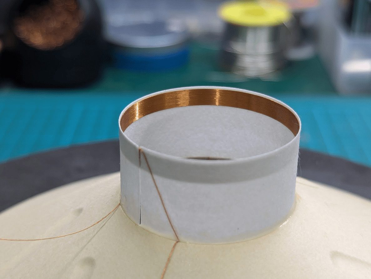

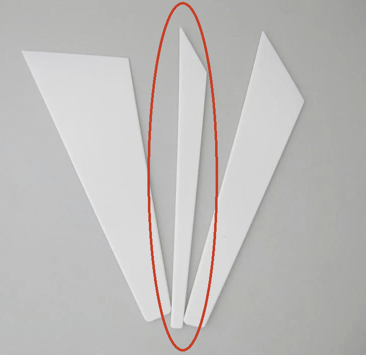

PM6A and DX4 voice coil former height is roughly about the same, around 16 to 17mm tall. The only model that has short voice coil former is the ceramic series.
The shims used to keep the voice coil in the gap within 0.5mm. Voice coil should not be out by more than 2mm or 3mm, this will cause distortion when you have low freq input.
For centering of the voice coil, the older models, have 1mm gap which can be a headache to center it. Newer models Lowther start to make the gap 1.2 to 1.3mm which helps a lot in the alignments. But I recommend using a signal generator with a single sine tone using 50hz or 60hz. Increase the volume until you start to hear the flapping sound, then slowly tighten the bolts diagonally.
Thanks for sharing all that information regarding the voice coil, shims and gap. It will be very useful when I start working on the PM6A drivers.
