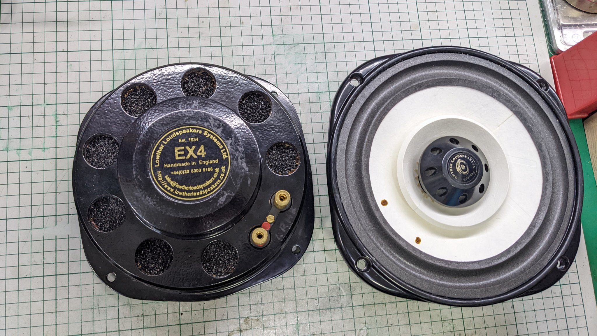

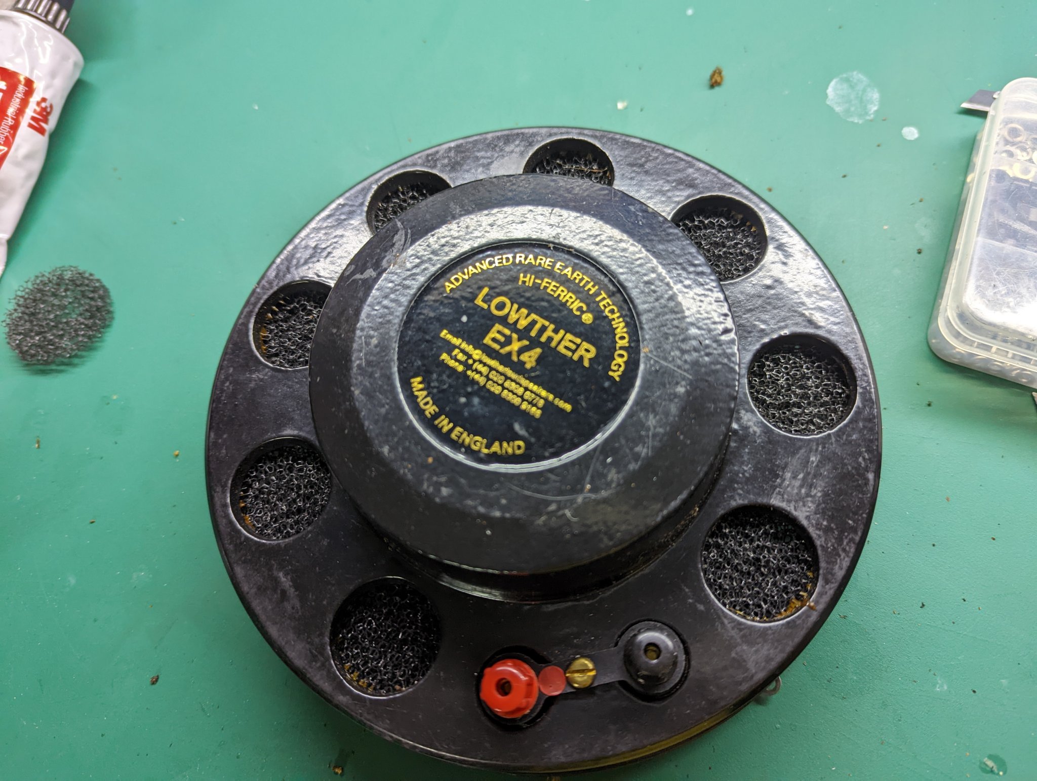

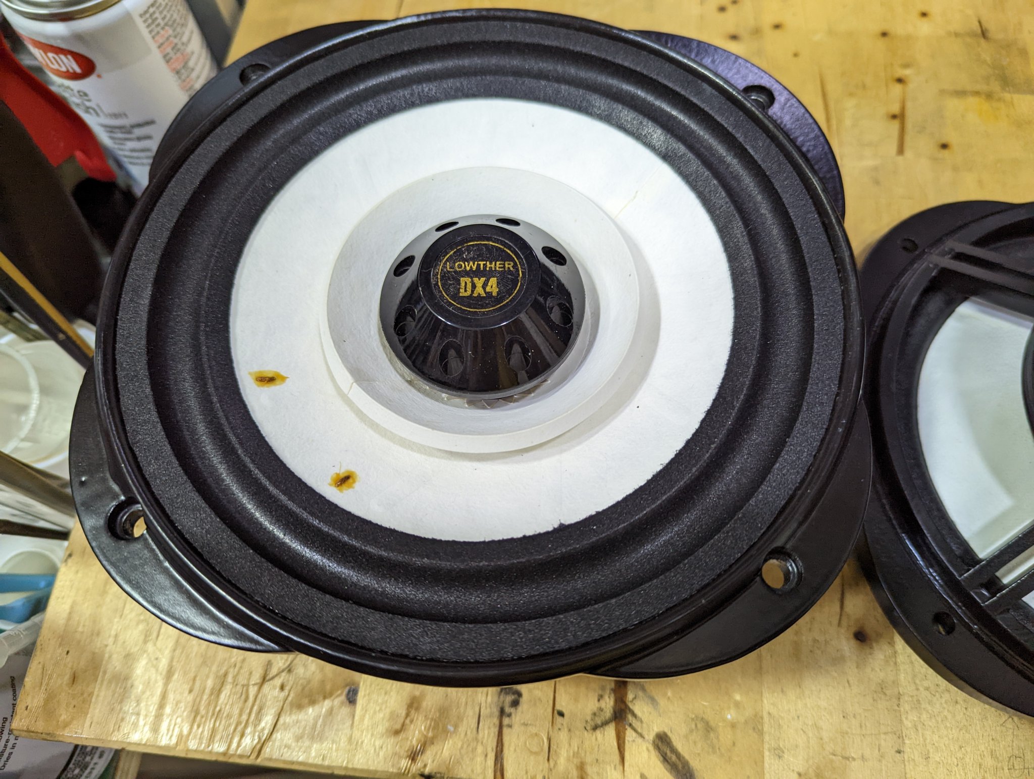

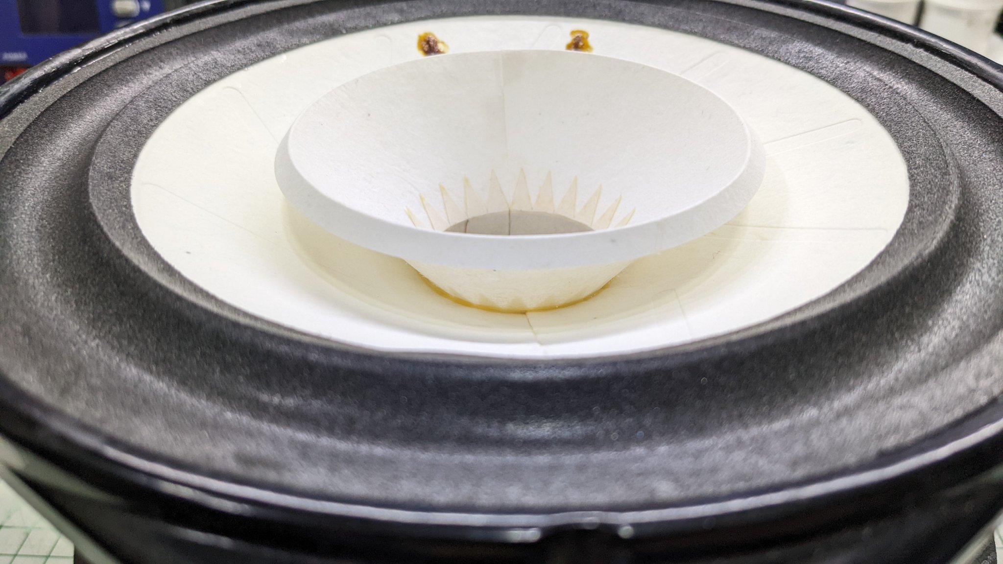

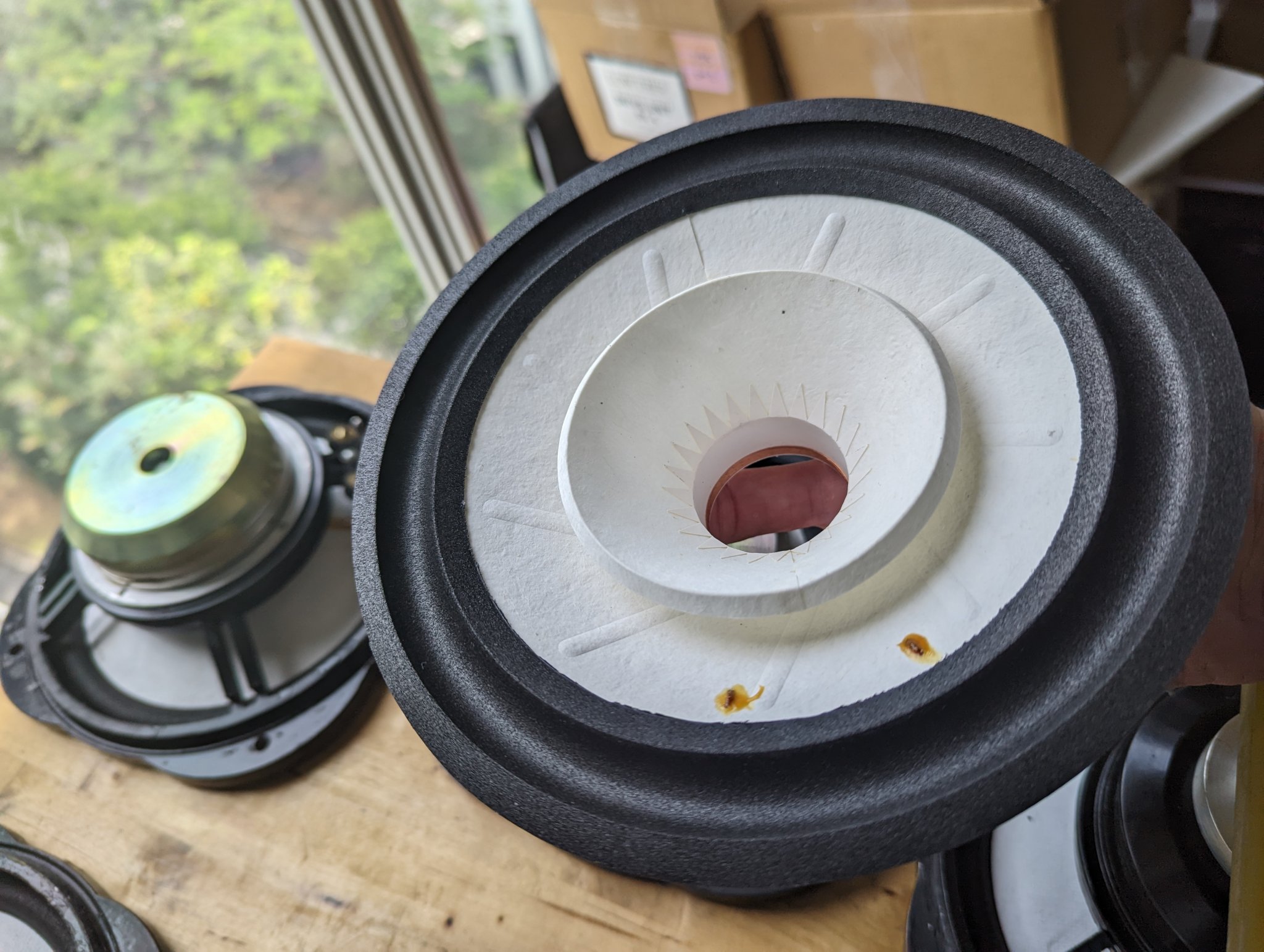

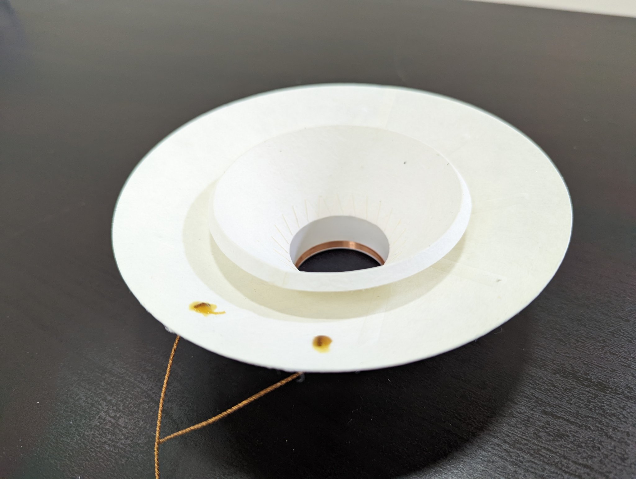

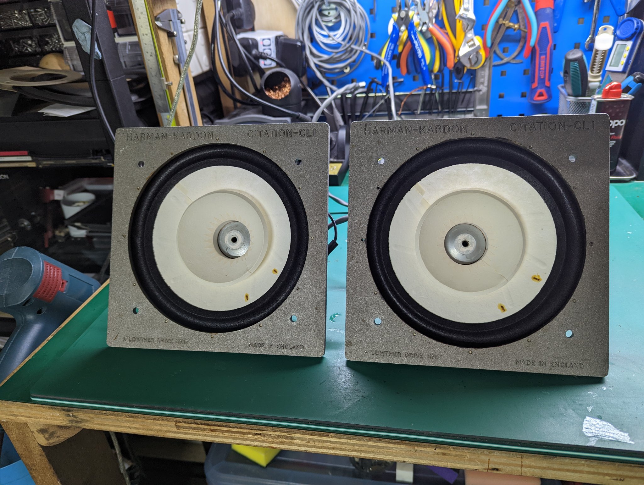

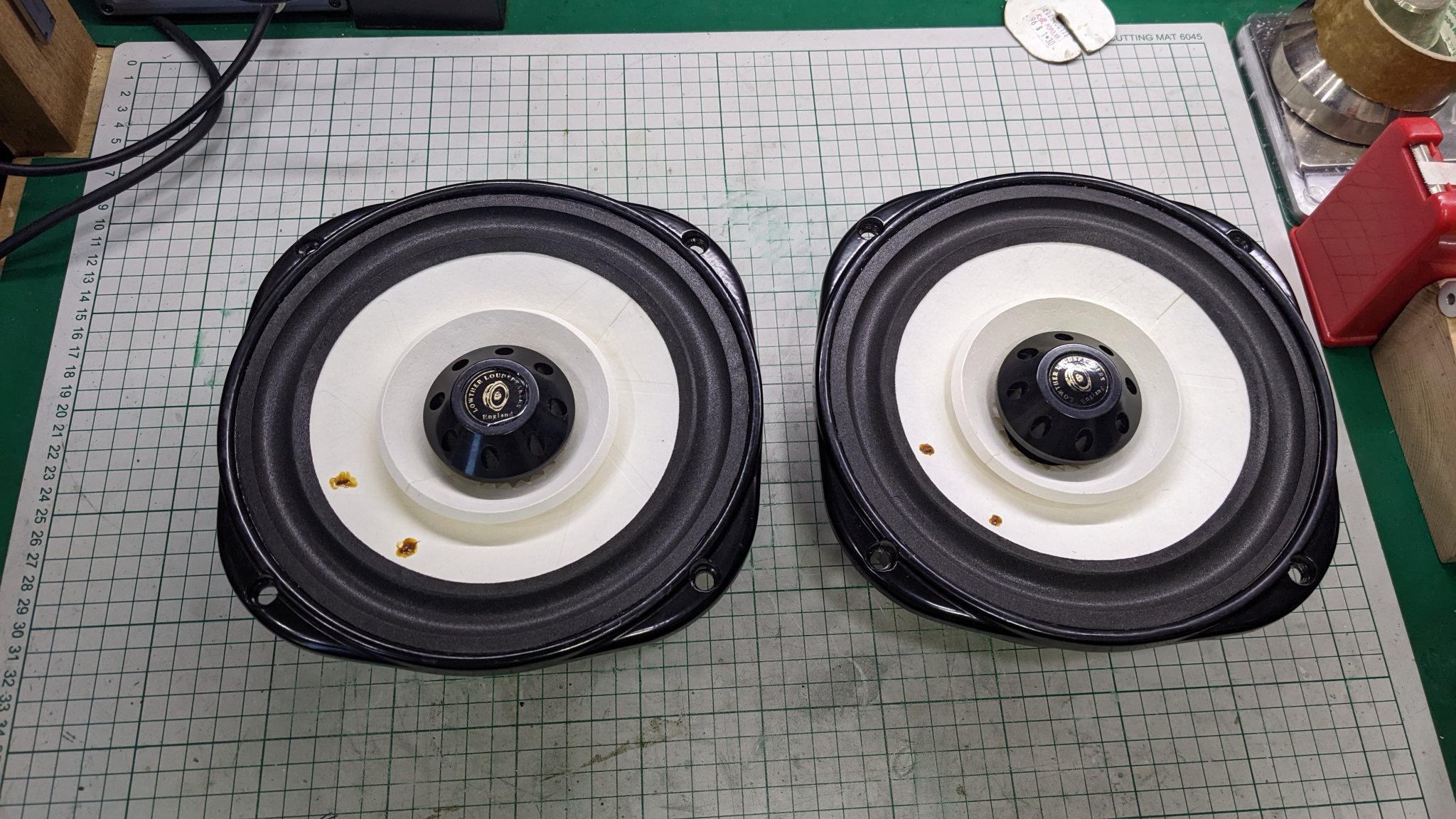

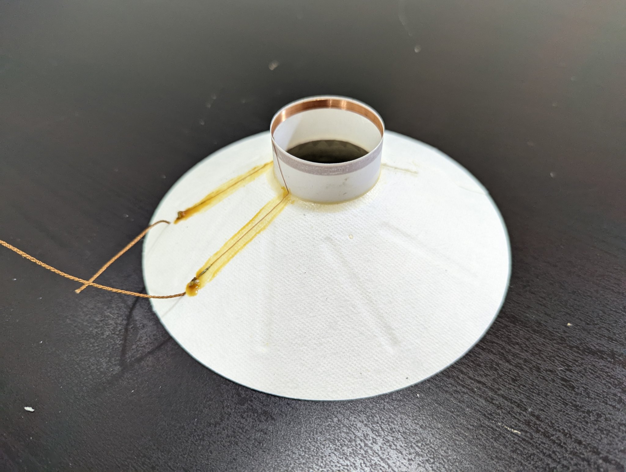

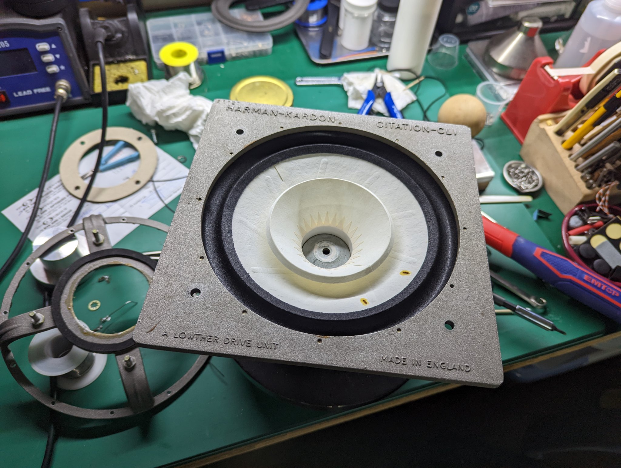

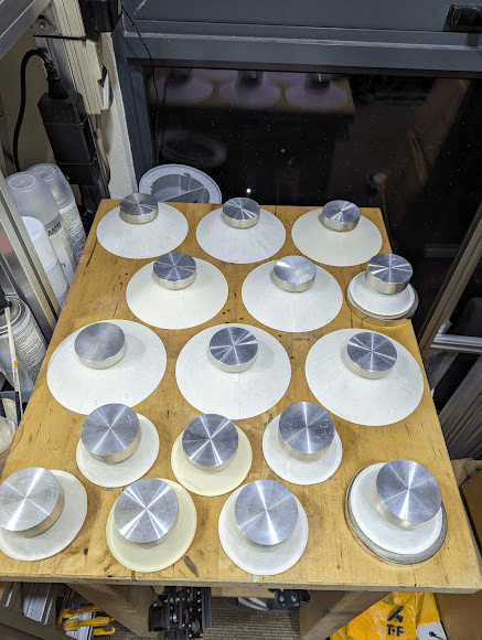

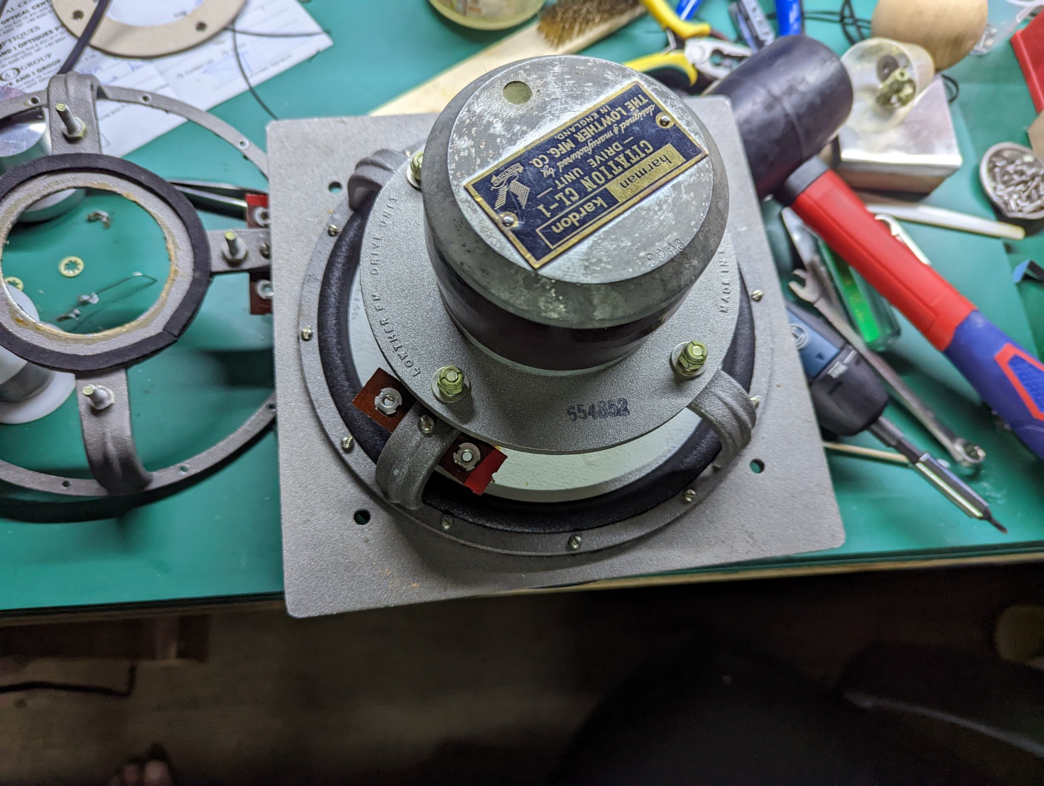

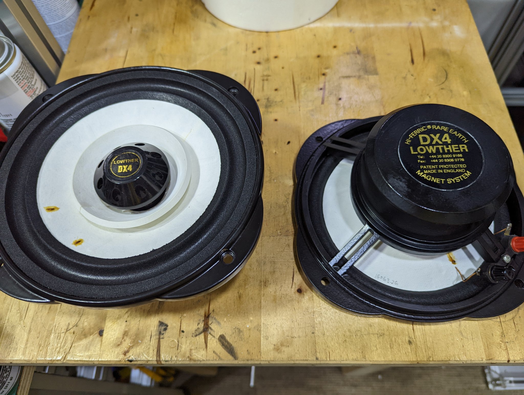

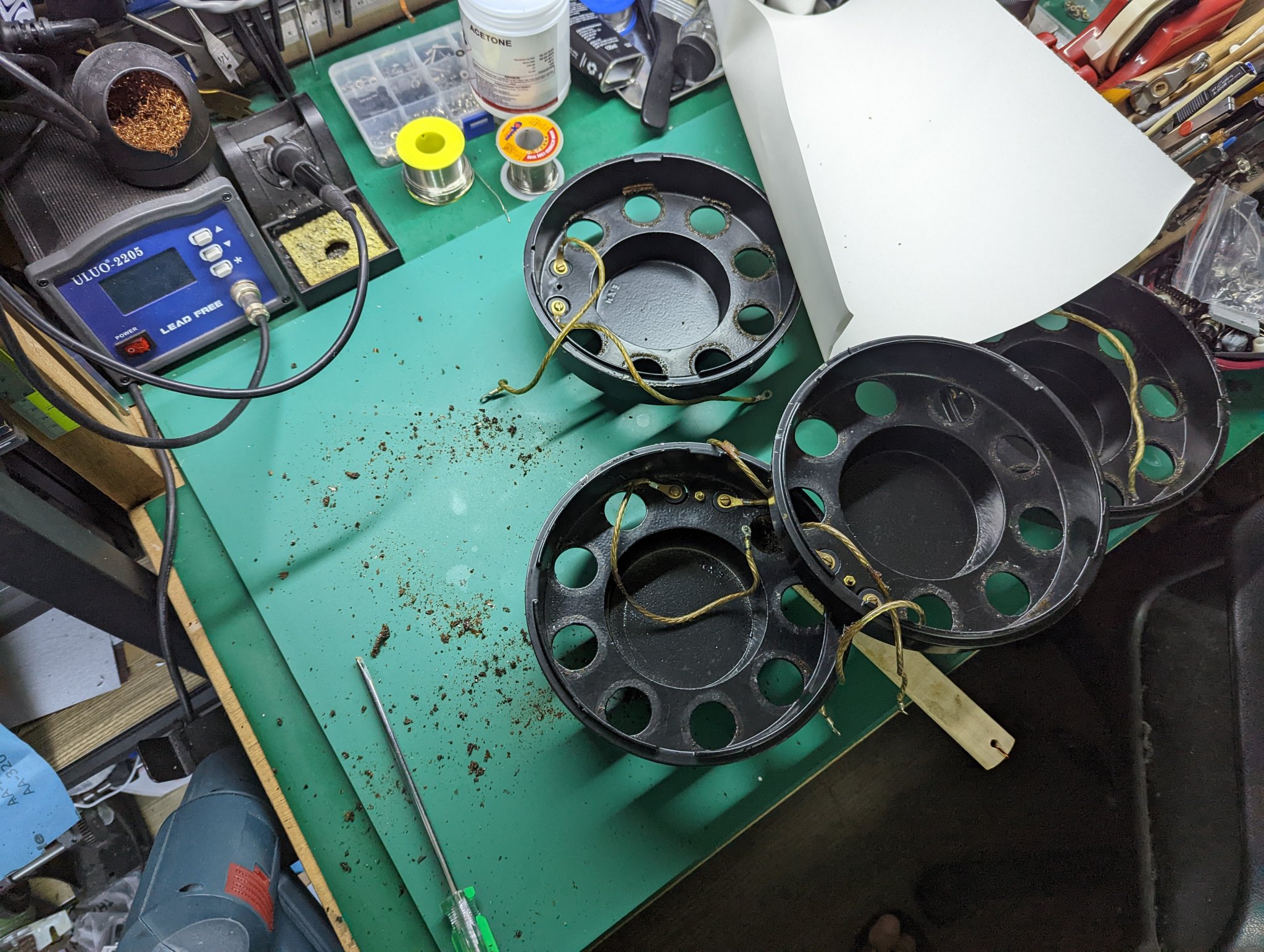

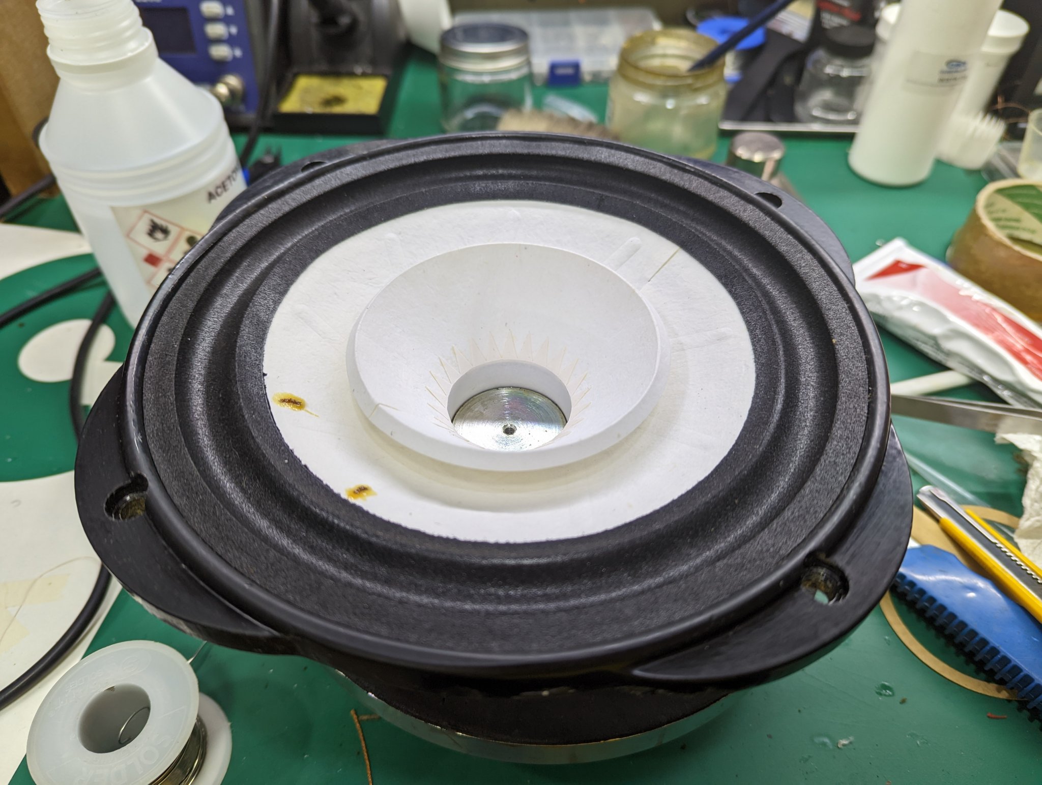

One of my latest rework on a pair of Lowther DX4. The cone, voice coil, damper(Spider) are all custom made by me.

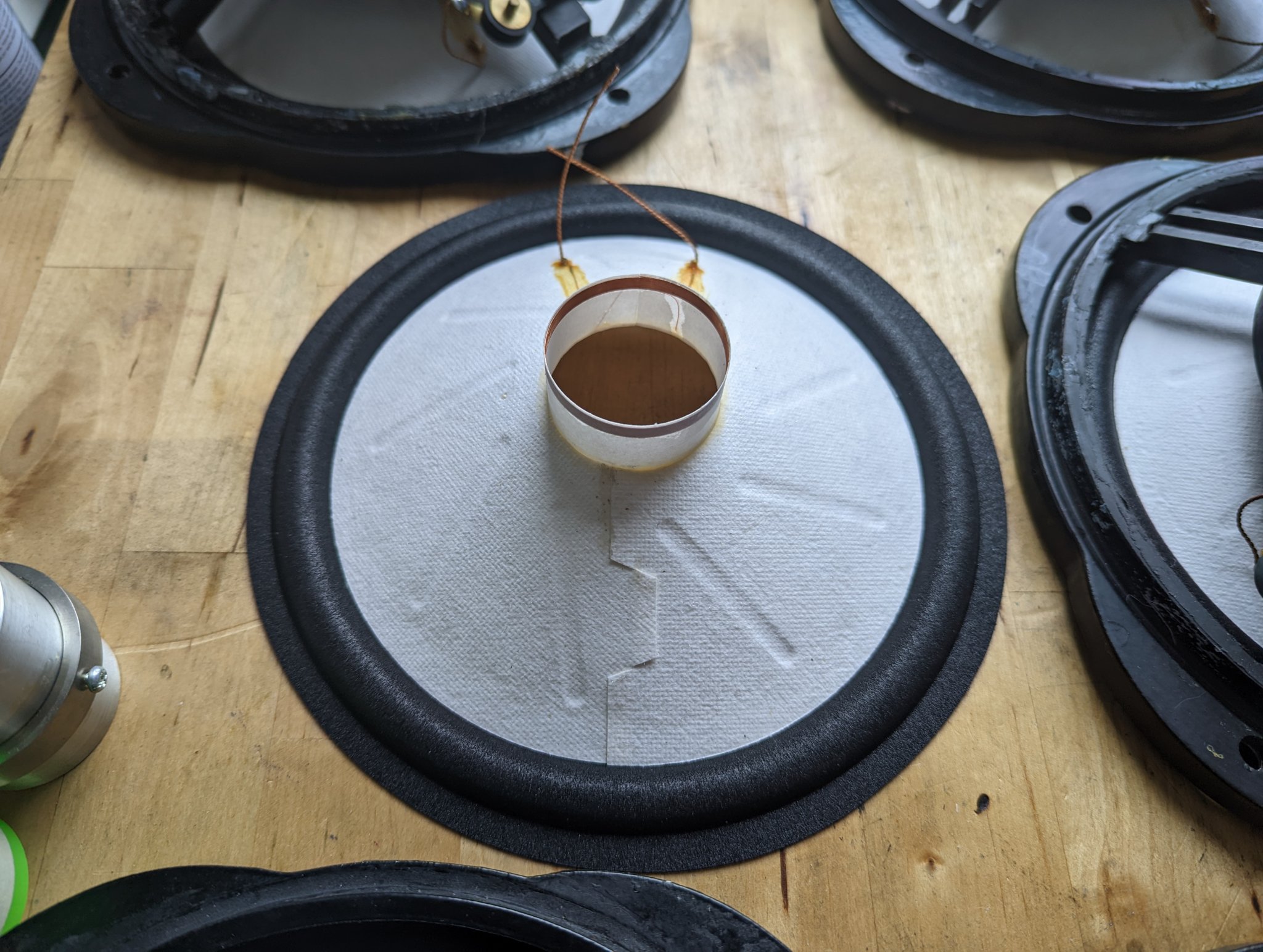

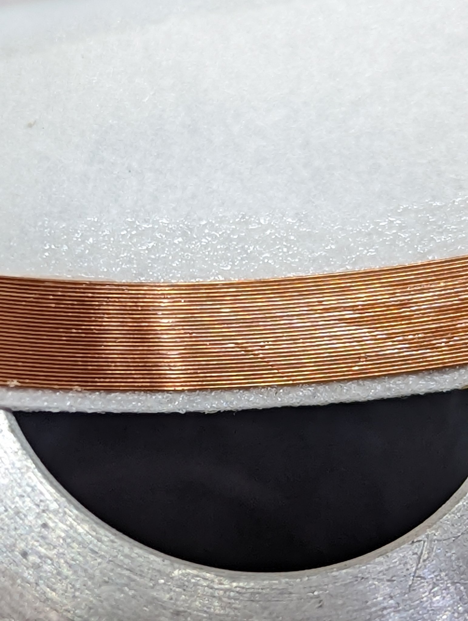

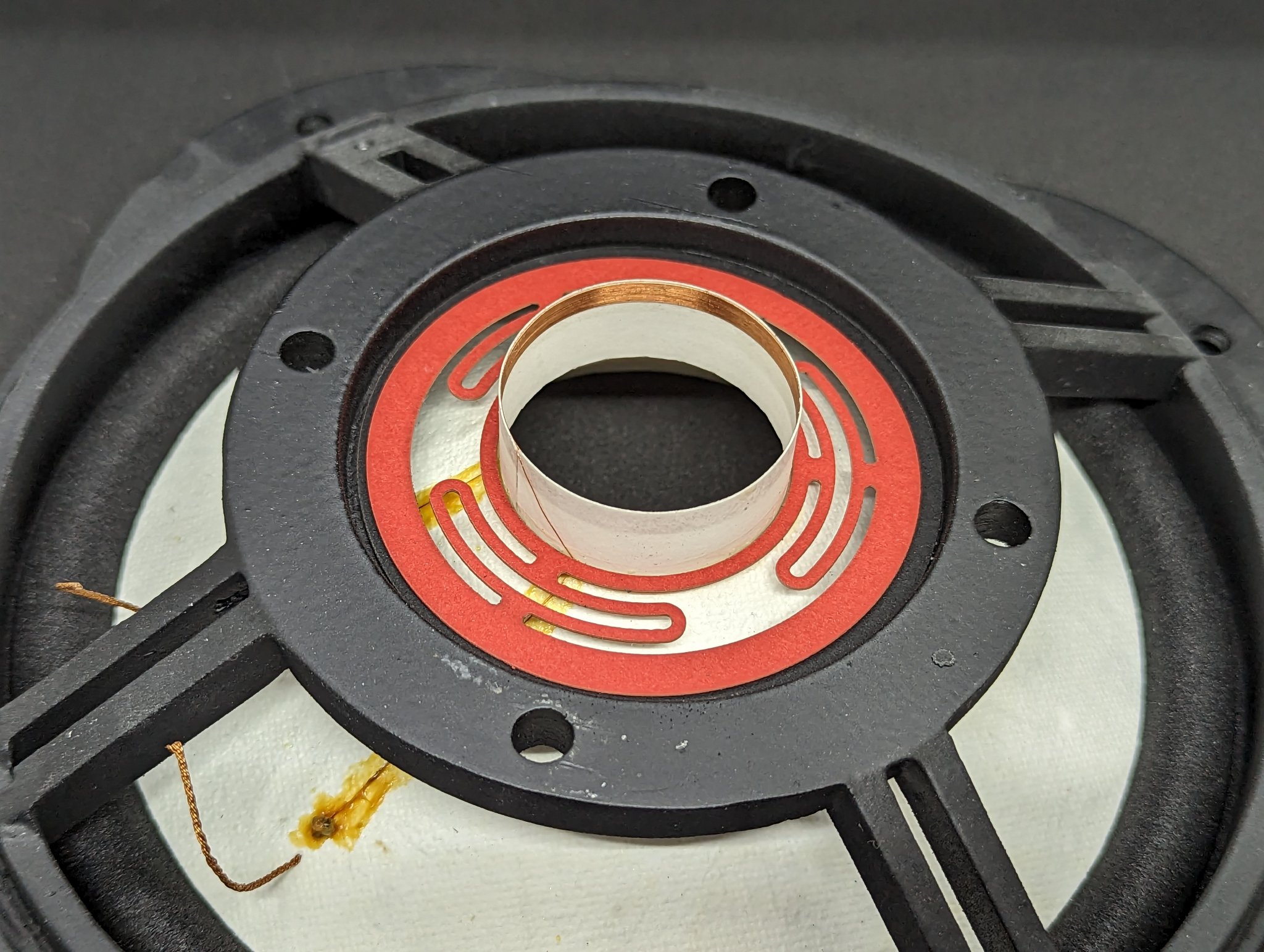

Voice coil wire: Copper Clad Aluminum (0.13mm x 27 turns)

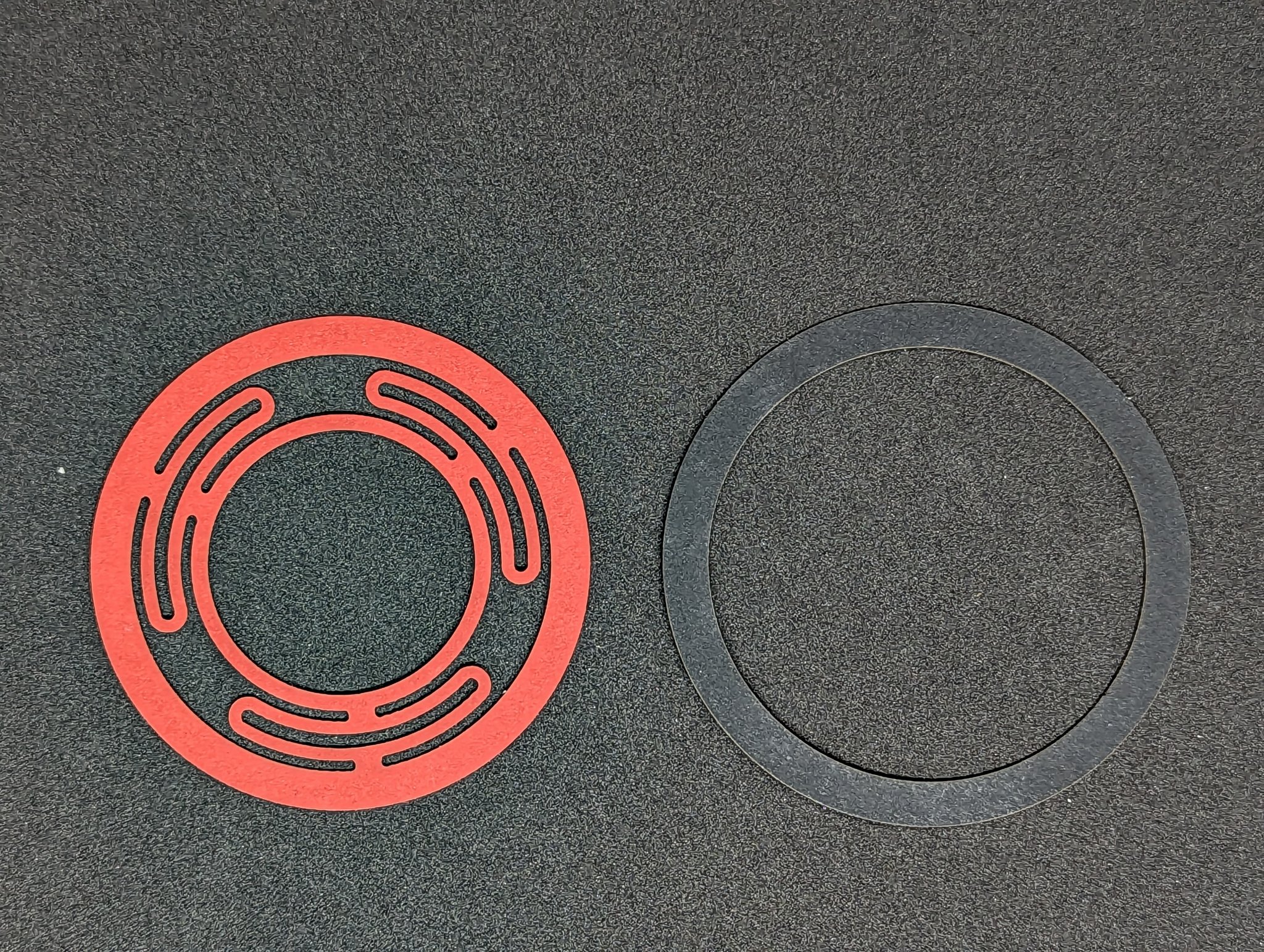

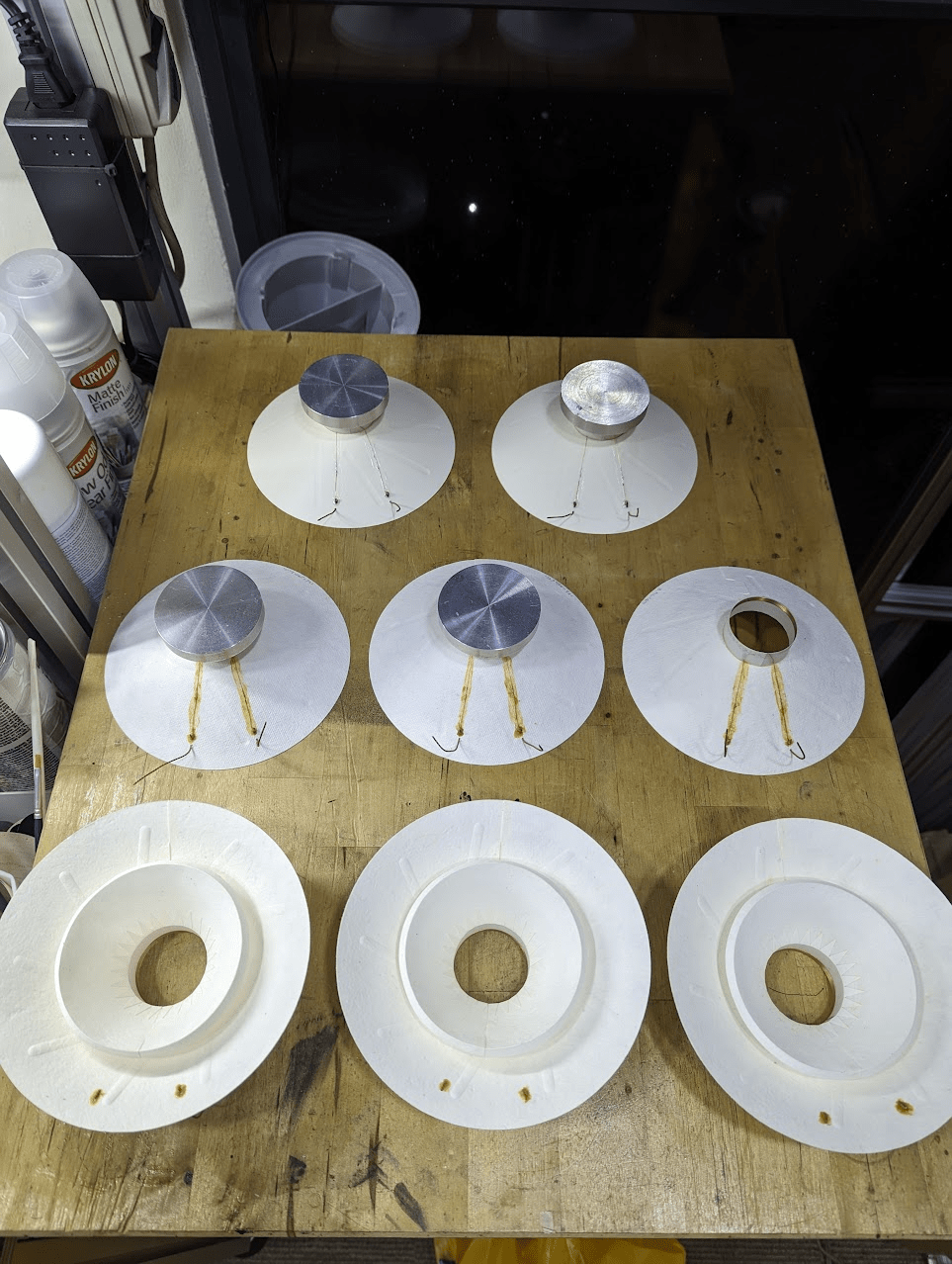

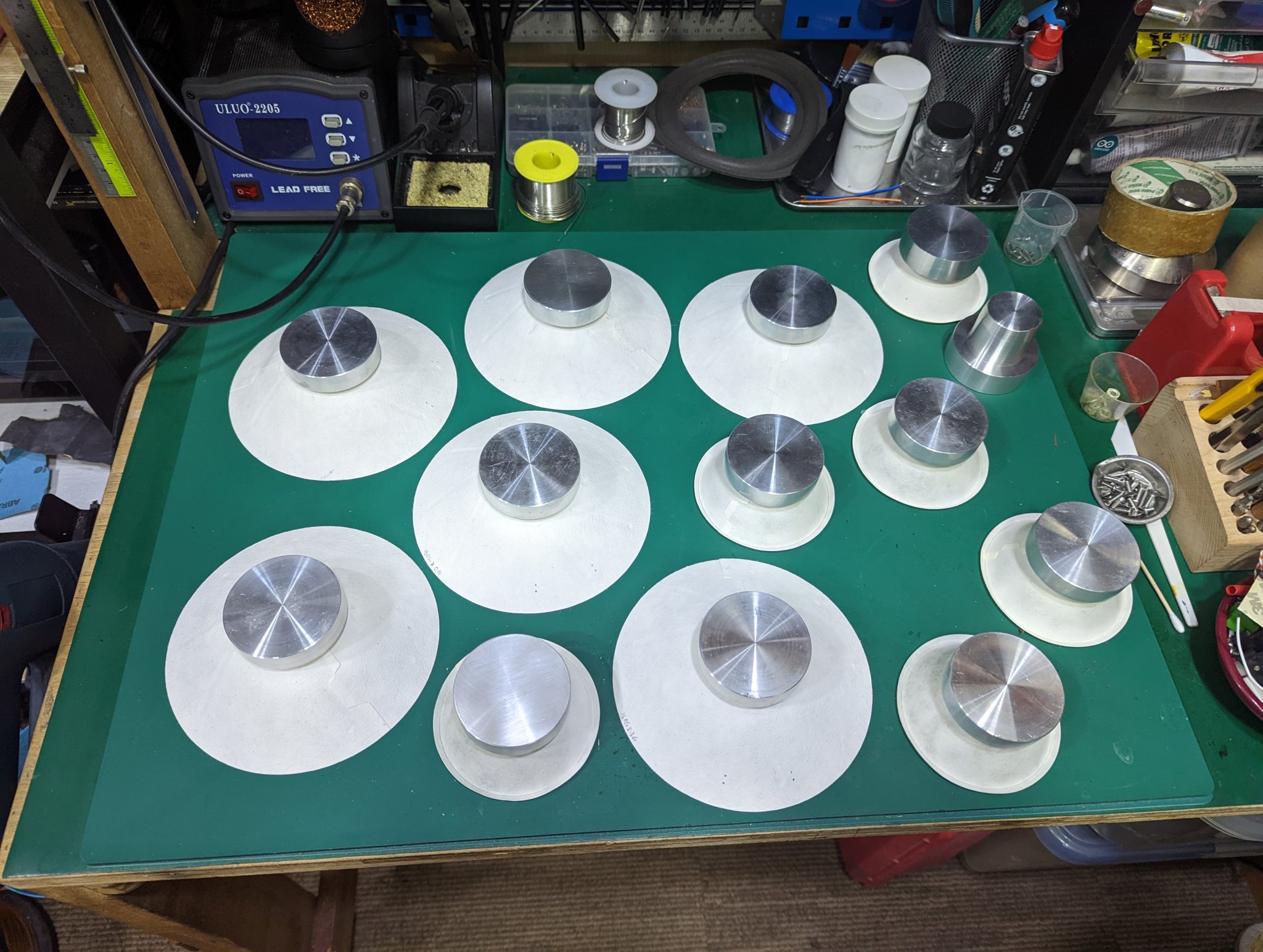

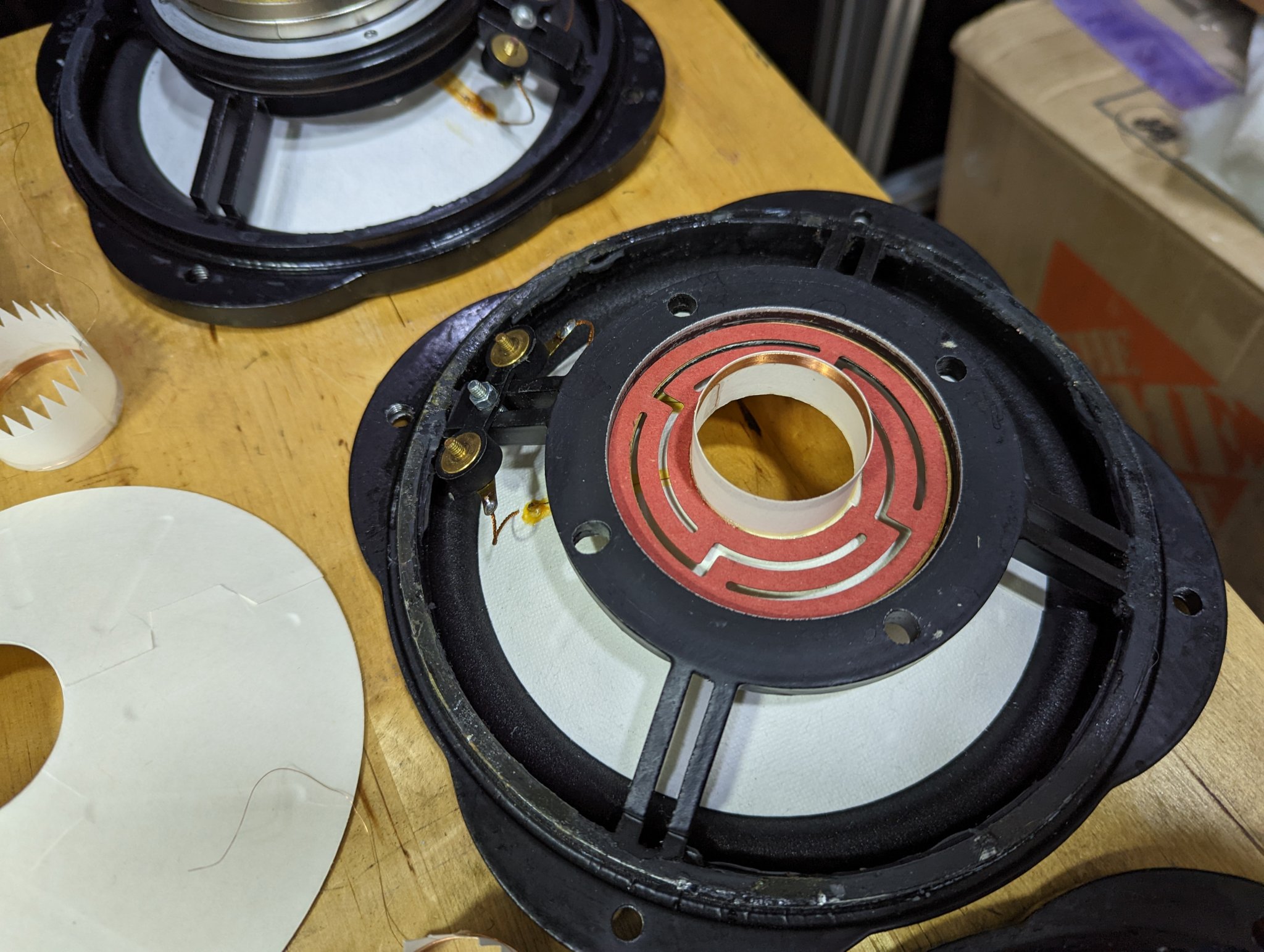

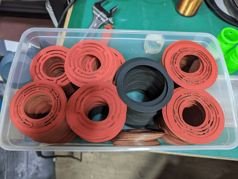

Damper: 0.5mm thick Insulation Paper
Main Cone: 160gsm Mulberry paper from Thailand
Whizzer Cone: 125gsm Mulberry paper from Thailand

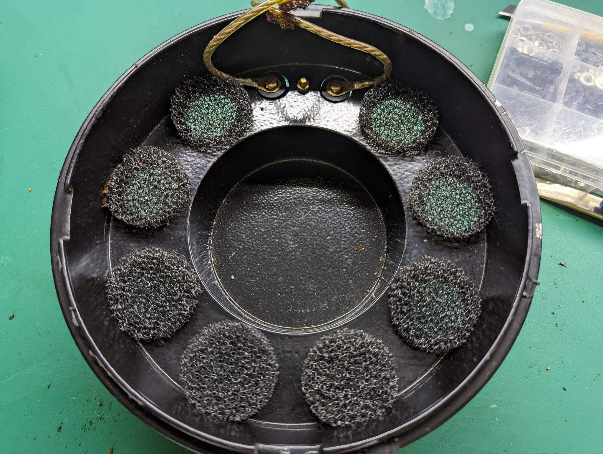

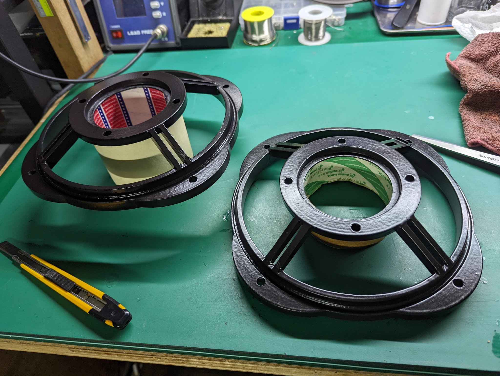

The basket(Frame) was sand down and resprayed.

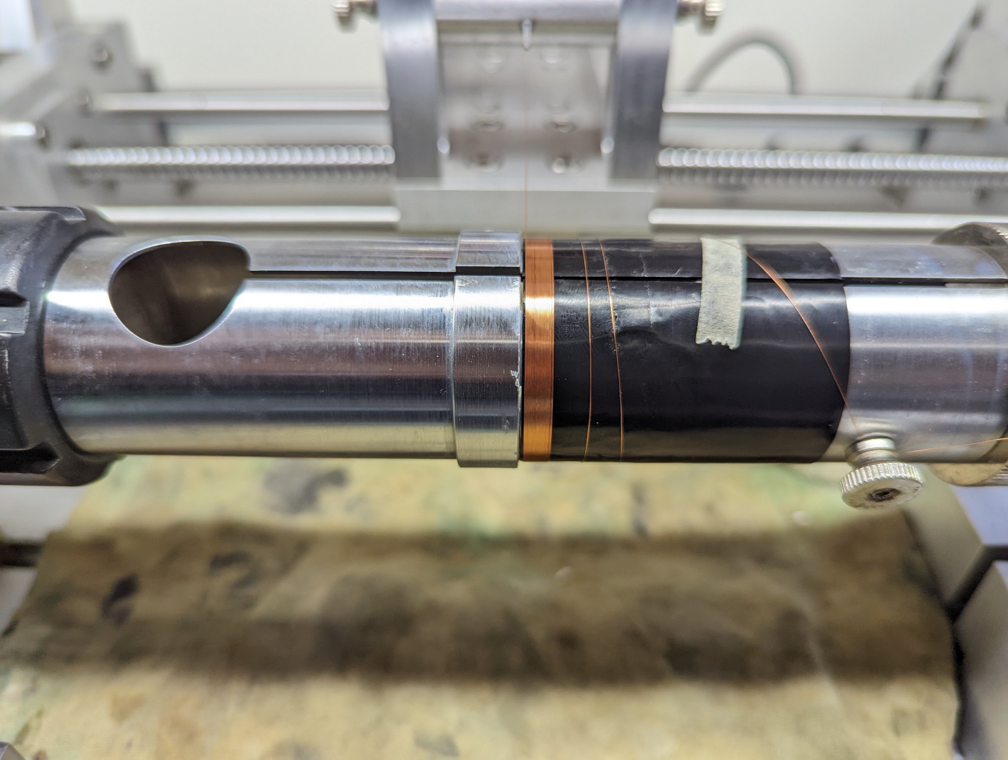

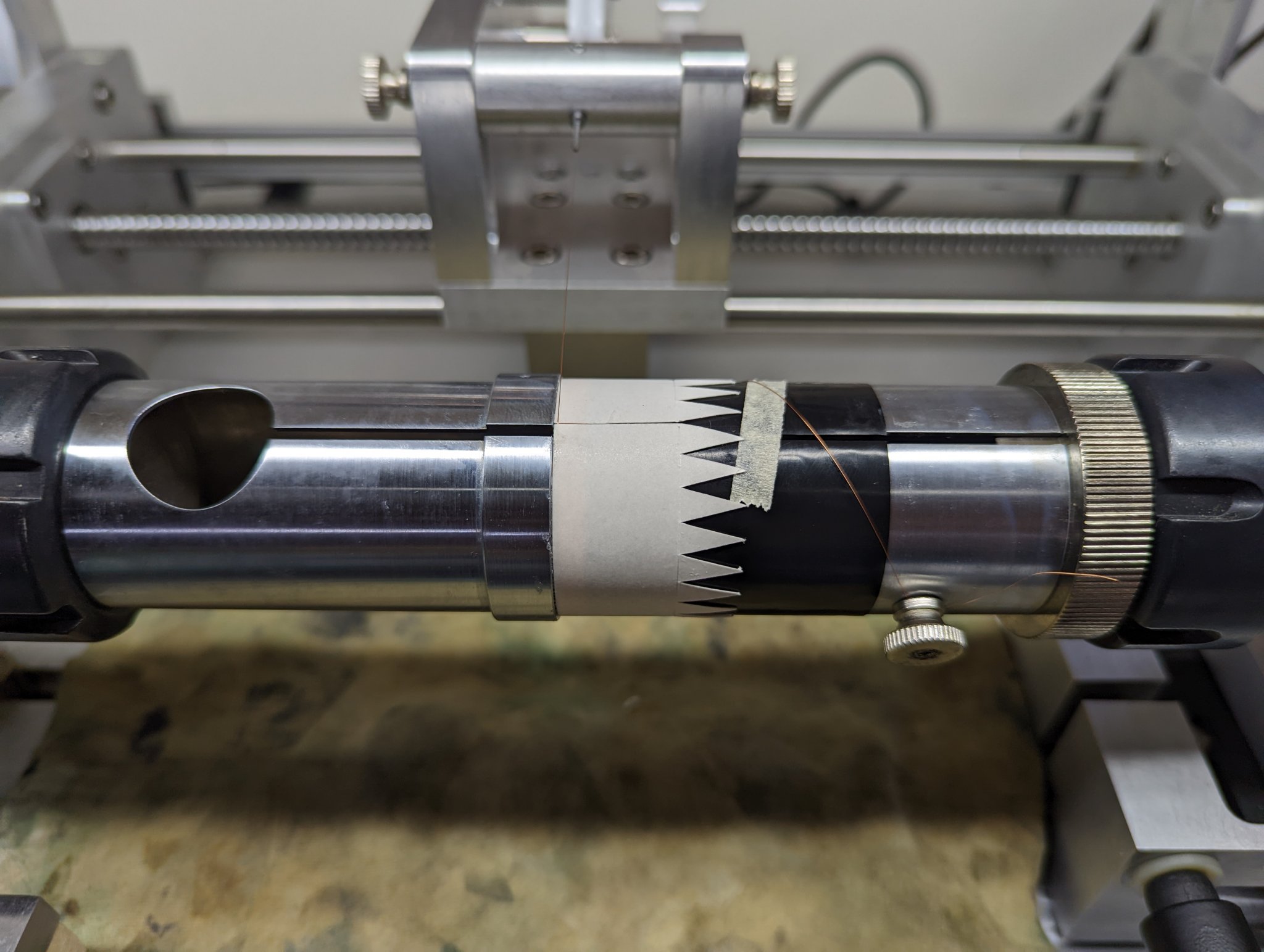

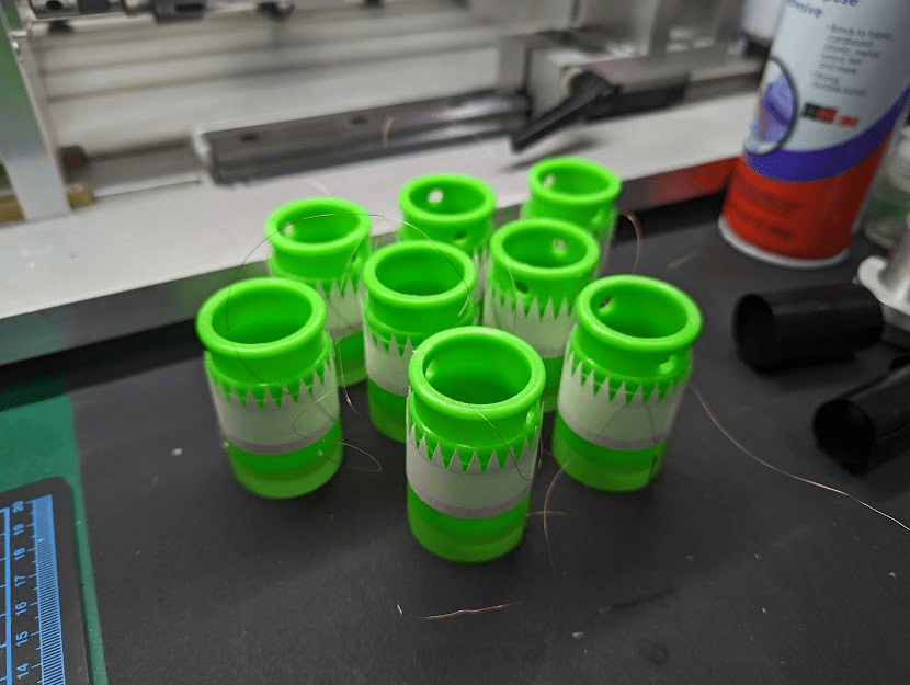

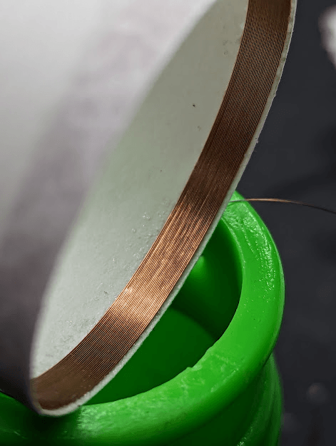

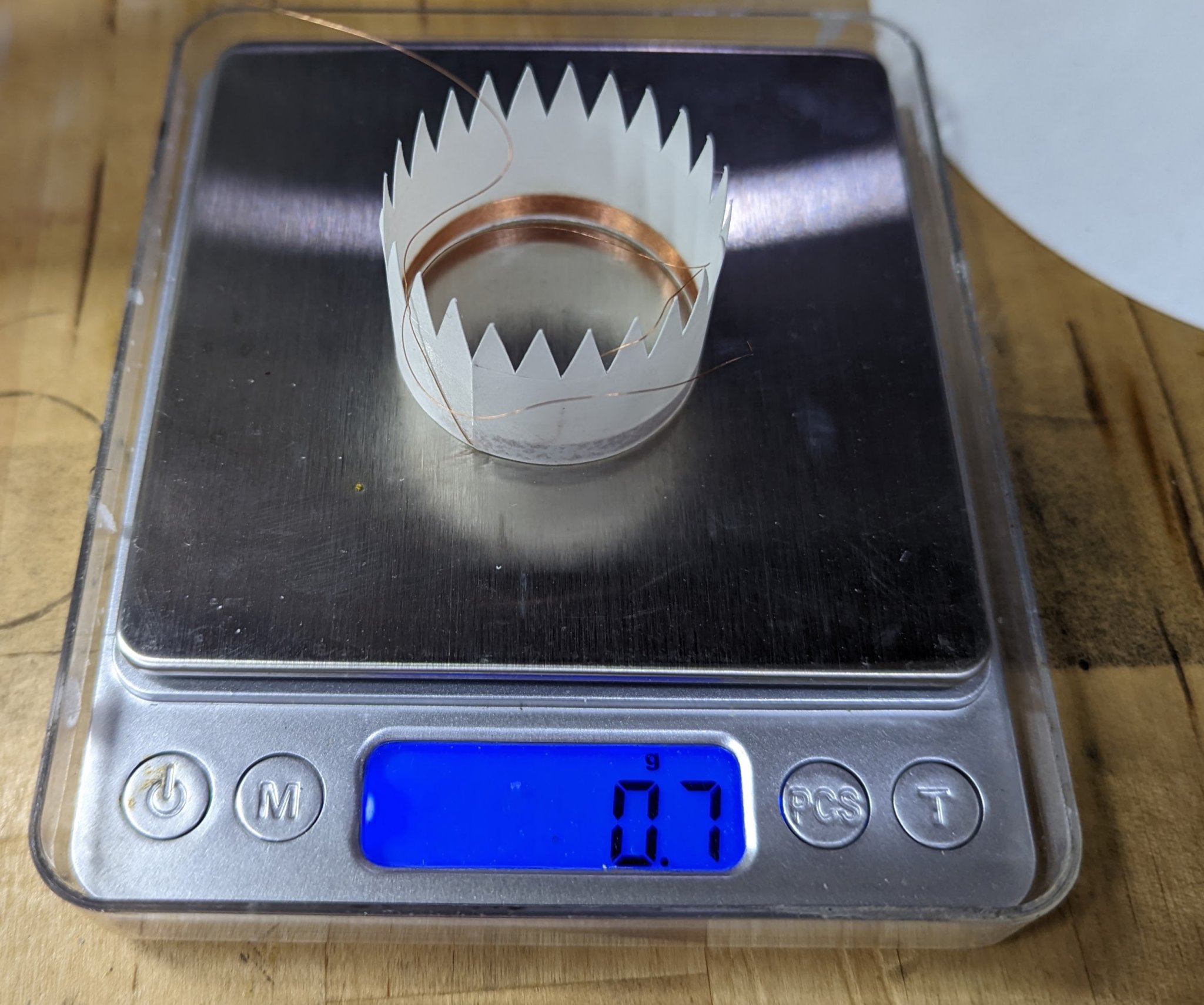

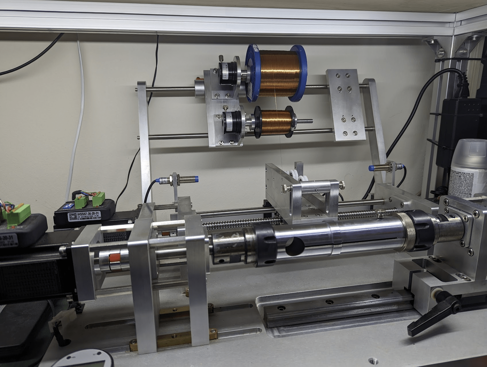

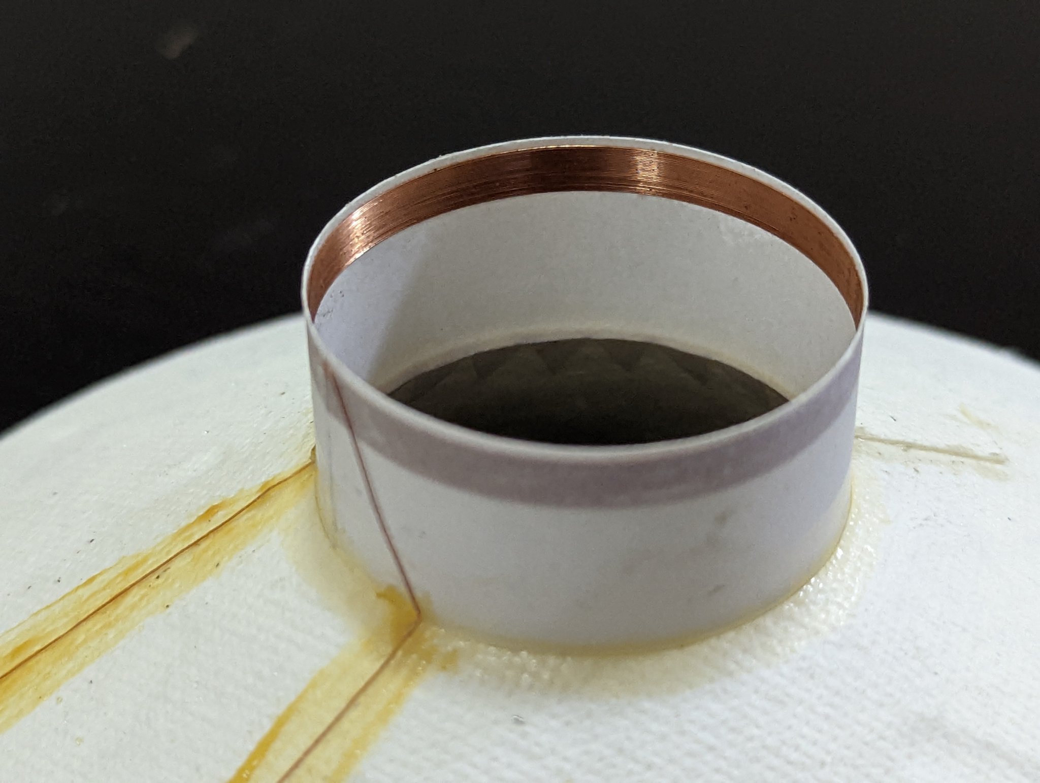

The method of Voice coil winding I used for inner winding. A teflon sleeving to prevent the winding get misaligned from rubbing on the bobbin.
The bobbin is a specially made with a tail end insert. When the tail end is remove, the bobbin can be collapsed slightly to allow the winding to be released.
EX4 Restoration and custom cone rebuild
Lowther Voice Coil:
- 0.13mm diameter CCA Wire
- 27 Turns
- Former Height 16.5mm
- Inner Diameter 38.3mm

I have quite a few designs for the spider using phenolic and Vulcanized Fibre paper.

It might be a silly question, but where do you see the advantages of having the coil inside the former instead of outside?
However, great work as usual!
All the best
Mattes
It mainly for assemble of the cone where the voice coil is attached to the whizzer cone 1st then the main cone. So the winding will not cause any blockage.
It is much difficult to make inner winding compared to outer winding. Also the inner winding is to match the design from the original lowther
I believe the Lowther DX4 is about 11 grams, so this heavier cone would explain the higher Q and lower Fs. The Lowther 8 ohm aluminum voice coil DX4 has the 2 khz peak- the "famous" shout (at least it used to), I suspect that this driver with a different cone would have a very different frequency response. It would be interesting to see the frequency response of this driver. I noticed that this driver has a very high compliance, higher than Lowther's which I believe is high to begin with. It would be interesting to also see the impulse respone of your driver.
My cones weighs about 6.0g to 6.4g without surround and damper(spider). The average paper weight for Lowther is around 160 to 165gsm.
Lowther shout is mainly due to overly thick whizzer cone, so what I did was reduce the whizzer cone paper to around 90gsm to 100gsm. Will update shortly on the measurements again.
I am sure that the thickness of the whizzer cone is a factor. I also observed that the 16 ohm version did not have the 2000 hz peak (thus, the weight of the voice coil is also a fac tor), but it seems that it had peaks elsewhere. I think that it is a challenge designing these drivers to be efficient and have a flat frequency response. I am impressed with what you are doing.

I adapted a plastic light bulb socket I purchased at a local hardware store to fit where the diffuser would go, and I screwed in different light bulb shapes to try different diffusers. The diffuser affects the frequency response and is particularly useful to reduce beaming.
