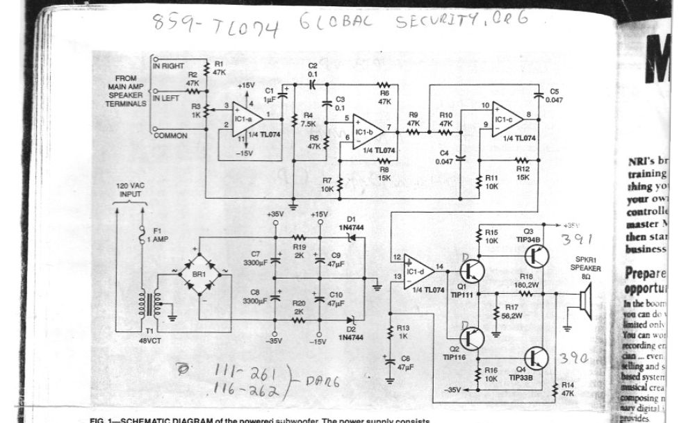

I'm looking to build my first sub with an amplifier
I've already got a small amp to power it with but I'm looking for a Lowpass filter schematic and more importantly, layout
If anyone can help me I'll be grateful
Cheers.
sub amp and filter
I built this years ago from a magazine
