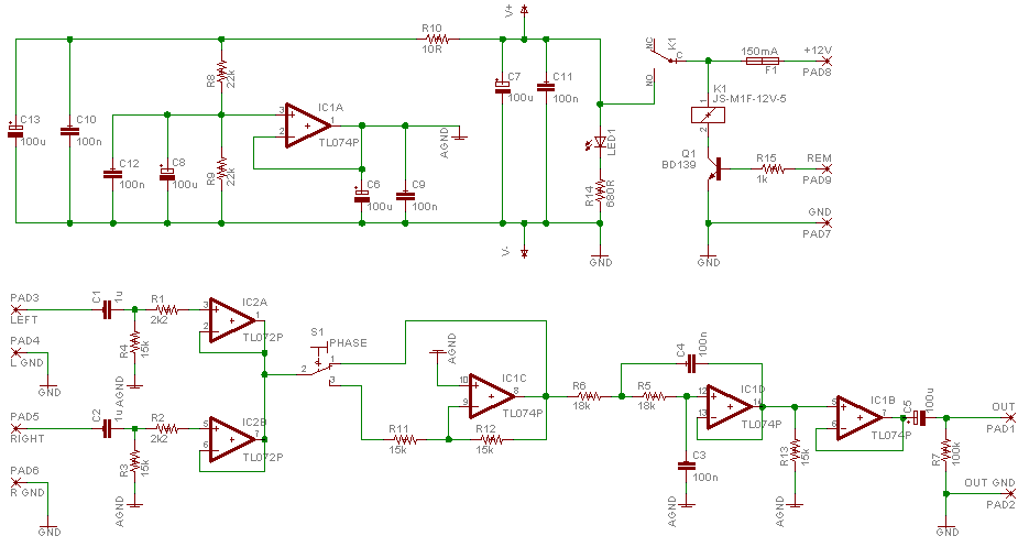

I have made this schematic putting together various projects of Elliott's site.
I would like to know what do you think about my design.
It uses a "Artificial Earth", phase select switch (0º or 180º), 12dB/Octave Linkwitz-Riley alignment and cutoff at 90hz.
Thanks and sorry my bad english.
