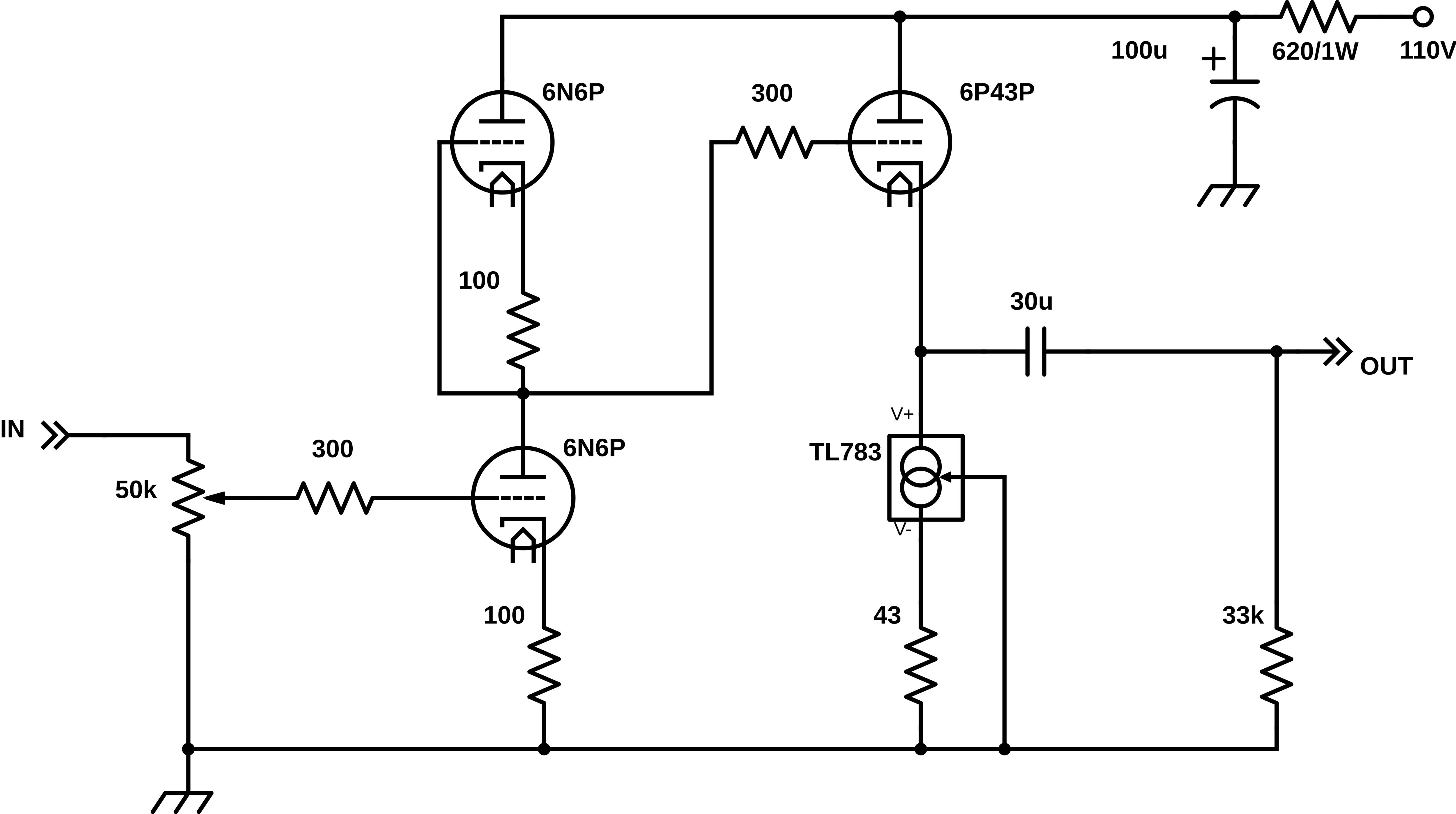

lowish voltage (110V) tube HP amp/preamp idea...
It uses a 6N6P and a 6P43P loaded with a TL783. I think it will work as a headphone output for my 470R phones, as well as being a line stage.
Does anyone see any glaring errors?

"Active pull down"
It's actually push pull.
"It is a push-pull buffer design that allows the delivery of up to twice the idle current into the external load impedance, twice as much as a conventional cathode follower can deliver."
"The White cathode follower belongs to the family of push-pull, class-A circuits that includes the SRPP and SRCFPP, as all three circuits use a current-sense resistor to create the needed anti-phase signal for push-pull operation."
Variations on the Theme of the White Cathode Follower
1µA current noise is way above anything else in the circuit I suspect. Remember its over a 10kHz BW, so its 10nA/√Hz, current noise is normally measure in pA or fA. A 10k resistor has 1.3pA/√Hz thermal current noise for instance, 60dB less.
Of course that noise spec in the TL783 datasheet is probably only a rough/ready thing, perhaps a worst case including bad flicker noise, but still its high - most voltage regulators are not low noise amplifiers. Worth trying to see how bad it is in practice with a real part - can always substitute a 1k5 resistor as a load to compare.
