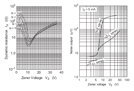

Can you explain datasheets like this?
http://documentation.renesas.com/doc/products/diode/rej27g0012_zener.pdf
Also clear statements in standard texts like Pease and Horowitz/Hill?
Best Zeners are 6.2V
According to that datasheet, 6.2V isn't optimal for noise or dynamic resistance. What am I missing?Can you explain datasheets like this?
What am I missing?
The data in 1.4.2. Look particularly at the first graph, which shows 1-2 orders of magnitude improvement at 5.6 and 6.2V compared to, say, 9 or 20V.
LEDs are still quieter, though- under 0.5nV/rt Hz for a cheap red.
