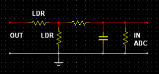

I'm building an analog input selector switch that is connected to an ADC having a 10k Ohm impedance.

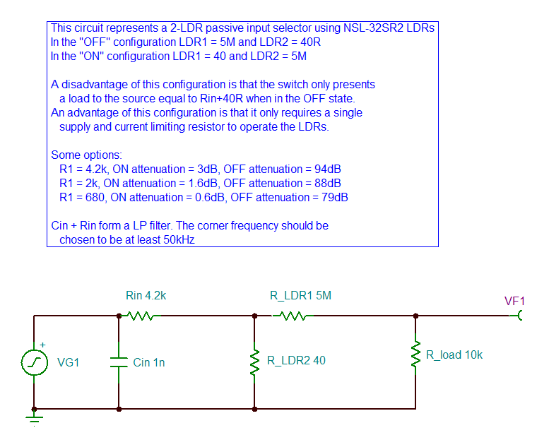

The circuit is shown in the attachment, representing one input connected to the 10k load of the ADC input. I have about 20 of the LDRs that I can use to select from different inputs or pairs of inputs. This configuration saves one LDR per channel compared to other circuits that I have seen, and is completely passive.

If VG1 is the source, then Rin & Cin won't give you a LPF.
Based on what it "appears" you are wanting to do, hows about this
Oops, I stuck that in there as a way to try and use Rin for that purpose but never did a sim of the transfer characteristics. You are correct, it doesn't do anything as I have drawn it. Moving "Rin" to the ACD side of the LDRs and putting the cap after Rin as you have shown gives the proper behavior. Thanks for pointing that out.
Anyway, more specific to my application, the LP filter might not be at all necessary since the ACD has a steep anti-aliasing filter with >65dB rejection above the Nyquist frequency. On the other hand it might be good to reject RF signals and the like, so I could drop the capacitance down to 100-220 pF.
With the circuit i posted, you will acheive what you want 🙂
OFF = + 5Meg to the source = no low loading.
ON = Correct LPF implimentation.
