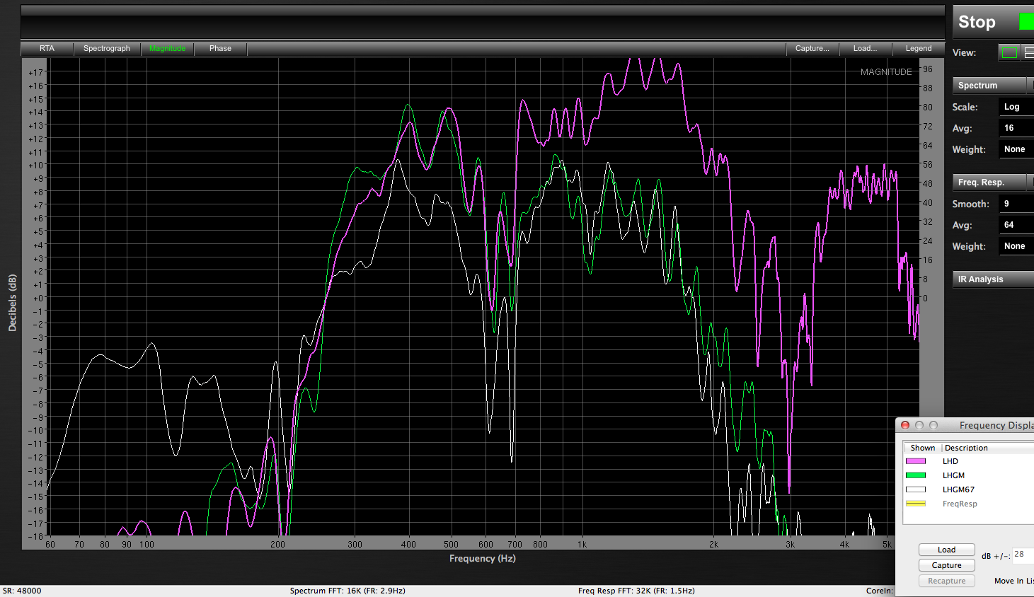

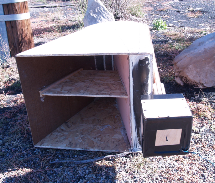

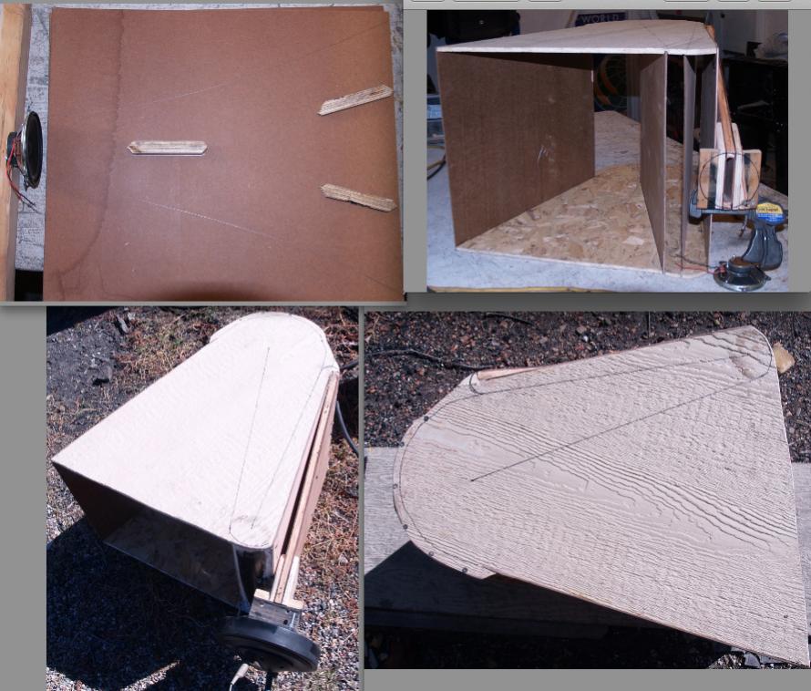

Trying a couple different compression drivers on a long folded horn that in theory should go down to around 80 Hz was also disappointing, response rolled off below 300 Hz.
Using a 5.25" Goldwood GM-85/8 (4" cone) the horn went down to 300 Hz, well below the driver's Fs (resonant frequency) of 470 Hz.
After drilling a couple 1/2" holes in the back of the speaker, and using around a 100 square inch compression chamber, it plays down to 75 Hz.
Very peaky response, rolling off steeply at 1800 Hz.
"Interesting" for guitar use.
Your 5" Carbonneau would work on this horn, if you are willing to pay for shipping, it's yours 🙂.

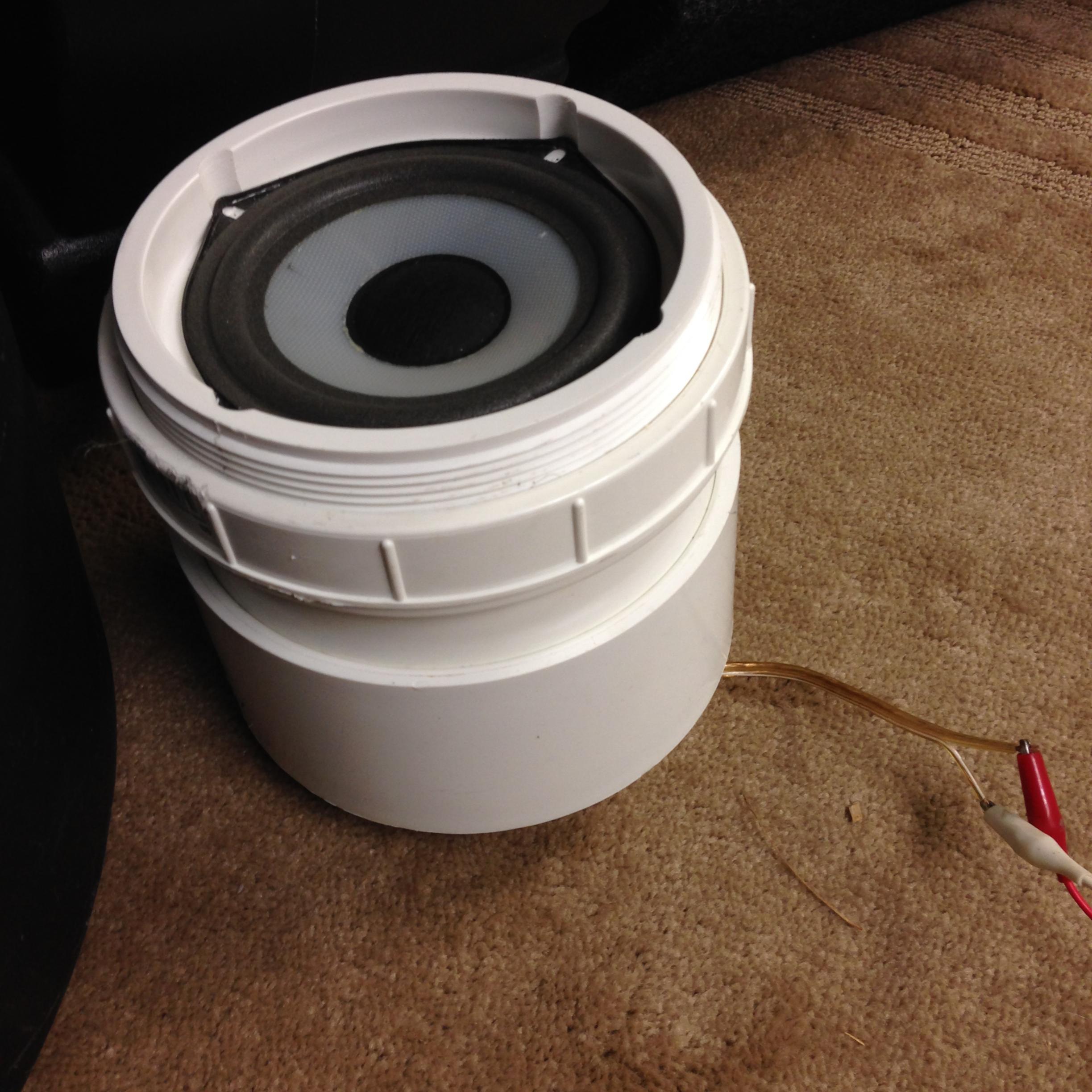

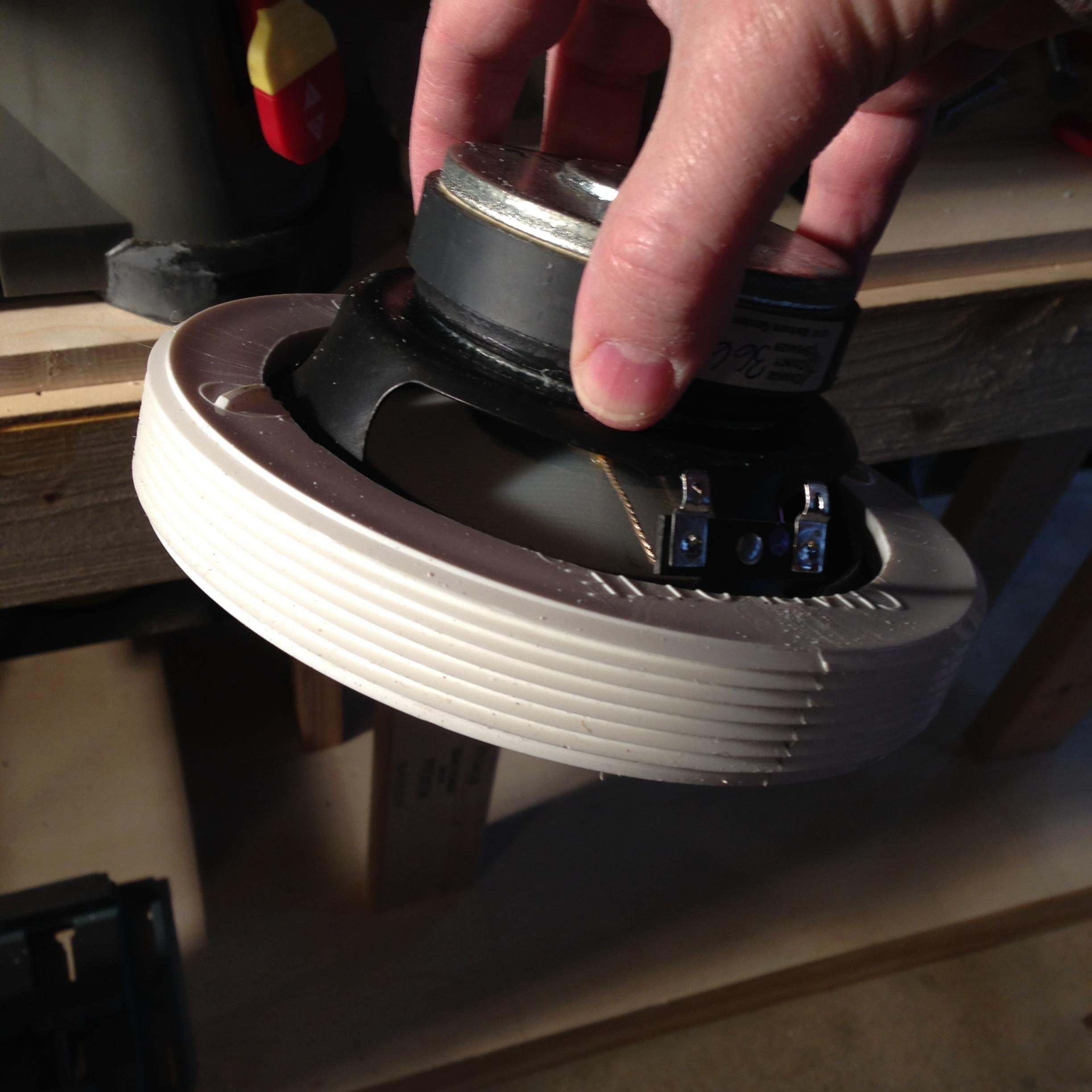

Long time, no hear! By way of an update, I've been moving ahead with the 5" Carbonneau driver and just today I modified a 6" PVC threaded cleanout plug for the speaker to attach to. Here are two photos that show a test fit of the speaker with the hollowed-out plug. I had planned to use threaded inserts to accept screws to hold the speaker in place, but since PVC is so hard I had trouble finding a drill bit size that was large enough for the inserts to be able to be screwed in without breaking the inserts. Because the plug material is about 1/4" thick, I think I'm just going to drill and tap holes and secure the speaker with cap screws (with some red Loctite since these screws are going to be experiencing a lot of vibration).
I plan to cement a 6" PVC cap on top of this plug. I'll drill a hole for a phone jack and cement a 1-1/2" cap over that jack on the inside with the wires coming through a cement-filled hole so that the speaker jack isn't an air vent, and per a suggestion here I plan to glue some batting around the inside of the cap. So the completed assembly will be about the size of a paint can, just not as tall, and will screw right into a 6" cleanout socket.

Here is the Carbonneau with the three PVC parts test-fitted together and a hunk of zip cord connected to the speaker for testing. There wasn't a lot of low end but there's no stuffing involved yet and there's certainly more than there would be from any compression driver. I've got about an inch and a half of room I can play with with respect to the cap on the bottom and the cleanout receptacle; I tried moving the cap around trombone-style to change the internal volume but it didn't make very much difference to how it sounded. In any case, I'll have something I can work with in short order.
