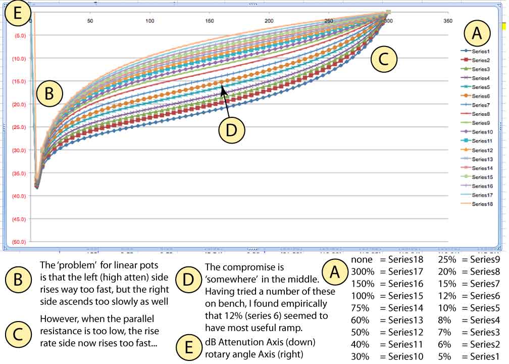

Resistor-in-parallel-to-pot-wiper...
GABX answered… but not the original poster's point: to add a smallish value (5% to 15% of full pot value) in parallel to the wiper-and-ground (W+G). Being a math-curious sort, I thought it useful to 'play' with this with a smallish c-code program (hey, it could be any language, including Excel if one likes!!!)
Here in a nutshell is what I found.
Without any math at all, the effect of a fixed resistor in parallel with W+G is to make a variable load for the previous stage's output. At 'zero knock' (max counterclockwise), the impedance of the pot's high-to-low terminals is “as specified”. At MAX knock, full clockwise, it becomes
But what about the effect on attenuation-as-a-function-of-rotary-encoding-angle? On a linear encoded pot… Basically, it depends heavily on the value of the parallel resistor. The effect is to both lower the pot (as voltage divider) output across the sweep, except for both ends. Zero and full knock remain same. (-∞ to –0 dB). The one take-away is that the point of maximum unloaded attenuation enhancement is at 50% of full-knock angle. In the case of a 300° pot, that'd be at 150°, or conventionally with the knob pointed straight up.
For example:
The other take-away is that the 'approximation to semilog audio-taper behavior' is made worse with small value parallel resistors, and made 'useless' with large ones. The closest “useful” resistance turned out to be 10% or so. 7% to 15%, to be fair.
Again… remember tho' that the input-facing-load of this technique becomes variable per angle of pot and the value of the resistance chosen, with at maximum impact, the full-clockwise, no-attenuation case being largest.

Why would you want to lower the input resistance? At best it does no harm; at worst it raises distortion and reduces LF response.
REFF = { RPOT || RFIXED }
Obvious. Desired? Ah, now that is a different question! But what about the effect on attenuation-as-a-function-of-rotary-encoding-angle? On a linear encoded pot… Basically, it depends heavily on the value of the parallel resistor. The effect is to both lower the pot (as voltage divider) output across the sweep, except for both ends. Zero and full knock remain same. (-∞ to –0 dB). The one take-away is that the point of maximum unloaded attenuation enhancement is at 50% of full-knock angle. In the case of a 300° pot, that'd be at 150°, or conventionally with the knob pointed straight up.
For example:
Code:
Of R Angle dB ... notes ...
3.0% 150° –19.4 (–25.4 dB atten vs. –6.0 dB w/o)
5.0% 150° –15.5 (–21.6 dB atten vs. –6.0 dB w/o)
7.5% 150° –12.7 (etc.)
10% 150° –10.9
15% 150° –8.5
20% 150° –7.0
30% 150° –5.3
40% 150° –4.2
50% 150° –3.5
60% 150° –3.0
80% 150° –2.4
100% 150° –1.9
150% 150° –1.3
250% 150° –0.8
500% 150° –0.4
