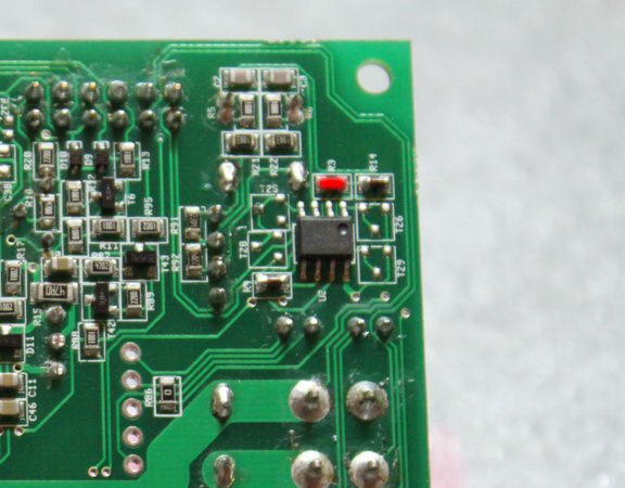

Hi, I'm using a home build UCD400 amplifier. Recently I replaced my speakers with Klipsch Lascala II's. Gain is way to high (20x?) for these sensitive speakers.
Is there an easy way to change the gain on the UCD400 (replacing a resistor?)

hi,
you can change the gain of the ucd400 by changing one resitor R3:
http://www.hypex.nl/docs/appnotes/gain_appnote.pdf

From what I read on the pdf and if I got Ucd400 HG this year (2015) a good value for R3 would be 2k or 2.2k? I have a dac/pre that goes as high as 10V pp.
