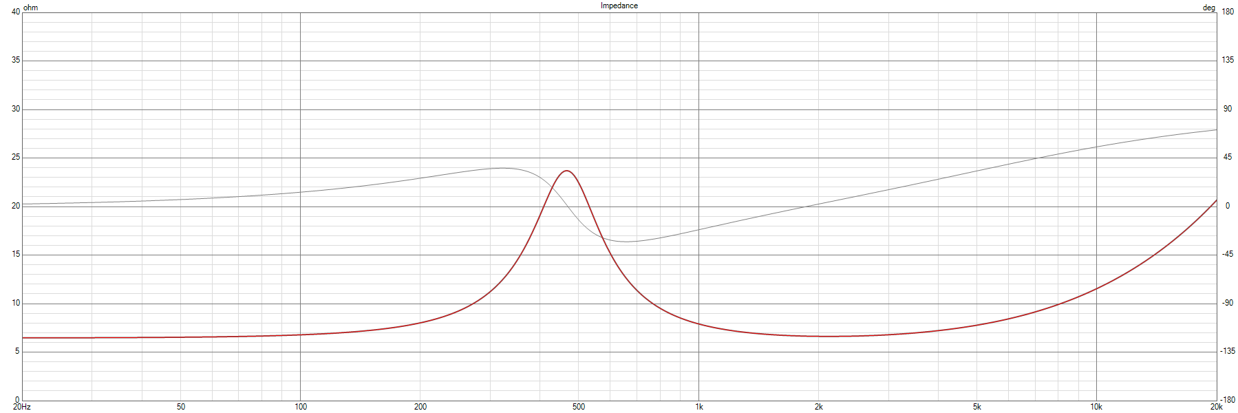

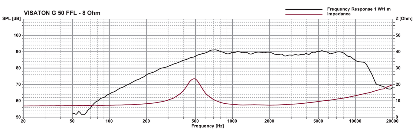

Consider the following 2-inch (50mm) midrange driver, the Visaton G 50 FFL - 8 ohm unit. It has a resonance frequency of 455Hz, and its low-frequency rolloff appears to follow a 2nd-order response with a Qtc = 0.71.
A quickly-created VituixCAD model of the electrical impedance of this driver is shown below.

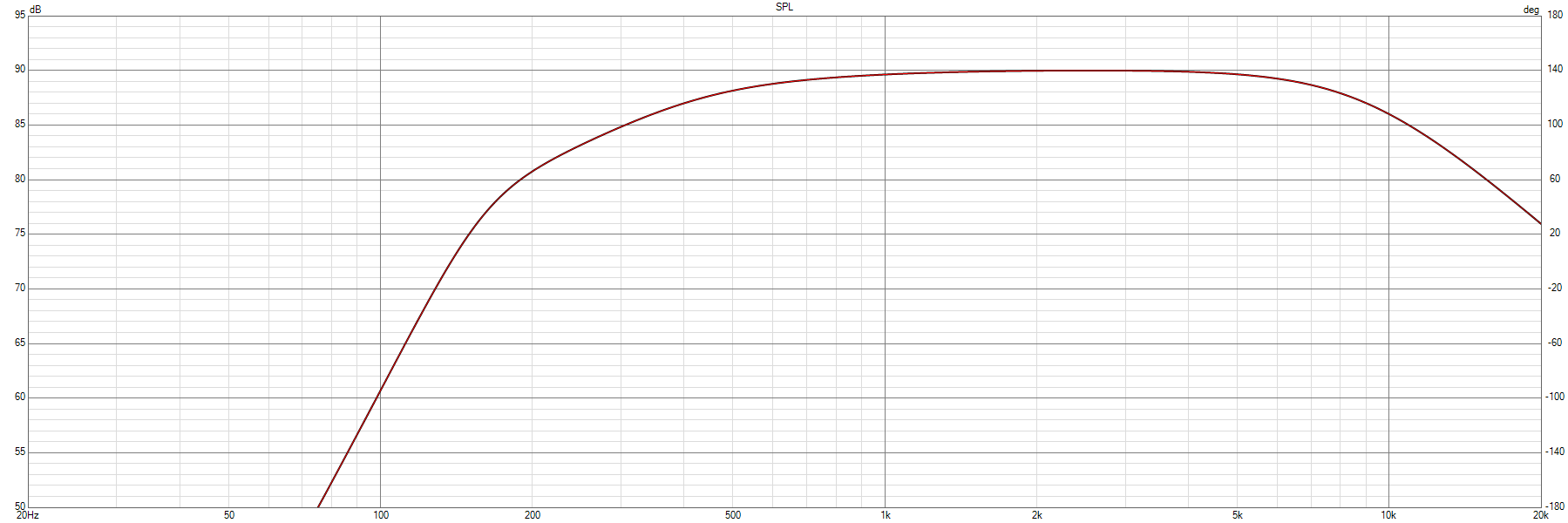

The SPL response model is shown below. It represents the main features of the low-frequency and high-frequency response, but omits the wiggles in the passband.

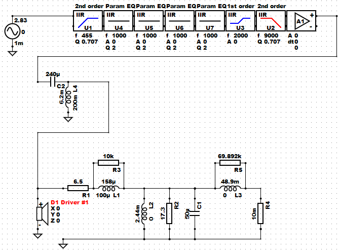

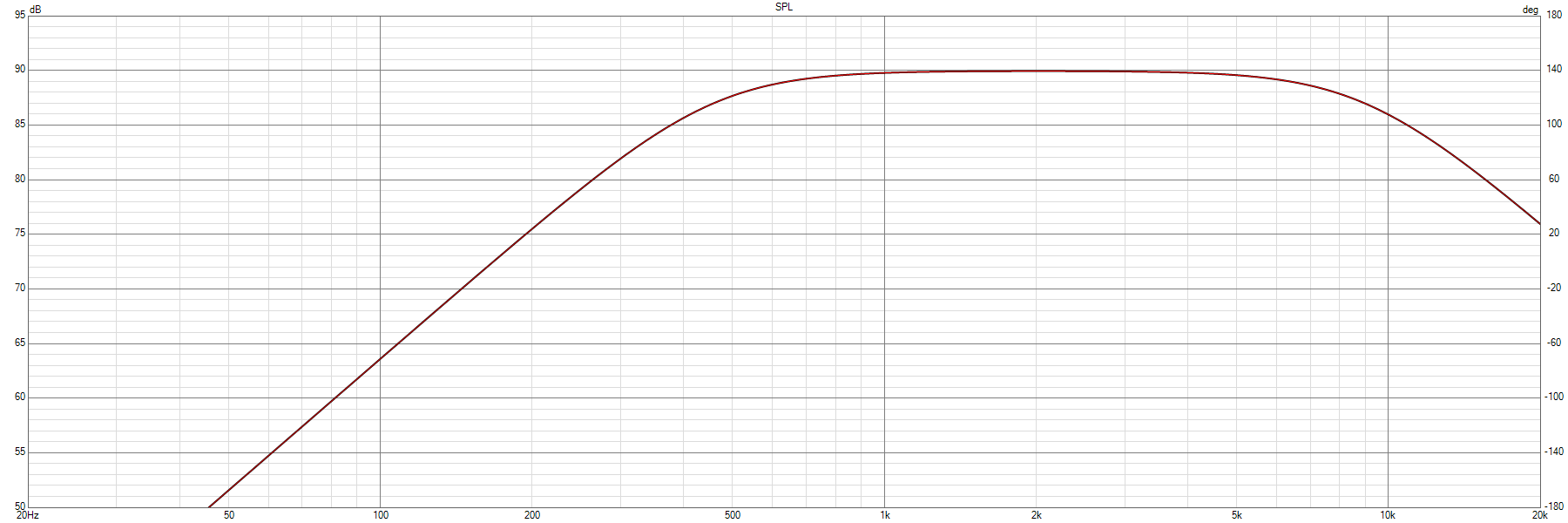

Adding a simple 2-component (C and L) 2nd-order high-pass filter network to this driver produces the following response. This filtered response is −3dB at about 450Hz. This shows that the impedance peak of the driver at 455Hz can be worked with using a simple filter network. It's possible to adjust the –3dB low-frequency cut-off frequency by varying the values of C and L in the filter network.
The VituixCAD circuit used to produce the above response is shown below. Note that Z = 10,000 ohms and SPL = 90dB for Driver #1 in this reduced-order model.

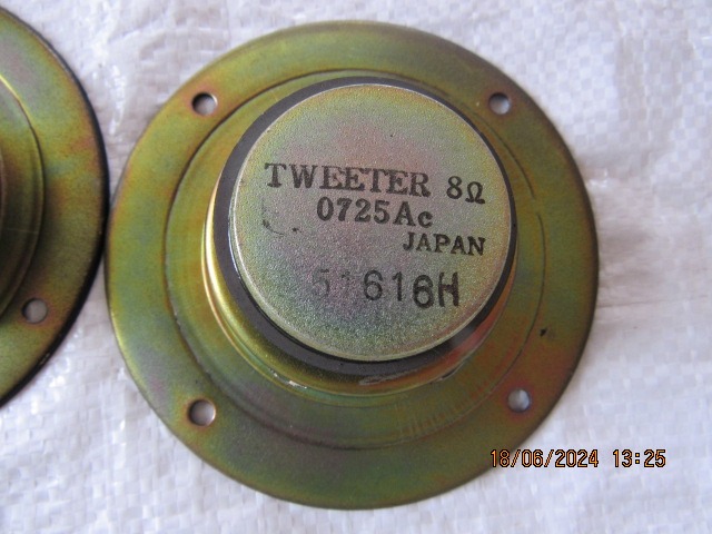

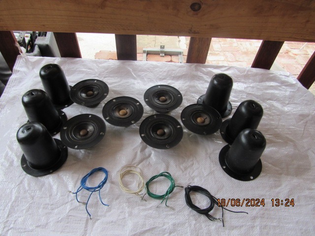

More probably a lowering of Fb by lowering the Qtc from 1 to something lower as I mentioned earlier. As you were informed earlier the tweeter is a "closed system" like a woofer in a sealed box but much much smaller.
There are open backed tweeters and these usually came with a reasonably big plastic cup that integrated with the drivers surround.
I've attached pix of the small drivers made by Coral that are /were made this way
