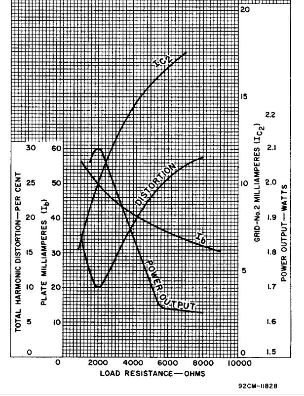

Thank you for all the recommendations. I've got some research to do. This all got me thinking more about output impedance. I am now considering buying some dedicated Edcor OPTs to see how they sound compared to what I'm currently running. I've included a portion of the 6GC5 datasheet which seems to indicate an ideal transformer impedance for this particular tube of ~2k ohms for lowest distortion and highest power out (even if it's not needed per se). Is that right? They have several over there rated for both 1.7k and 2.5k. I've also tried a 6GF7A dissimilar duo-triode in a "one-tube-per-channel" situation. It's a High mu/Low-mu triode tube. It doesn't have the bass that the 6GC5 does, but that may also be an impedance issue as well. Highs are wonderful but the low end is just kind-of jumbled and mushy. Power for days though.

Something else to be aware of is the affect of running a @24 ohm load on 8 ohm taps. This 3x resistance will create 3x primary impedance for the tube to drive so if you start with 5K ohms you can estimate 15K ohms the tube will be pushing into. That cuts the power the tube can create. So you should look for a 16 ohm tap, and match your tube's load impedance and tranny primary Z, close as you can get. Maybe undershoot the primary Z by half if you can't get a 16 ohm tap. Doesn't have to be perfect by any means just get the dart on the board. If the tube you are using now wants 2K and you are giving it 15K, that's not on the board. Small signal triodes you are interested in usually want 50K-100K to drive into.
