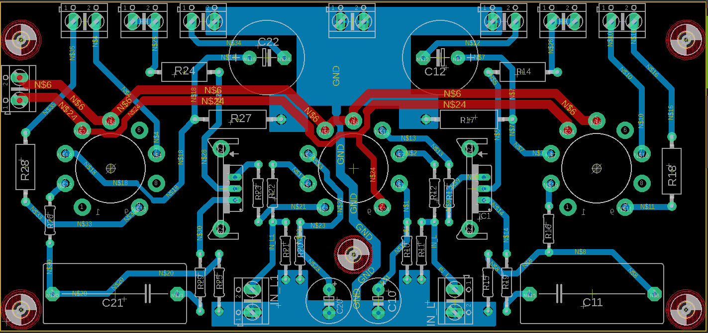

Hey all,
I'm interested in building a small amp for desktop and headphone use, using the SSE design as a starting point.
I'm thinking currently of 6V6GT/A with the operating point of:
B+ -- 275V
Vp -- 250V
Kr -- 390R
Opt -- 5K
* 1) For plate voltage of 250V with 275V B+, does that occur simply from the voltage drop across the output transformer or is anything else needed?
I've been looking around here for which mods on the SSE are needed to support lower voltages (around 275V B+) and found:
-- Jumper instead of 10K resistor to CCS
-- If using 12AT7, increase current set resistor to 470R
-- Alternatively, use 12BH7A. Although I'm not sure if any further changes are needed except swapping the tube.
* 2) Any other frontend changes needed?
Also, I will attempt to "roll my own" PCB for the SSE minus the power supply. This is to better fit the design I have in mind for a smaller chassis.
It is in early stages, I like the symmetry but not too happy about "weaving" the pentode plate trace next to the signal. I'll probably have to rotate that tube and figure something out.
* 3) Has anyone tried to use a 12AX7 ? I've got alot more of those than 12AT7, and since I'm making the PCB I could incorporate any changes needed to support that.
Thanks in advance.

You should not drop more than a few volts through the OPT.
In a cathode biased stage, the voltage drop occurs across the cathode resistor. Measure the voltage at the top end of the cathode resistor, and subtract that from the voltage on the plate, the difference is the voltage across the tube. The voltage drop across the cathode resistor also establishes the negative bias voltage on the control grid.
Going from memory, the grid bias voltage for 6V6 at 250 volts is about - 12 volts, or, in other words, you want to pick Rk to drop about 12 volts across the tube.
So, with 275 volts B+, you'll be seeing 262 ish across the tube.
George has said that some 12AX7 are capable of performing spectacularly when CCS loaded, and some are dogs. You would need to be prepared to experiment, I think.
Ah, thanks for the explanation regarding the voltage drop.
I'm using the data from the chart on the last page of this experiment:
http://www.r-type.org/pdfs/6v6-se-ul.pdf
Likely use B+ of 275V or 300V with the corresponding cathode resistors there.
I've got a nice selection of NOS 12AX7's to experiment with -- Mullard, Amperex, Telefunken, RCA, Raytheon etc..
For this, do I simply need to modify the current set resistor to get about 1.2mA ?
One other question regarding the frontend CCS .. how is the voltage on the plate determined?
Plate voltage on the input tube is determined by the cathode resistor. Most 12AT7's do fine with a fixed value, but the 5842's used in the TSE need a pot since they vary a lot. If you plan to roll a lot of different tubes through your amp at least start with a pot in the cathode circuit.
Some 12AX7's can make very low distortion values when CCS loaded. Their lack of drive capability makes this rather hard to obtain in a simple circuit due to the load imparted by the output stage. My low THD measurements were made in a buffered design like the TSE.
I had a triode wired 6V6GT based SSE and it was a nice sounding amp. I ran a B+ of 325 volts with about 35 to 40 mA of current. My only changes to the design was replacing the 10K resistor in series with the CCS with a wire. I tried two different OPT's, a 3K Transcendar custom designed for 300B's wired for 6K, and the $29 Edcor XSE15-8-5K. I actually preferred the Edcor. At the 2.5 watt power level obtained from a 6V6 the Edcor could do bass far lower than my speakers could, and the top end went to nearly 40 KHz. Can't do that with a 5 pound OPT.
Virtually all 6V6's can eat well over the 315 volt plate voltage rating. I have seen guitar amps run them at 400 volts, so I ran my pair of vintage grey glass RCA's at 320 volts putting 300 volts across the tube.

I thought you were thinking octal 6V6. I would like my heaters supplied by twisted wires, rather than traced on the PCB. That also leaves the flexibility of using tubes with dissimilar voltages - think 5V6 or 12V6. A jumper to pin 9 for the center tube would further help - think 6DT8 rolling 🙂
I was thinking 6V6 originally but I didn't really like the routing around the octal tube.
I had another thought that I'll try out.... perhaps I'll just put a fairly large hole where the output tubes are, and that way they can be mounted on the chassis and 9-pin or octal could be used with the same driver set up.
