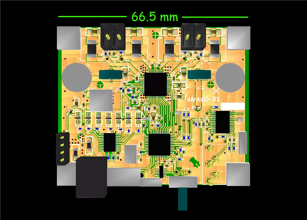

I'm just about ready to have PCBs fabbed for something in that field.
It uses the TI TAS5727 chip in PBTL, meaning
15W into 4Ohm @12V single supply
38W into 4Ohm @18V single supply
The TAS5727 has digital input (i2S), soft limiter and a programmable DSP, interesting for speaker cabinet equalization etc. See here: Speaker Amplifier and Modulator - Mid/High-Power Amplifier - TAS5727 - TI.com
The board is meant to be used for distributed audio systems.
At higher supply voltages it can even serve a subwoofer IMO.
Here is a PCB render. If you're interested, I can have a few more built.
