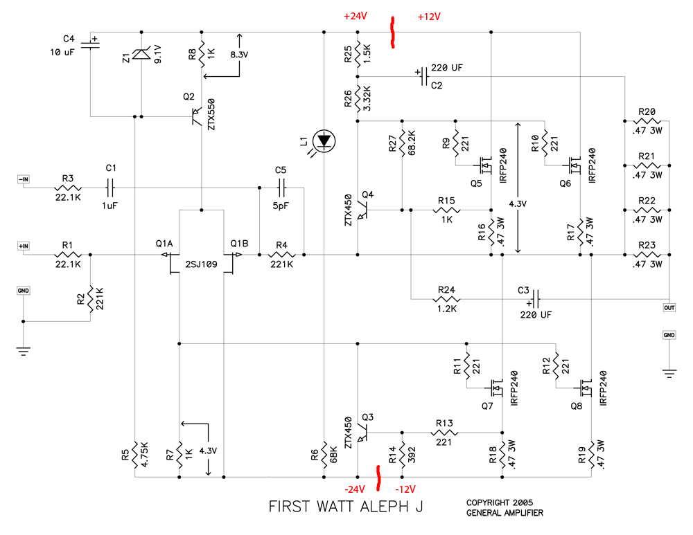

Update
Been gathering parts and I finally got everything to rebuild the power supply. Since the new parts would not all fit in the case I had to build a separate unit for them. I bought another 20Vct power transformer. I then opened each transformer up and split the center tap so I could wire them up with their secondaries in parallel. Now I have two transformers rated 10V@20A. Each transformer has its own bridge rectifier combined to make a dual rectifier for +/-12V and then connects to a 100mF capacitor. I used four .27ohm resistors on the rails between the first cap and the second 100mF capacitor. All four 100mF caps are each bypassed with a 1uF metalized film and 1.5nF C0G ceramic capacitor. An umbilical cable runs from the PS unit to the amp and connects to two 50uF ASC metalized film oil filled cans. The power then splits and runs to each channel. The wire gauges are 14awg for the + and - . I used 12awg for the grounds with two grounds wires running from the amp the the PS unit.
What I had been experiencing before was when instruments were panned hard left or right they would get holographic. But when the were panned in the middle, I could hear them in detail but not focused. I had thought that was because of the room being small. Now listening to the amp I realize that it was crosstalk between the channels that was smearing the imaging. The imaging in the middle is now as focused and holographic as the sides were. Truly an amazing improvement. I think most of the effect is from the very low resistance to ground path the amp now has. I ordered two more 50uF ASC caps to try to separate the channels more by running two umbilical cables to the amp. Each one connecting to a pair of ASC's and then to it's channel pcb.
Next. I was reading lots of information from the PASSDIY site. Thank you for that site. I saw that it is recommended that IRFP240 are used for rails over 20V and IRFP044 for rails under 20V. Well I'm down at 12V so I ordered some IRFP044s to try. The other thing I read was in the BA2. It is recommended the jfets 2sj109 would like to see at least 18V. Well thats way down on my amp too. So I would like to get that up by splitting the power supply. I would like to have the front circuit (2sj109) at +/-24V and the back circuit (IRFP240) at +/-12V.
Is this possible or would it screw things up? The attachment shows red lines where I think the rails should be split.

just forget ;
12V is plenty for input Jfets , and splitting PSU is big no-no - because both biasing and modulation of (lower) output mosfet is referenced to negative PSU leg
regarding positive side - all you have on positive leg is CCS for input LTP , and you'll not gain anything altering voltage

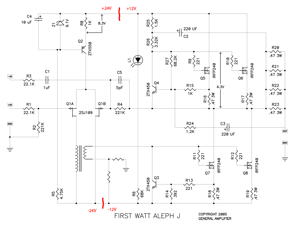

I really like the direct coupling of these circuits so I was hoping there was a way to keep it. Well I am still going to split these circuits because I am going to experiment with lower rail voltages for the MOSFETs. And at some point the 2sj109 circuit is not going to be happy.
Attached is an idea that I think will work well. It uses a interstage transformer. The primary has around only 4mA going through it. That makes things easier getting a higher inductance. The secondary connects to a voltage divider between the ground and negative rail that sets the voltage for the MOSFET gates. The ratio is 2:1 which will give me a lower voltage out but will also give me more current out. That should help the MOSFET capacitance and give more bandwidth and lower high frequency distortions too.
I'm not sure if the negative feedback needs to be removed or not.

nope
first reason is - servo function of input LTP is prevented
second reason ........ naah ......... just forget and go back to reading all pdfs from NP site(s) .
same concept I drew once ........ I'm not deleting that just to help me to stay humble
( OK - second reason is that proposed biasing of output is rough , and you can't do it that way - at least if you want to use your speakers for more than 10min)

Thanks Zen Mod.
I searched for more info and now I think I understand. Any DC offset at the output is sent to the 2sj109 thru the negative feedback loop. Q1b causes Q1a to changes its output to correct for the offset and send it to the MOSFETs.
So to split these circuits I would need to add a DC servo on the MOSFET side. And that would probably give better biasing also.
Is this correct?

correct ;
beauty of that amp is in simplicity ; it's easy to worsen it ;
Babelfish J is what I dared to complicate .....

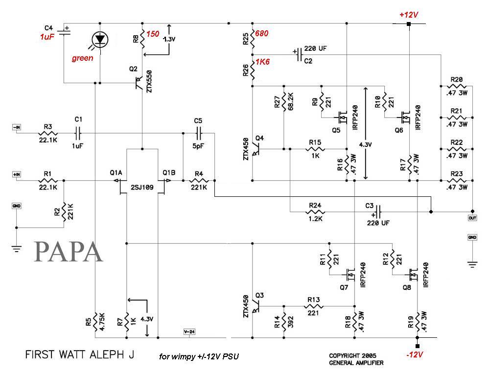

Input circuit adjustment problems
I'm having a some trouble adjusting the ccs and the differential input. After lowering the rails voltage I see the voltage across R8 is 8.52V instead of 8.3V and R7 is 5.15V instead of 4.3V like on the schematic. Also since I have lower rails, I can increases the current through the 2sj109 to get the same dissipation as the higher voltages. Original current was 8.4 mA @ R8 and 4.3 mA @ R7 with a dissipation of .152W @ Q1. With the lower rails I can increase the current to 26.6 mA @ R8 and 13.3 mA @ R7 with the dissipation .152 W @ Q1.
So I studied up on ccs and I understand the voltage drop across R8 is set by Z1 minus the Vbe of Q2. The value of R8 sets the current through the circuit.
At first I thought I would try to just lower R7 to get a lower voltage before I increased the current. But as I reduced R7 the voltage across it stayed the same. I kept lowering it until the voltage suddenly dropped to around 3V.
Then I decided to try to set R8 at 302 ohm and R7 at 314 ohm which should give me close to the currents I want. The new voltages were R8 8.66V and R7 5.15V. So 8.66V across 302 ohms is 28.7mA and 5.15V across 314 ohms is 16.4mA.
So things are not working as I thought they should. I there something about the input circuit that I do not understand? Do I need to adjust the current through Z1 by changing the value of R5?
Another thought was, could the current protection of the output circuit be affecting things?

you just don't get how that circuit works
make it like this
make it like this
Thanks Zen Mod. Looking at what you posted made sense. The LED would drop the voltage 2.1V minus .8V for Q2 = 1.3V. Then 1.3V across 150 ohm = 8.7mA. Split that in two for 4.35mA. That across 1k ohm = 4.35V.
So I pulled out Z1 and replaced it with a green LED. I bypass R8 (1k) with a 177 ohm resistor for a total of 150 ohms. I turned on the amp and the LED lit up. I check the voltages.
LED 1.94V
R8 1.32V
R7 5.19V 😕
Strange. So I pulled R7 out and checked with a multimeter which said 997 ohms. I replaced R7 and gave a listen. Sounds the same as the other channel. Still very nice.
Now I know something else is wrong and not just my math. Any ideas?

ref voltage for green led at 3-5mA is 1V93
Ube is , say , 0V65
so - you'll have 1V93 - 0V65 ~ 1V3 across R8
that means exactly what you wrote - ~ 4,35mA through each Jfet - but in ideal condition
LTP will correct currents through own halves , to maintain ( governing outer parts of circuit) same voltage level at own inputs
that means nothing else than right Jfet is carrying less current than left one
what's voltage across R18 and what's output offset ?
it seems nothing is wrong ; just that you need to learn more , so you'll be able to understand math
Ube is , say , 0V65
Thanks for helping me to learn.
R18 is 0R3 and has 601mV across it.
offset is 72.3mV
offset is 72.3mV
replace R8 with fixed resistor of 100R and multiturn pot of 100R (these two in series );
set 0V offset with that pot
601mV across R18 means that Iq is ~1,28A per vertical pair , which means overall Iq is 2.56A ( I presume that you have two mosfet pairs per channel )
that looks fine - at least consensus is that greater Iq means better sound , at least while in safe dissipation zone for mosfets ......
so - your amp is obviously fine , even output offset is in ballpark , because everything under 100mV is considered acceptable .
but - 0V is always better than 0V1
print this file and study ..........
