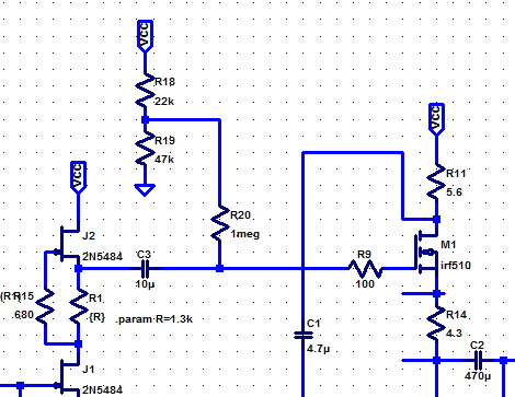

MOSFET SPICE model can in fact be quite pessimistic when it comes to predicting distortion. I think I ended up with two different IRF510 models at one point that gave markedly different results, and measured performance of the actual circuit turned out closer to the more optimistic one.
BTW, looking at that driven current source there, you may be in for a nasty surprise when simulating PSRR for your circuit. (EDIT: Turns out there is a PSRR problem, but it's actually rooted in the SRPP.) It is also a good idea to simulate distortion at 10 kHz.
Never mind, there was a sneaky AC component hiding in the signal source that was set to not display. As shown I'm getting about 40 dB of output PSRR across the band now, which is not spectacular but workable.
You get noticeably improved values (up to 67 dB below 1 kHz) if you give follower MOSFET M1 a source resistor with the value of R2, i.e. Aikido style.
Interestingly you can fine-tune this further by adding sort of a level shifter (see attachment - originally I just wanted to give the current source some better operating conditions). Playing with the R18/19 ratio, I can get this down to 77 dB and even lower, though this applies to ever lower frequencies and may require increasing C1. With 22k / 62-68k I end up at over 90 dB below 100 Hz (where high PSRR is arguably most needed) - that's op-amp territory, not bad at all. I am guessing you would play with a pot and a hummy unstabilized supply during prototyping stage to determine optimum values by ear. Unfortunately there's some correlation with DC operating points and (via Cgd) distortion performance. Going slightly higher than 15VDC for Vcc is to be considered either way.
Hmm, it works. Have no clue how 😵
