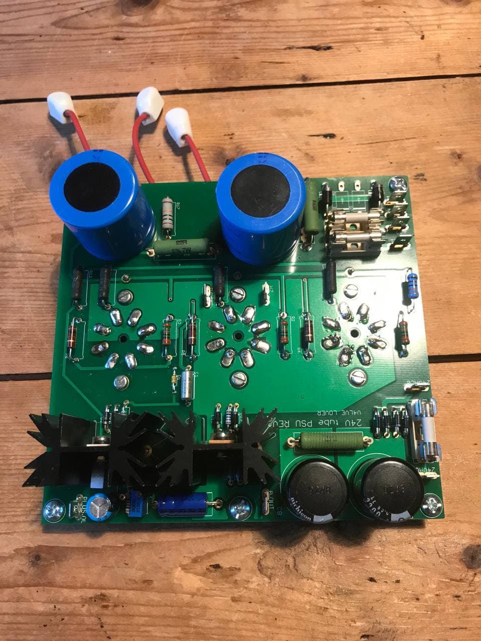

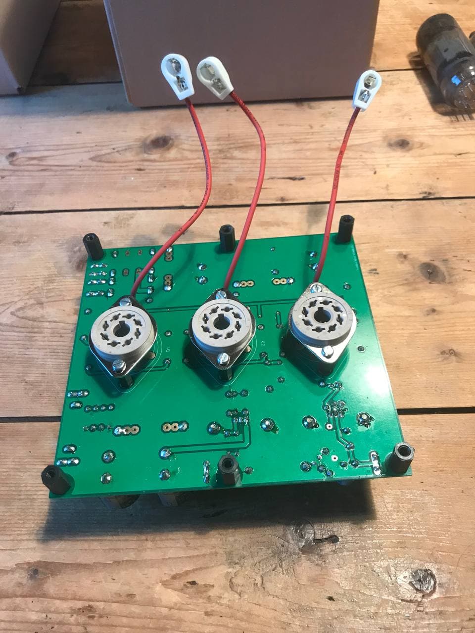

I have once made a similar supply for someone, Triple PL36 maida regulator with TL783. And DC heaters for the PL36.
If you want i can send you Gerbers
