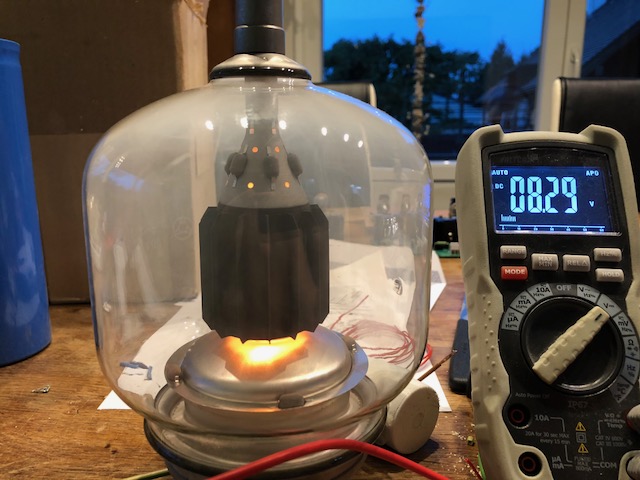

Just wanted to inform that the proposed regulator in Post #5 from Elvee works very well.
It is made up as follows
- bridge rectifier 60A/40V
- SL32-2R005
- Common mode choke 1.3mH/20A
- 300000uF Sprague Powerlytic 36DX
- Elvees's regulator
delivering 8.3V DC with not measurable AC
Unfortunately my GU-46 tube seems to have lost vacuum, it develops smoke inside when heater, something I have never seen in any other tube. Tube will be replaced.

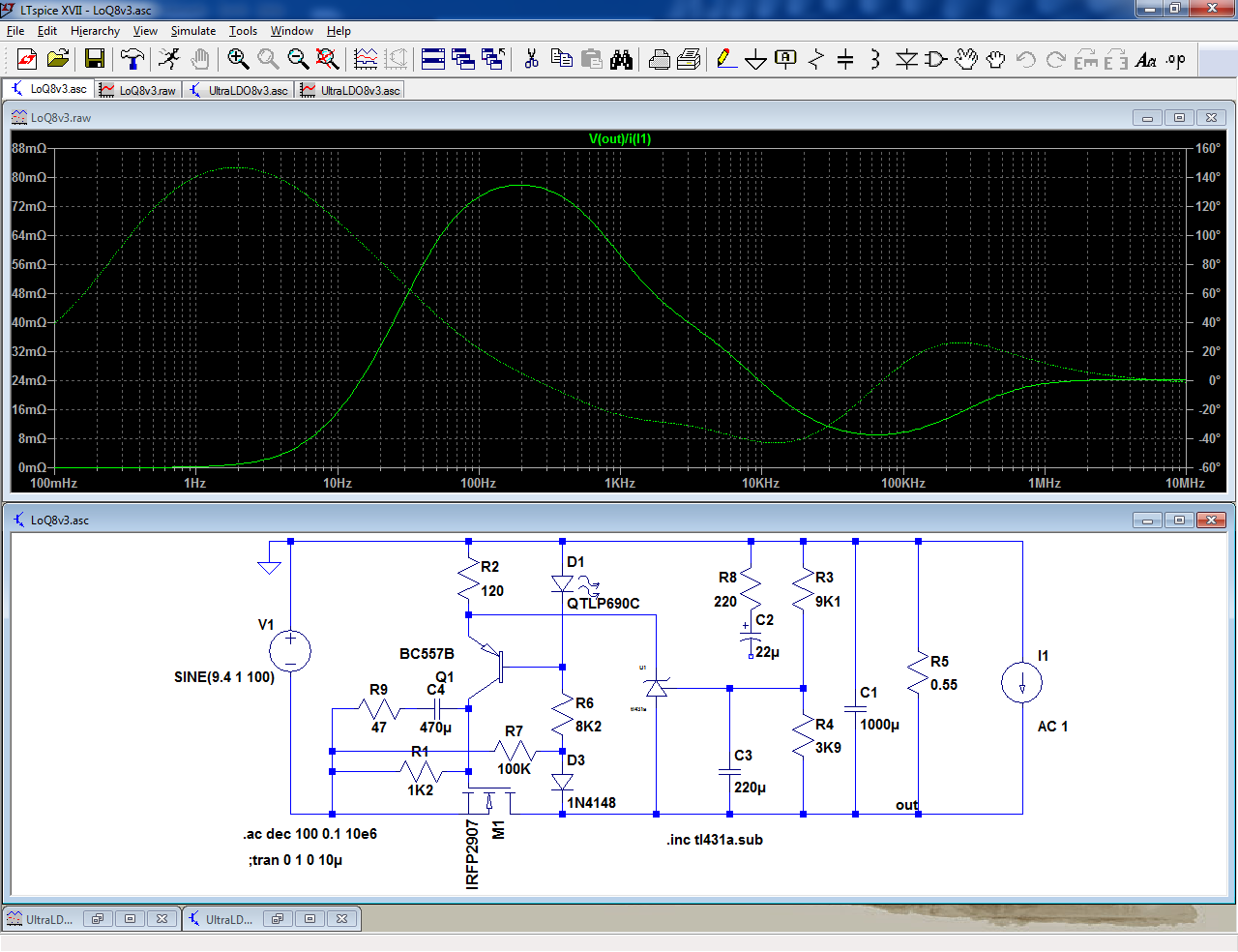

I have attempted to tamper with the LDO, to degrade its output impedance.
The task isn't easy, because the circuit had been designed for exactly the opposite: it is a good and stiff voltage regulator, and every aspect of its topology has been designed with that objective in mind.
This means that it resists stubbornly all watering-down attempts.
In the frequency domain, it is possible to obtain some results, but the mods upset completely the transient operation.
Here is the best I could obtain: for the audio band, the output impedance becomes ~50mΩ.
This may not sound much, until you realize that the initial value was around 6µΩ: in fact, that is an "improvement" (sort of) of 10,000x or 80dB.
To go higher would require an entirely different circuit, with a current-sensing resistor somewhere, which would be problematic given your low voltage margin.
Anyway, the actual effect of such a gimmick is bound to be extremely marginal: it would slightly increase the cathode resistance and alter the repartition of the current over the filament length, and there are probably more important factors to worry about, like the injection of common perturbation through the heater, and the way the actual signal is coupled into the heather/cathode
