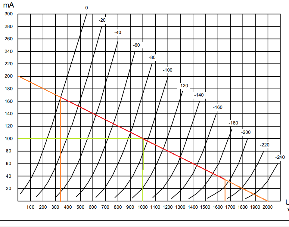

Hi Pat,
You cannot expect high power output with a B+ of 500-600 Vdc on a GM70 and 9.5k primary impedance.
From my recollection, you had a 800V CT capable power transformer. You could increase the voltage by slightly changing from choke input to capacitor input. Use PSUD2 to fine-tune the necessary value.
Here's a 10k loadline, where you can expect ~ 22W into A1 for 100mA bias. You can safely bias these transformers into 100mA, they have flux density headroom and will give you 1.5T @ 25W @ 25Hz
No need to starve the filaments IMHO.
