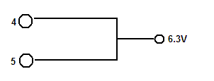

Here is a schematic of my heater setup. It is 6.3V paralled to pin 4 and 5 of a 9-pin tube socket. Would I connect the reference to ground or some other point? I've heard that 20-40V is a better reference with less hum. Any help would be appreciated, as this is one of my last steps to completing my tube preamp. Thanks.

Would I still connect the center tap to the power star ground, or would I just ignore the center tap altogether? Also how would I connect up the heater so it is referenced to 20-40V instead of ground? Thanks.
Ignore the center tap. Also since the 50vrms you have will smooth out to about 70vdc with a bridge rectifier and caps, you may not need regulation. Most tube amps don't use any, but there are a few that do. Depending on your power transformer rating, you may be able to get 6.3v at 350ma, or you may not. A cheap radio shack transformer is also an option for that.

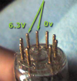

I have been working with wiring up the tube's heater. I have a lab power supply that I have been using to try and test the tube, but when I apply the 6.3V, there is no current being drawn by the heaters. I have the heaters hooked up in parallel and referenced to ground, but it does not seem to want to work. Do I need some kind of resistor divider network to get the current I need, or am I just missing something obvious? Does the tube glow when the heater voltage is applied, or only after the B+ voltage is applied? Any help would be greatly appreciated. Thanks for the help.
Why is the ground reference being connected to one of the tube pins? Shouldn't the ground reference be connected to the channel ground? That could be a reason why it is not working. It seems like something very simple that I should be able to fix. Thanks for the help.
woooooah.. getting ahead of ourselves...
This 0v is not related to your signal ground... it does not even have to be 0V... in all cases... this is purely seen in terms of a dc voltage supply for the heater... being 0v for this low voltage circuit, it is fine... to connect it to your groundstar.
now check those 2 things I said... will take only a few seconds...
