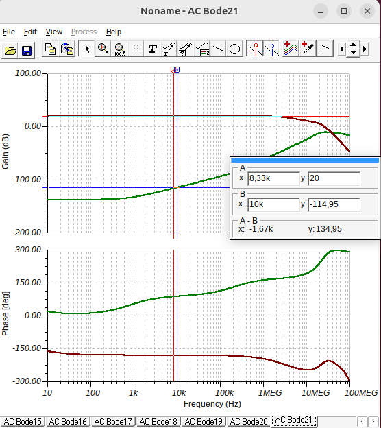

Here is a print screen of a Bode plot from a fast amplifier.Brown is output voltage and green is input voltage to inverting coupled amplifier-
The Bodeplot shows that we have a feedback factor of 115 dB at 10 kHz.
From the fourier transform in the simulator i got input voltage 1,9uv with a distortion of 9,18%. That is equal to a 0,17 uv distortion component of the input signal. 0,17 uv / 1v = 0,17 ppm or 0,000017% distortion. In the real world the amplifier will not measure that good because not identical transistors and problems in the PCB layout. Resistors and capacitors will affect too.
The important thing in this thread is that it is the speed of the amplifier that makes it possible to have such a high feedback factor.
