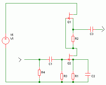

like this?

i really do not feel like beeing the one to teach electronics - i´m a dilletant in thise area.
Its only, i had the same thoughts about resistor I/V conversion with low resistor value and amplifier to get usefull voltage level out of the DAC.
I did not test the circuit in real world, but ordered some jfets to play with.
The DACs current output should be represented by the AC source shown "AC sine 1 0 .... " with the 1k resistor behind. Out of this resistor comes something like AC current ~ 1mA p-p, what is our DACs output for simulation.
This current is flowing through R4 to GND (or whatever voltage level the DAC likes) and makes an AC voltage across R4 which is AC coupled with C1 in an voltage amplifier formed by the 2 Jfets. C3 couples out the C portion of voltage that appears at Q1 source were i hope to find some voltage swing and lowest output impedance. R5 represents the next amplifier stages input impedance (preamp or buffer stage) and "probe 1 - Node" shows the amplified voltage swing. Its around +-2 V with the 47k at R6.
Function of the amplifier you will see when thinking about how the Jfet works: it is open with difference between gate and source = 0 and closes with gate going more negative than source, closed at some transistor dependend voltage like 2 Volts or so. (see diyopamp at passdiy) The voltage difference is the voltage across the resistor between gate and source, and this difference is caused by the current through the resistors.
Jfet choosen with hope for low noise. Circuit choosen for beeing simple low parts count and without feedback loop.
I don´t know if it will work, if it will be good or crap. Some more experienced members will comment on this... Also i hope they will correct mistakes i made in circuit and explanations.
Hi Till
I very much appreciate you taking the time to explain this to me🙂 .
I will now endeavor to broaden my own knowledge of these things, as I find the idea of a minimalist discreet iv stage that is
dac friendly rather appealing.
my initial consideration was to use a dual op package to create
a multi gain stage for the tiny v that would be present at a low
value IV resistor.
This would not necessarily be as compact as something along the lines of your circuit though.
