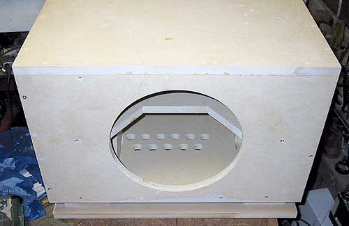

Sounds like an interesting idea, but 1. I have no idea how to tune it properly and 2. I don't really understand how aperiodic boxes work (those are in the wrong order, but you probably get my meaning).
Putting more electronics in the path is something I understand better than aperiodic enclosures. My soldering is better than my carpentry.
Glenn.
Aperiodic is still much a try & try method... basically you add some leaks to the sealed box -- i've found the thing slots as in the Dynacos http://www.t-linespeakers.org/classics/dynaco.html the easiest to work with, but an array off holes (as in attachment) works too. You then makle these leaks resistive by blocking them with open cel foam, compressed fiberglass or such. You vary the resistance until you get the flattest impedance curve (or use GMs click test -- i think he mentions it on the forum, not having used it i can't remember. I've also gotten pretty close tuning by ear (the one pictured needed more resistance than i expected (ie i started with too many holes) it was a good thing it had the raised base for me to sqaush a mass of foam & fiberglass up against the bottom. It all worked out in the end, with 2 Philips 12" working well in a box size more suited for 1.
dave
