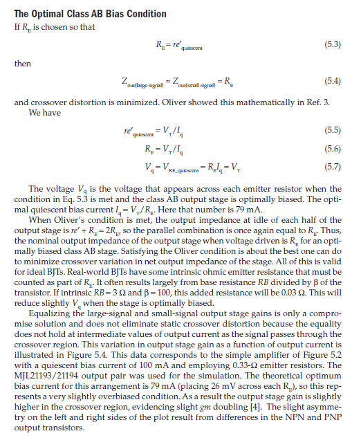

@sgrossklass: While I agree with the rest of your post, I disagree with: "In an AB amp with BJT outputs, adding emitter resistors actually worsens crossover distortion".
Using your argument about the amplifier output impedance, the output impedance with no RE and I_OUT = 0 is re/2. When I_OUT is large, output impedance approaches 0. Therefore, it is impossible to get a flat output impedance without RE.
When you have RE, when I_OUT = 0, R_OUT is (RE + re)/2. When I_OUT is large, output impedance approaches RE. Therefore, the optimum bias is when re = RE (Rout = RE at I_OUT=0 and ~RE when I_OUT is large). I agree that it is not possible to achieve this at all temperatures, actually, you can only do this at 1 temperature unless the output devices are biased PTAT (which as I write this, I am thinking why we actually don't do this.) But, this biasing condition achieves maximum flatness. I also agree that this is not a cure, but it is definitely better than RE=0. This was first published by a guy named Oliver. Attached is an excerpt from Cordell's book where he talks about this.
