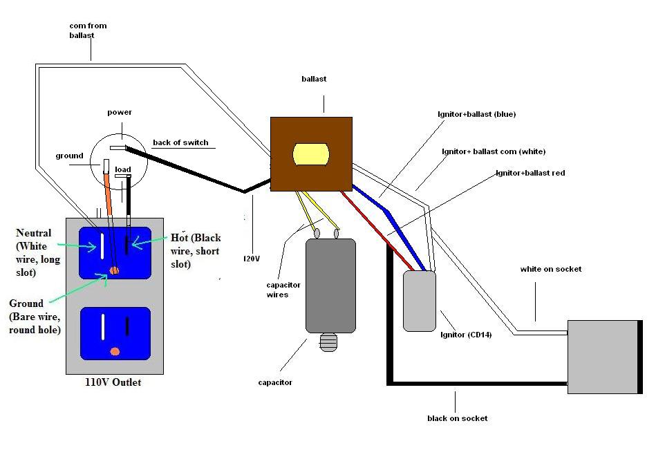

Any Help on wiring this thing ballast would be great, My AIM is Nirvanakid17m 🙂
1. I have my 120v wire connected to black in the outlet, and the one common to the white.
There was an extra common but i just placed a wire nut on it.
I also put nuts on all the extra volt wires (seperate).
2.The capacitor: I connect one cap wire from the ballast to one side the of capacitor.
The other cap wire I connect to the other side of the capacitor. Thats it.
3.Ignitor?? (CD14): The red wire coming from the ignitor is plugged into the the red of the ballast.
The blue is connected to the blue of the ballast. The white is connected to the Common wire of the outlet
along with the ballast common.
4. Mogul Socket: The hot is connected to the red ballast and red ignitor. The common is connected to the same ballast
and ignitor common.
if you need me to i can draw a pic to help lemme know

got my mogel base today and wired up my balast fired it up and it workes great after about 1 min it started geting bright lit up 2 rooms in just that time. then i unpluged it with satasfaction

Right now I'm in a little perdicement, what would I do if I wanted to wire that up using a switch?
The Switch I have has Power, Load, and Ground Pins in the back, Any Ideas?
Btw, that drawing was PERFECT, it made me feel so much better!

im not sure about switches i dont have one only switch im using is light switch (on,off). cool im glad my artistic abilitys are good for something. it makes it 100X easyer to connect it all up
Yeah thanks so much skull! it made it so much nicer! I'm still afraid to plug it in w/out a switch for some reason though, I'm anxious to fire it up!

that looks like the same as a reg togel switch. i could be wrong but it looks to me you would run your 120v to the power then a wire from load to the wall outlet and a ground from wall to ground
So the Ground would be the White on the Diagram, and the Power the Black?

no the ground would be the round hole on the wall. the white on the ballast is the com or nutral. there is no ground on the ballast.
Awesome! That totally makes sense to me! I'll fire it up when I get home from work this afternoon! Woohoo! Thank you!
arg, tried it three seprate times, I couldnt even get the switch to turn on, I'm positive I wired that stuff right and the switch is brand new, any suggestions?
LoL the light Mogul was set to off 🙁
I wired it w/ a standard cable, and it worked fine, At first it was a little dim, but it kept getting brighter and brighter, Holy Crap it was so bright!
