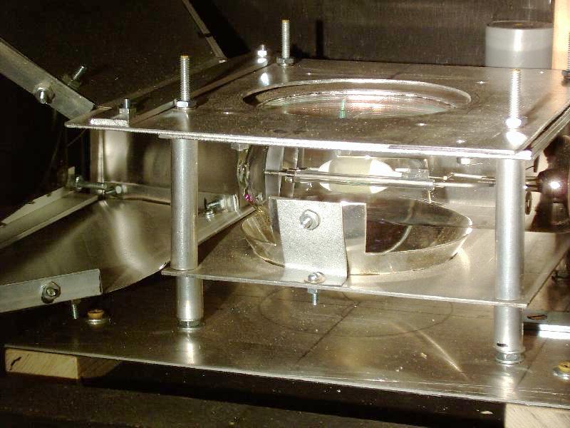

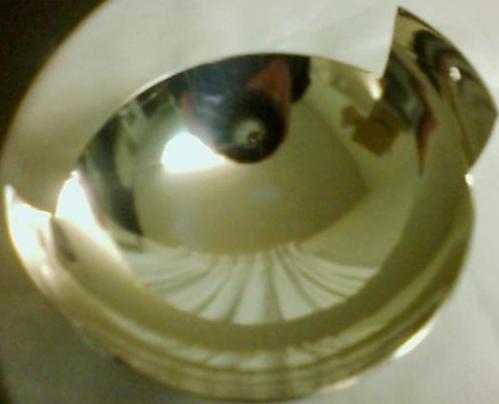

I don't think a soup ladle is big enough for a Ushio Retrofit lamp. (I tried.) I am using a stainless steel hemispherical quiche mold, that is about 4 inches in diameter. I cut away some of the edge part with a Dremel running thin cutting disks, so I could get the center of the lamp arc to the center of curvature. Works pretty well.

A quiche mold is a stainless steel mold used for making half-sphere-shaped baked items. I bought mine from a culinary supply place over the internet. (They have multiple sizes, so you can pick one to fit your lamp.) It has a perfect half-spherical shape with no flat spot on the bottom, so it makes a good reflector if you get it with a polished surface. I improved the reflectivity of mine even more by having it silver-plated.
Here is a picture of it after I cut off some the upper part, and had it plated. And another picture of it in place within my light box. (The front of the light box is removed so you can see inside.)

but how did you cut the edge off with a dremel keeping it straight? did you build yourself a jig or something?
i cut my computer cases for modification alot with my dremel and using same discs but never stainless steel which is very dense...
