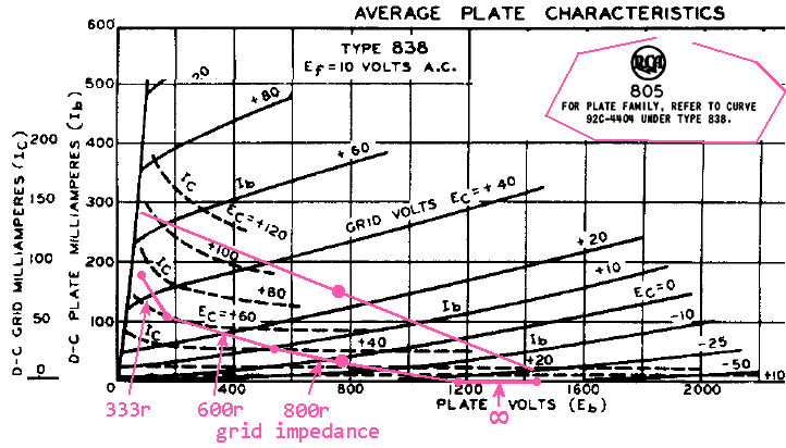

What about an 805 you can get 45 to 50 watts with 750 to 800 volts single ended??
Need a big hammer.
750V and 45W out suggests 113W dissipation or 0.15A current. The idle point is well up in the positive grid region. The grid impedance is 800 Ohms around the idle point, *varying* from 333r to infinity as you approach full output. Peak grid power is near 70V and 90mA or 6.3 Watts. For low distortion, driver output impedance should be <300r. The high and varying grid current means R-C coupling is no good.
A 6L6 (maybe 2A3) with ~~5K:600 interstage transformer may do OK.
Cathode follower, SE class A, is another option; needs 6L6 6550 8417 or maybe 2A3.
