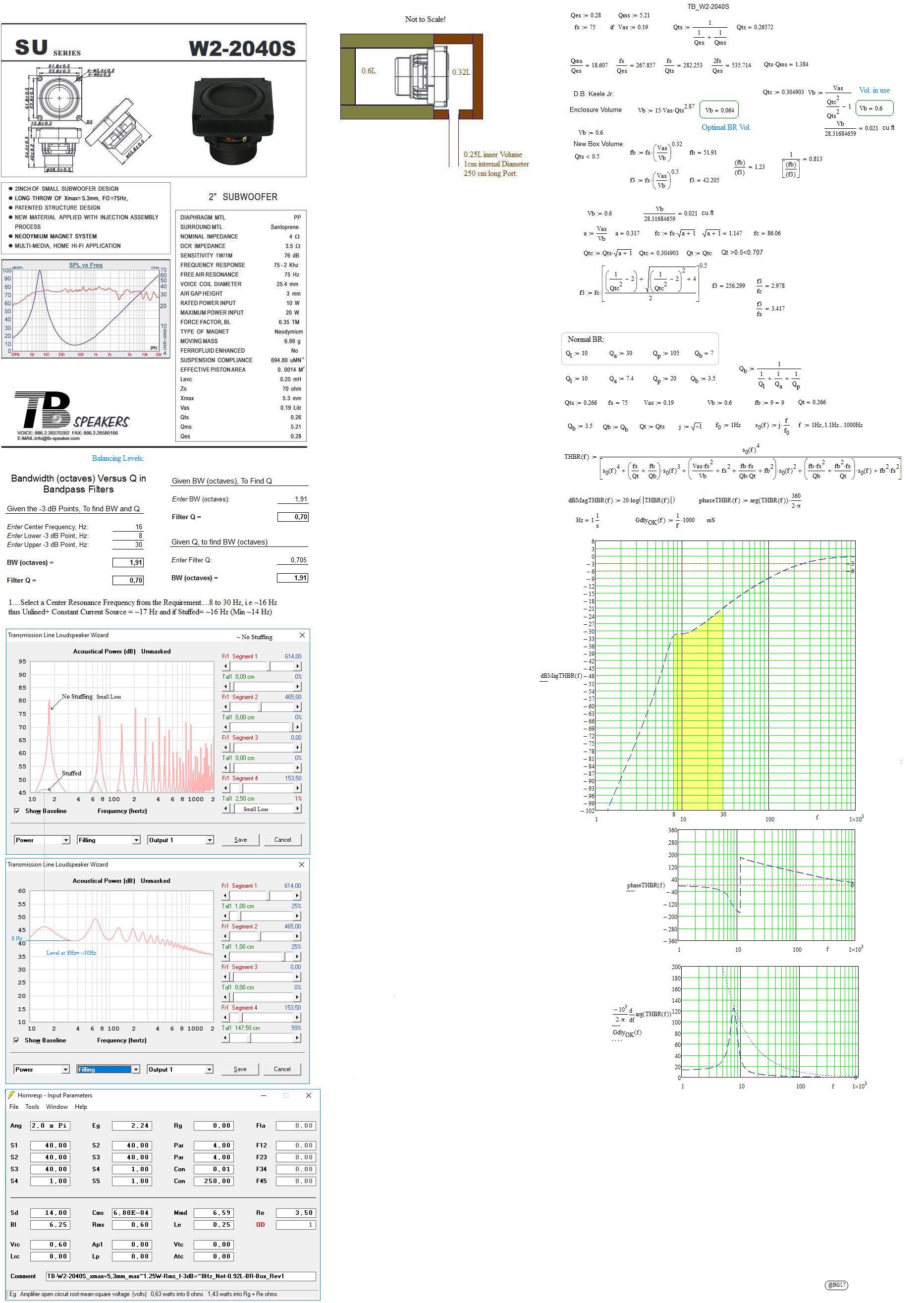

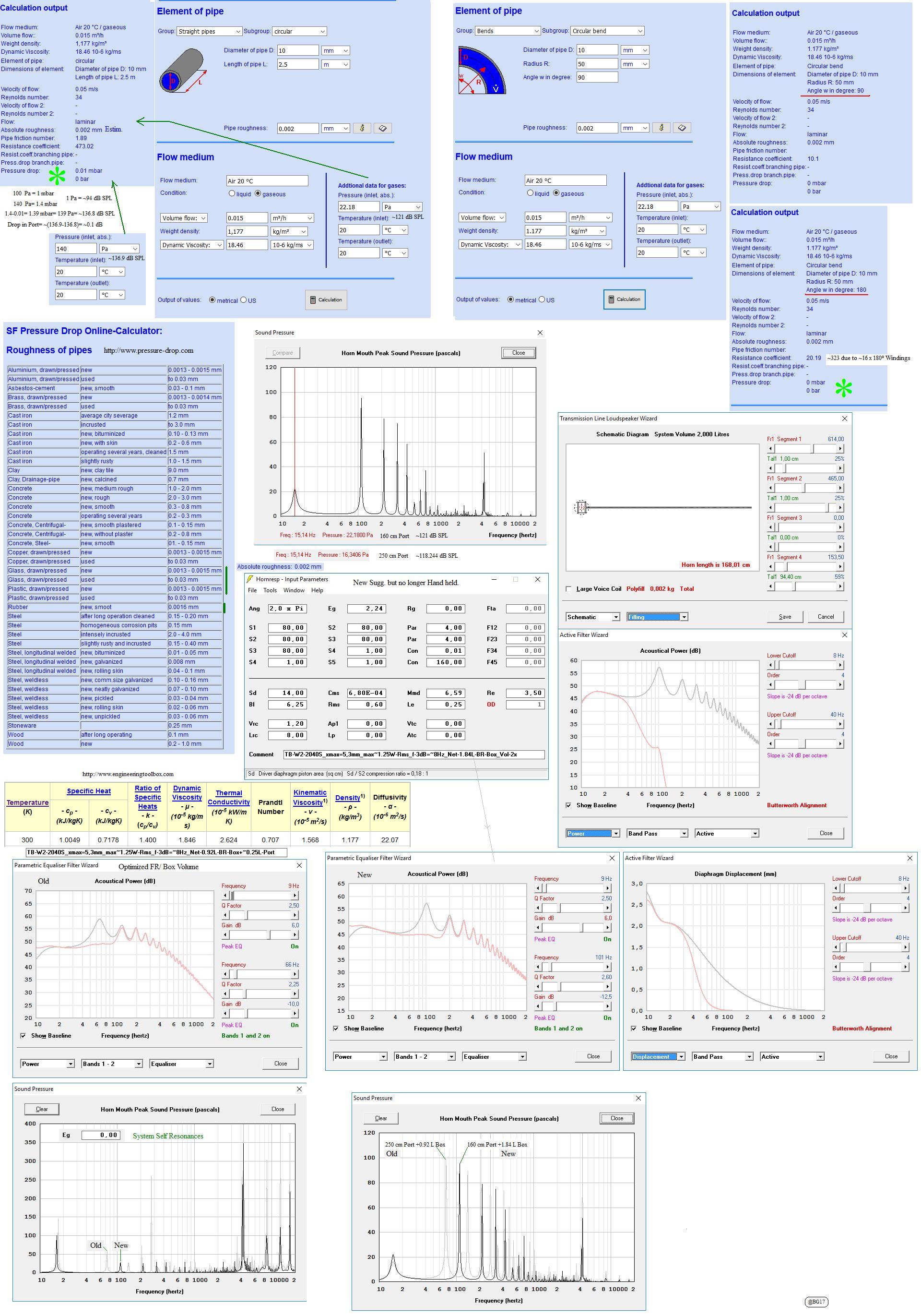

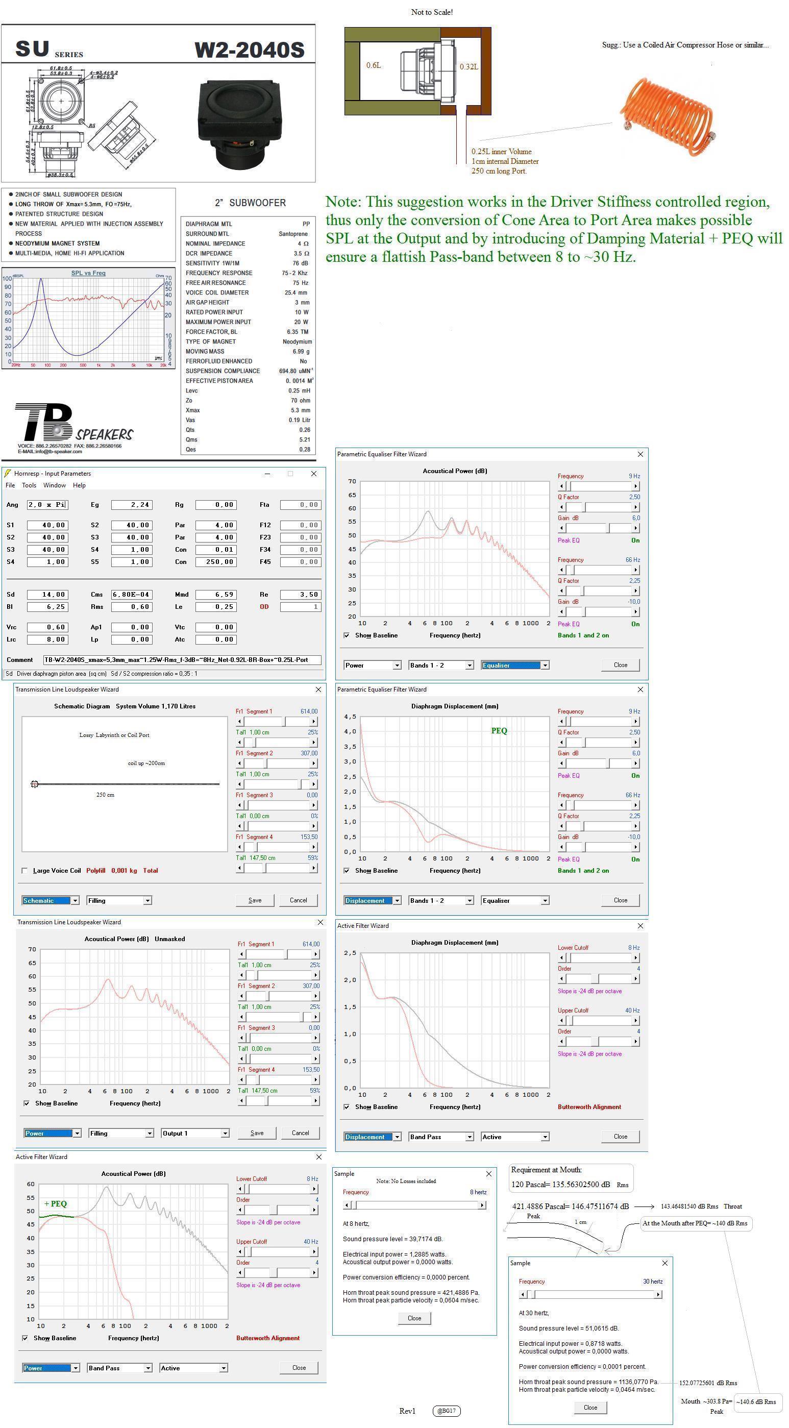

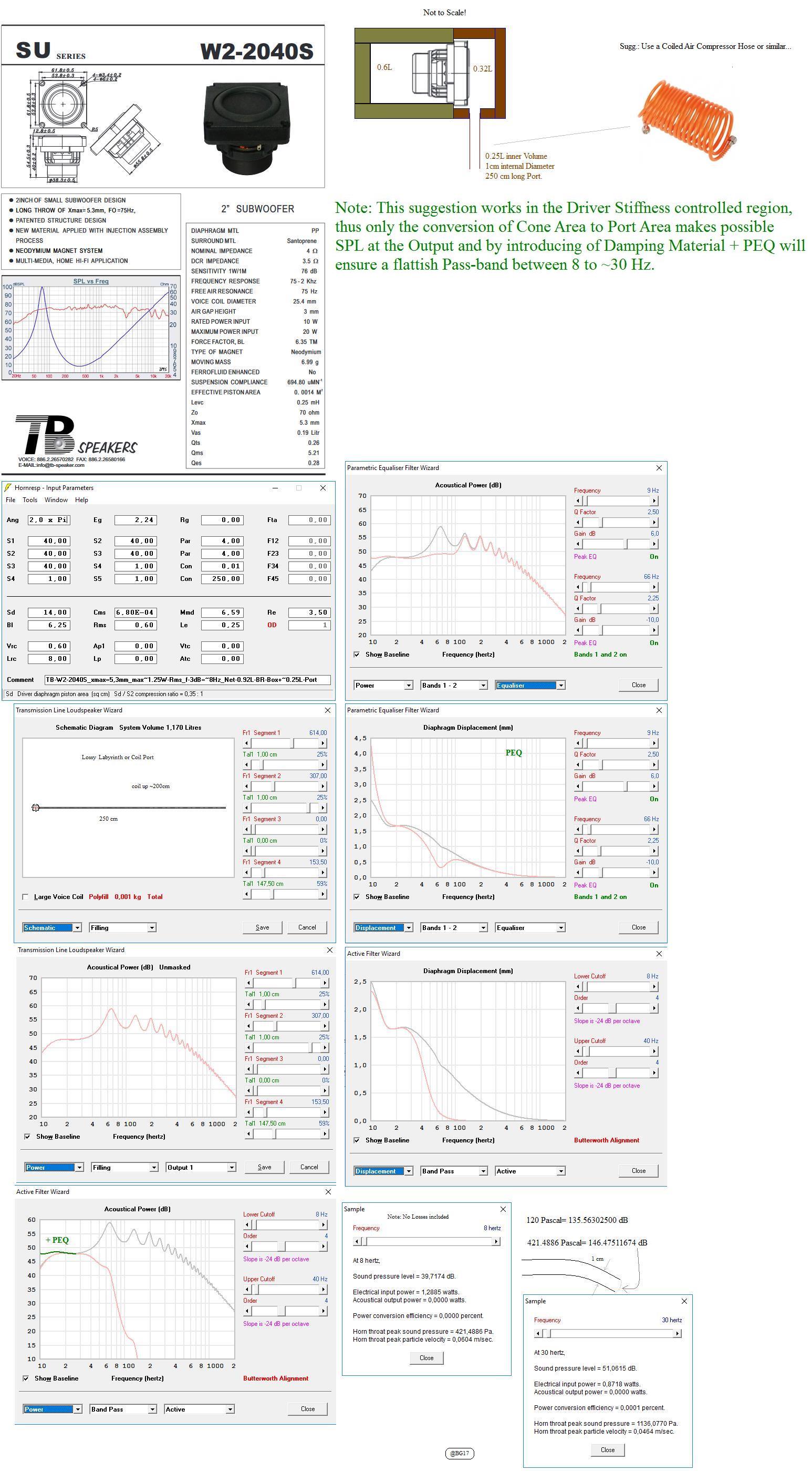

Hi Milachka,
Your Mail:
You propose a tube of 250 cm. Should I use a shorter tube, would I then have to increase the volume of the chamber on the right for the same volume?
Of course a possibility but the Design is no more Hand held and Resonance optimized...See the Pictures:
I don't think I understand exactly the dB calculations at the bottom of the sheet. First of all, I'd like to clarify that I am looking at 120 Pa to be the RMS of the pressure, not the peak. Was that also your assumption?
See the Pictures:
Does the length (within reason of course) of the tube matter very much if the material is stiff enough?
No, as the Design is sort of a Helmholtz... See the Pictures
You convert 120 Pa to 135 dB, but what is the 421 Pa you mention? I see that value again in the 6 Hz calculation, yet not in the 30 Hz calculation.
My mistake: 421 Pa is the Throat Pressure, not at the Mouth where it should be ~140 dB...See the Pictures.

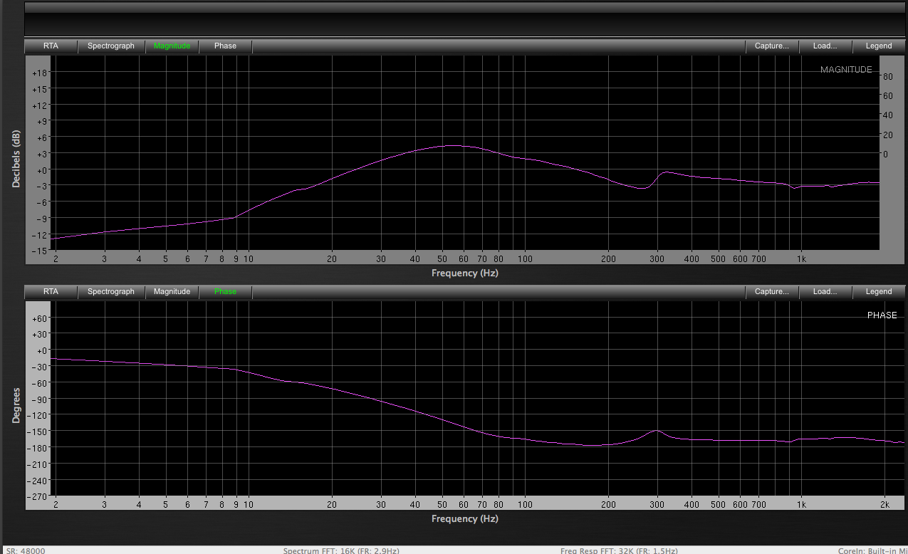

The Vibralung Acoustical Percussor probably uses a decent headphone transducer- considering there are nowDr. Dre knockoffs available for $15 that I can easily hear from 30+ feet away powered with 200 milliwatts or less while the users are causing permanent hearing damage, price is not a concern.
I personally have been a big fan of Sony MD7506, and the predecessor, the V6 for the last 30 years or so- the MD7506 is nearly flat to 5 Hz, and connected to a tube you have virtually no inverse distance loss- recall the "speaking tubes" used for communication onnaval vessels prior to any electrical transducers, or the 200 feet of plastic tubing connected to a Sure SM57 as both a transducer and receiver for a 200+ ms delay back in the days of iron men, analog consoles and wooden speaker cabinets.
I have been recently "upgraded", and now have some titanium "gussets" in my cranium after an altercation with a gang-banger neighbor, but I digress- here is the response of a Sony MD7506, no processing, measured with the microphone flush with the ear cup.
Note that as well as the magnitude response being quite flat, the pase response is also quite linear- what goes in is what comes out (other than in the HF regioin, where the differences in individual pinna (as distinctive as fingerprints) insure that no two people hear headphones (or anything else)the same as anyone else.
