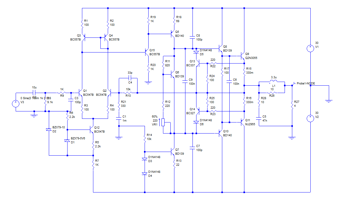

I ran the circuit through LTspice and it does look as good as any Blameless. Does the design scale up for higher supply voltages and output power?
Mike made a survey for for the prefered value of amp power, it leads him to adopt 30 W for his project. I think he mentions the possibility of a 100 V DC power supply somewhere. For a very powerful amp, for a sub for instance, he advices using more usual architecture.
Hi Marian
Here's my two pennorth. This amp may seem a little more expensive with 15 transistors but they are all low cost. The small signal ones are BC547/BC557; the protection transistors are current-limiting only (I've not optimised this) and have to carry more current than the small signal so they're BC337/BC327 but could be 547 /557 if you can't get them; the rest are BD139/BD140's and the output 2N3055/MJ2955 pair.
The circuit is essentially a Blameless architecture: differential input, with a decent current source; current mirror which is now standard; a Darlington VAS which has a low emitter resistor (because the VAS current is higher than normal at 25 mA or so); a current source for the VAS; and fully complementary output.
Frequency compensation is my recommended approach: no Miller capacitor, but local "sprog stoppers"; global compensation across the feedback resistor; and an input capacitor to keep the input stage drive impedance low, mainly, for stability.
Simulated distortion is .01% at 60W into 4 ohms and .02% at 20 kHz. It is this performance at high frequencies which demonstrates the better compensation scheme.
Distortion is quite high mainly because of the 4 ohm load. If you run this from 20 to 25V rails at 30W, it will be lower.
The VAS current is high because of the high drive needed by the output transistors. I would recommend the MJ21193/4 but if you can't get those, 2N3055's are OK but need a bit more "push". A compromise would be to use two pairs of 2N3055/MJ2955 in parallel, but that is probably not necessary if you keep the power to 30W.

I'm running mine on the original Dynaco transformer, which results in about 72Vdc after rectification/filtering. I haven't measured, but perhaps 40 WPC?
