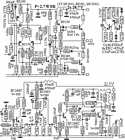

Low power amplifier P8W4R- detail clear sound
[SIZE=-0][SIZE=-0]Low power amplifier P8W4R- detail clear sound, is possible only for low power.[/SIZE][/SIZE]

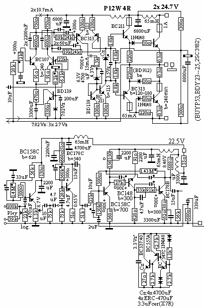

Money is not everything. I am surprised for the audio censorship of information and lack of interest by good diagrams electronic amplifiers that are as unique and good. I gave another similar scheme.
Re😛8W4R
For a clean amplifier power transistors must be exactly as reinforcement in the diagram, the load output of the amplifier must be accurate, the type of transistor BC313/211 French or Polish product, Parameters for BC313/211 - Ic = (Ico = 4.5mA + Id = 20mAp) = 24.5 --- 27mA max, parameters for 2SC3182 - Ic = 2Ap/Ro = 4R / b = 240 min.
